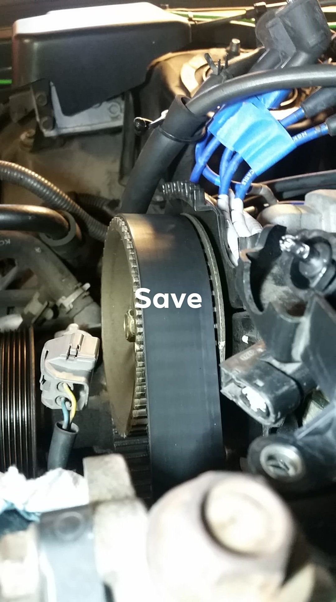

Default Timing marks @ tdc

Maybe test the ignitors? Assuming sluggish acceleration maybe due to lack of fuel, air, timing. Doesn't appear like your timing belt is worn.

Thanks for the reply -- I really appreciate any help I can get. Do you mean test the igniters or the ignition coils? I've got power going to all 8 plug wires (verified with a spark tester) so I thought I could rule out the igniters. Is there a test for the igniters specifically? The ignition coils are new and have been swapped out several times with no change.
On the pictures of the timing marks on the cams -- do they seem slightly off? Is it possible that my timing belt tensioner is failing and not taking up all the slack in the belt and allowing the cams to shift slightly advanced of the crank? The car runs pretty smoothly just doesn't have any power - especially on the low end.
