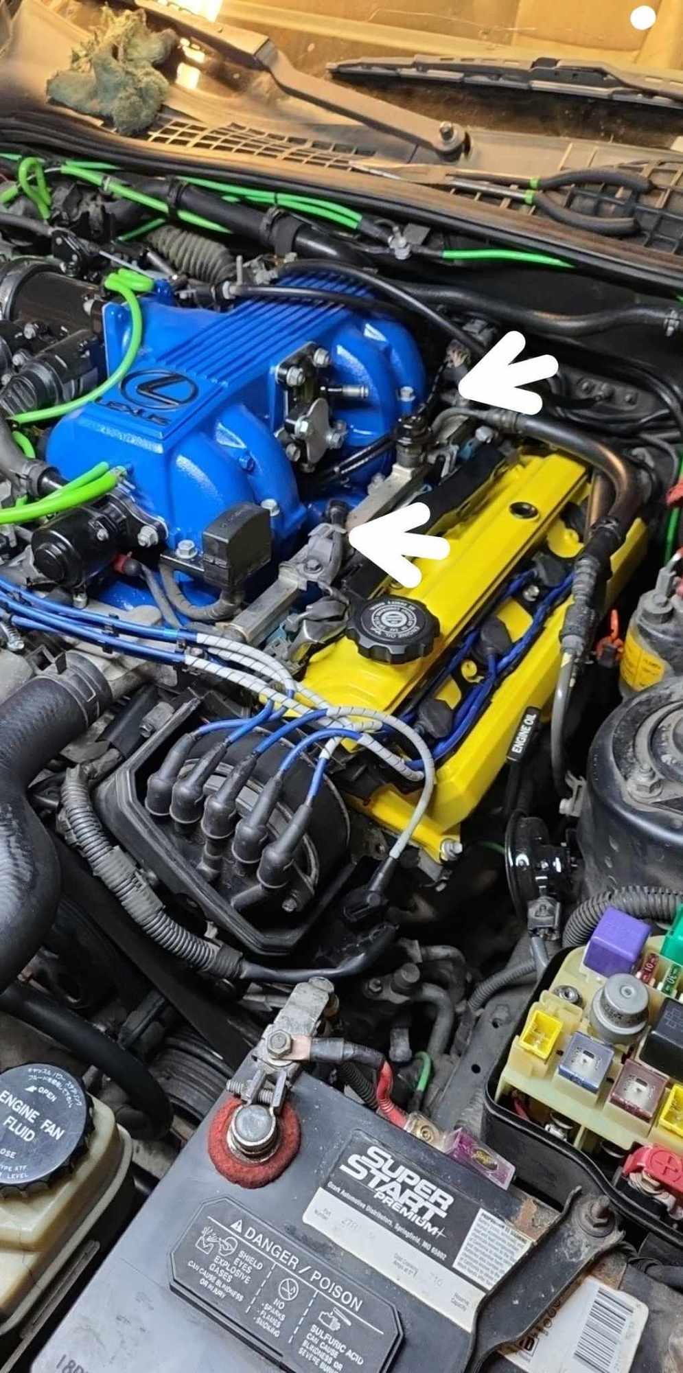

I made my own knock sensor harness out of some coaxial TV wire and swapped it in. I tapped into the factory harness at the plug near the firewall. So far the knock sensor code is gone but no improvement to performance. I also deleted the fuel pressure vsv.
