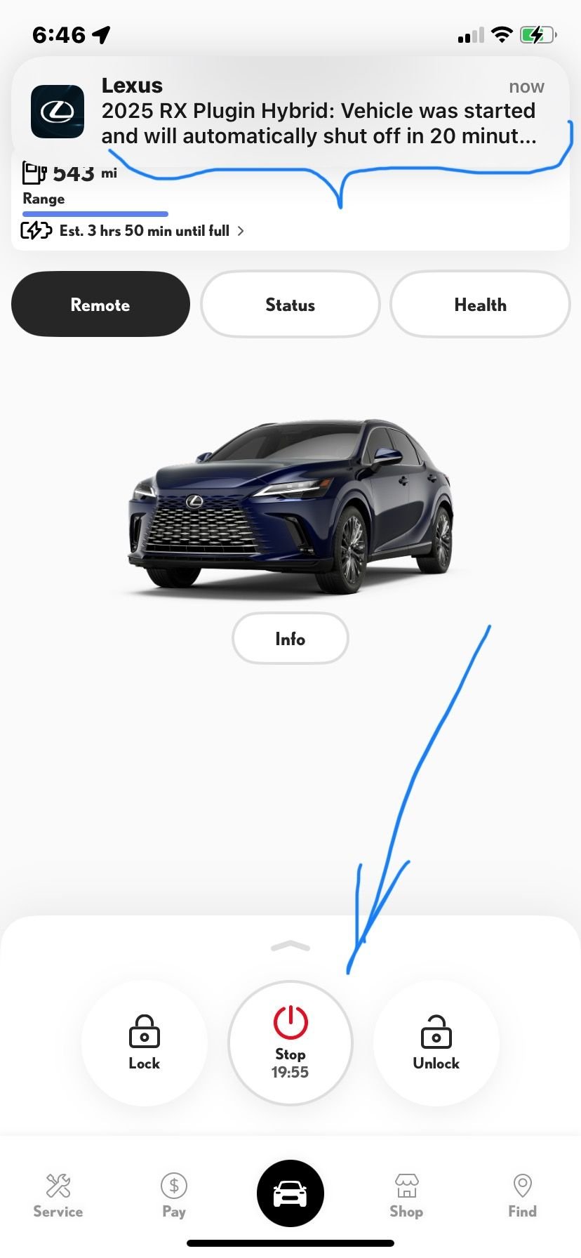

How could you change to 20 minutes? Mine only 10.

Default Climate Programming
@hoangdeptrai I’m not really sure how it got set to 20 minutes. Here’s a she said/he said about how it “maybe” got set to 20 minutes. I remember my wife looking at the climate part of the remote start part of the app and her saying “it’s nearly at the end of the 10 minutes, it’s asking if I want another 10 minutes. I’ll tap yes”
Of course she doesn’t remember this dialogue. Maybe look at the countdown timer near the end of the 10 minutes and see if you get a dialogue bubble with something like this.
Here’s a screenshot of the app showing 20 minutes warm up time. Sorry I don’t have a better answer for you.

No sure is the Hybrid differs from the ICE Rx350 in the remote start abilities, but mine (ICE) will only do 10min with the ability to do a second 10min after the first 10min expires. I have watched it wind down to 0 and I'm never asked to keep it going for another 10min. Perhaps there is a setting in the app, but I have looked pretty thoroughly and I see no option to choose 10 or 20min.
