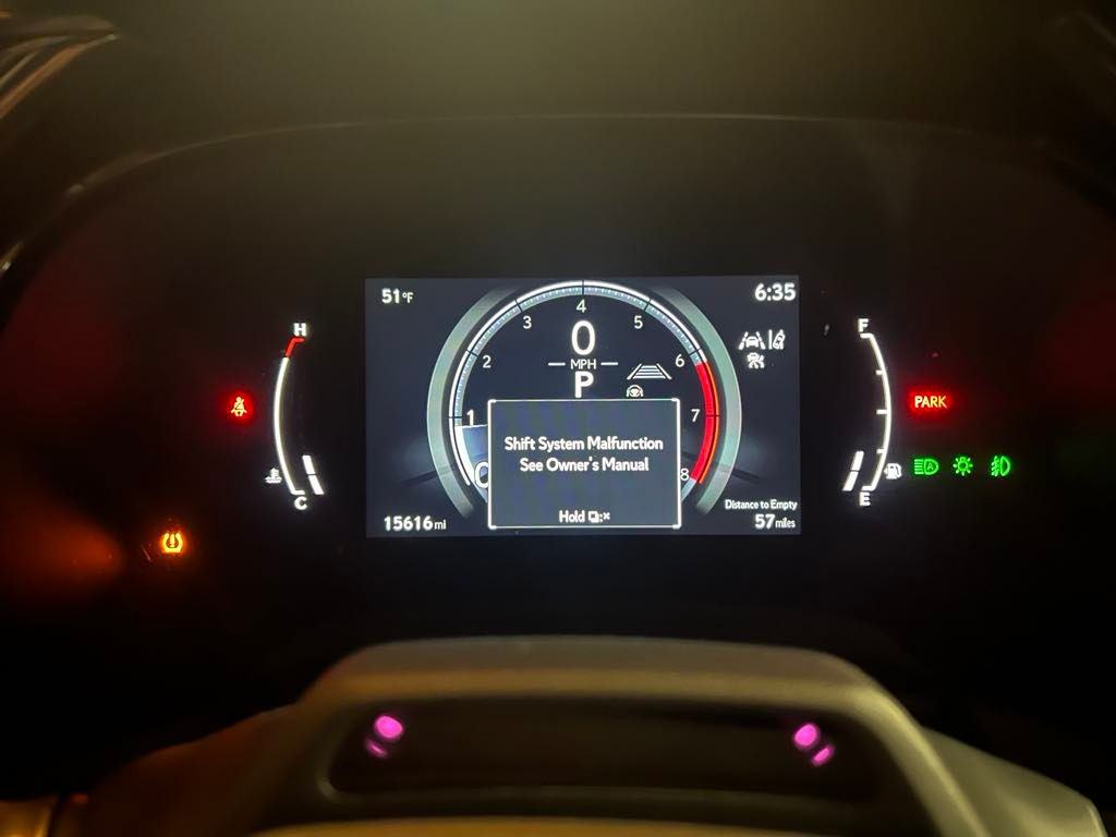

Default Shift System Malfunction
Hi,
new owner here, got 2023 Lexus RX350 Luxury pkg. Car is randomly displaying "Shift System Malfunction See Owner's Manual" message.
I have seen this message numerous times, typically, when I start car for first time this day. Message will disappear if car is shut off and restarted.
I own an Autel ms906ts scanner, that will scan all modules. No codes are stored when this message is displayed.
Anybody had this message and any luck getting dealer to fix it? I see a TSB for NX for similar issue, but it references specific codes, while I see none.
Eventually it will go to the dealer, but I don't want to deal with their antics of "we see no problem sir", come again soon.
Any help appreciated.
