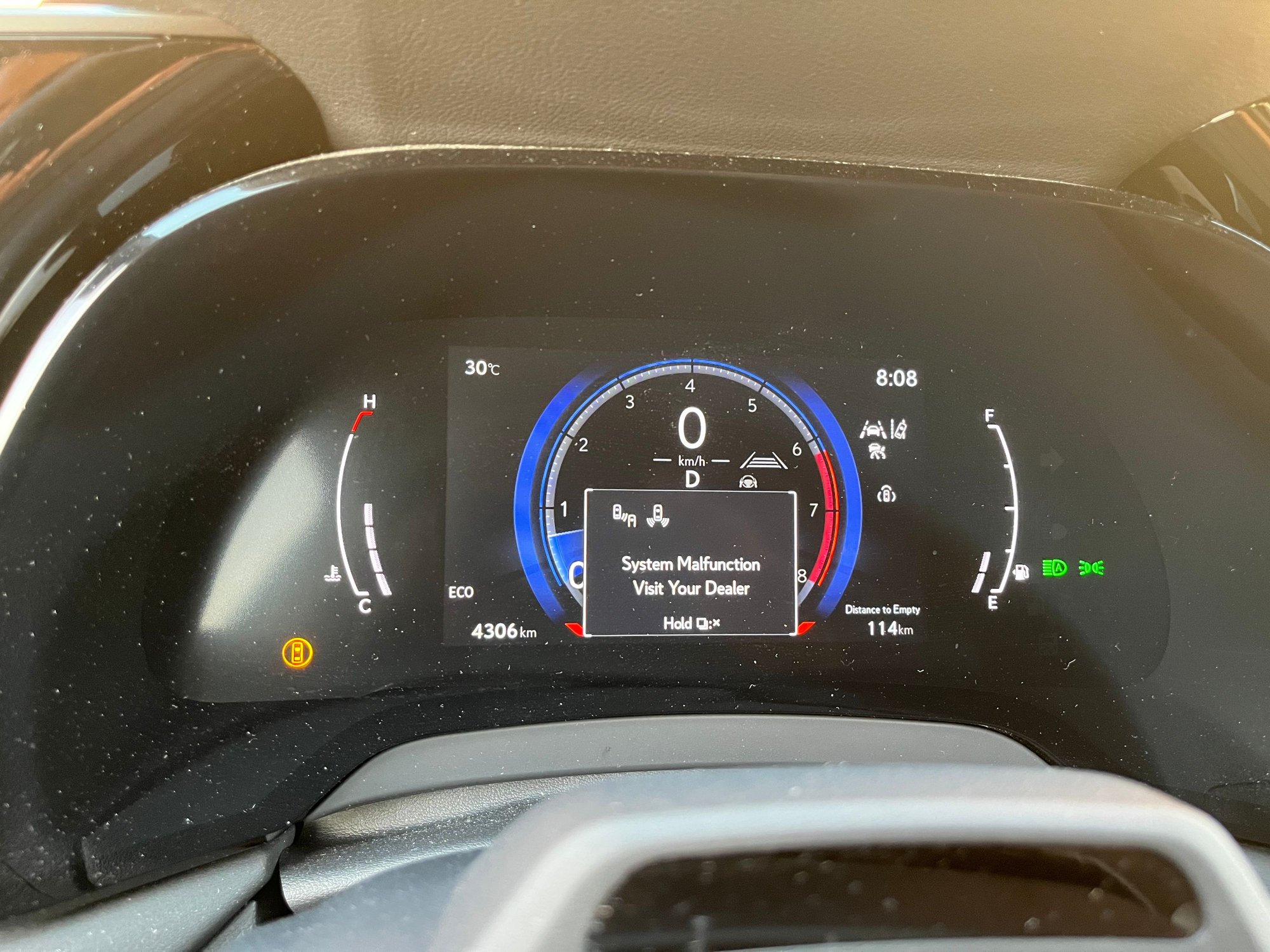

I have similar issue with my Lexus RX350. Frequent appearance of system malfunction during engine stop/start. BSM and emergency brake stops working. Visited dealer 5 times. Battery changed and less frequent now. But the issue observed when battery voltage is very low. Which is sign of electrical issue or weak battery for this engine to start. No solution from lexus. I hate this car from; from the first day brand new had problematic front strut assembly and replaced after 3 months. Now this issue which was there from beginning. Now at 4000km still persists. Every month I visited dealer two times. Nothing!

A new battery didn't fix it? I am surprised. What's being described here in indicative of a weak battery - all these electronic systems can't actually be going bad at the same time, it's the battery. I assume this car has an AGM? It's either the battery, or the alternator charging software for it.

UPDATE: Dealer had the car for 2 weeks, during the first few days I was told there was lots of comms between the dealership and corporate - but no fix yet. Today's update is that the issue is a cams timing issue/poss engine issue. Moments later, received the word that parts are on order: cam gear; bolt and oil control valve/solenoid. Stay tuned...

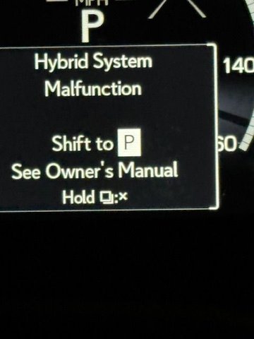

I've had my 500H for about 4 weeks now and as a Traveling Nurse have been averaging 1K miles weekly and absolutely loving it. This was my first Lexus and my main concerns were reliability....but it definitely helped having the F Sport package bc it looks and drives like a beast and spending 12-16 hrs daily in the car its like my 2nd home. Had my Suntek PPF full front, tints and Ceramic to the car as well.. $4K later i was living my best life and feeling good. Got my first oil change at 2200 miles just to be safe. Life was very good!
Last night while i was out for a quick errand....while driving at about 40 mph the entire drivers display lit up with what seemed like 100 alerts/lights. Mostly saying "Hybrid System Malfunction" and "Steering power loss" and the check engine light. The steering became very stiff and the accelerator got hard to press down. I immediately pulled over and sat there for a few just reading and taking pics. I then turned the engine off and waited another few mins....hoping this was a fluke,.
But when i restarted the engine all the lights came back on telling me to take the car to the dealer ASAP. This was 10p at night. i went home and made an appt at Lexus dealer for 7a the next am. I then reconsidered and called the next morning Lexus roadside assistance thinking better to let them tow it in then me driving. Considering the storms we were having i give Lexus much credit as they showed up for the tow 90 mins after i called. Its now been about 6 hours since they had my car and i just got told it going to "take some time to examine and find problem so i can come in and get my loaner".
I am a little disappointed bc for $70K i purposely got a Lexus to avoid these types of problems i had had with GMC, Dodge etc over the last decade. I loive Nursing and i love driving for a living but when car problems start it makes me regret it all!!
To switch all my supplies out of my car to a loaner is a pain. But, Im going to stay positive that this can all work out fine....even after reading some other posts with similar probs. IDK if this is just the 500h F Spo
rts or what?
