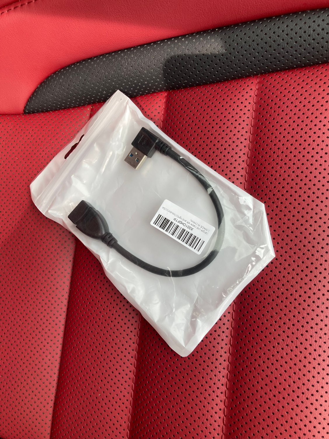

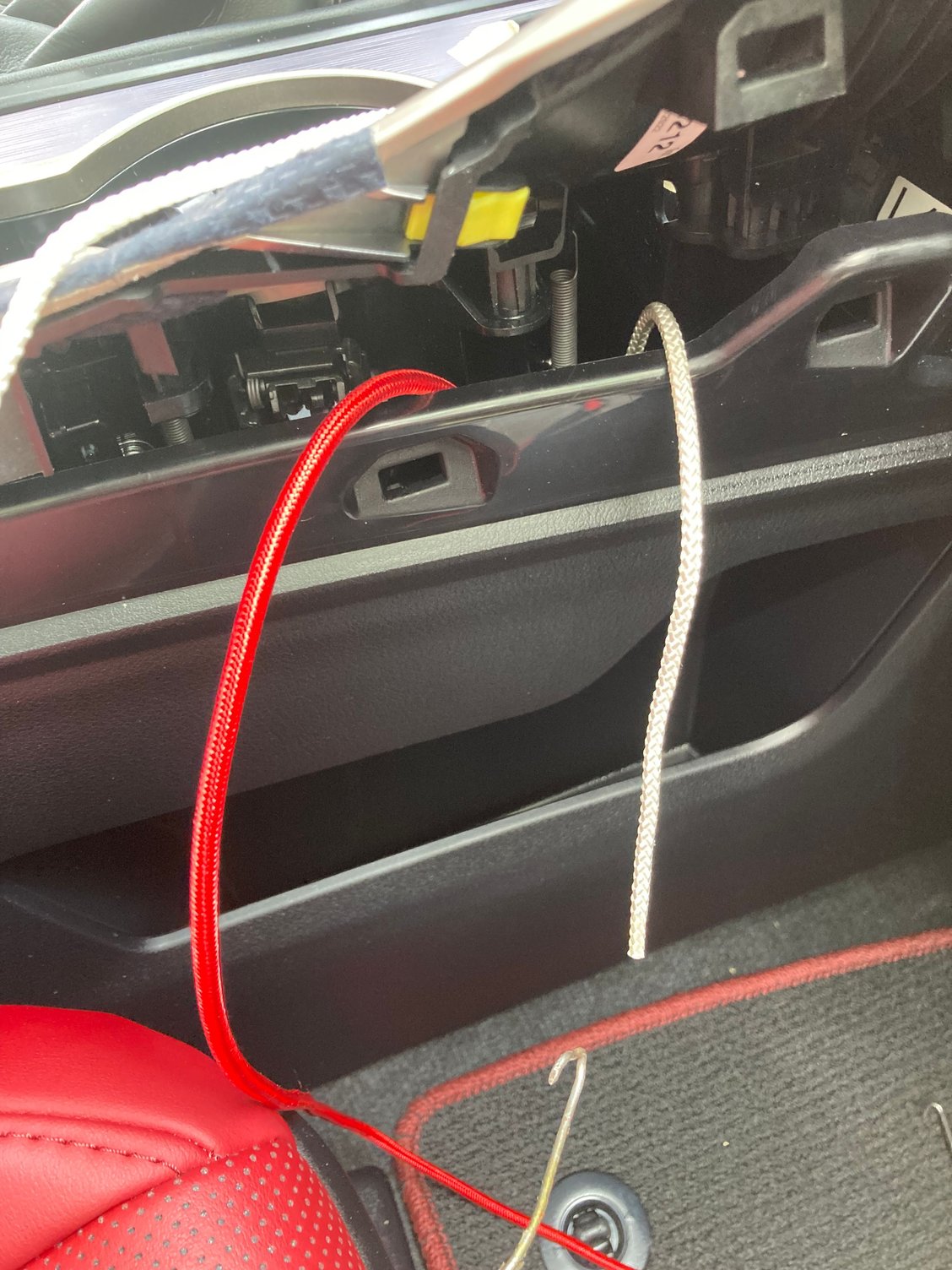

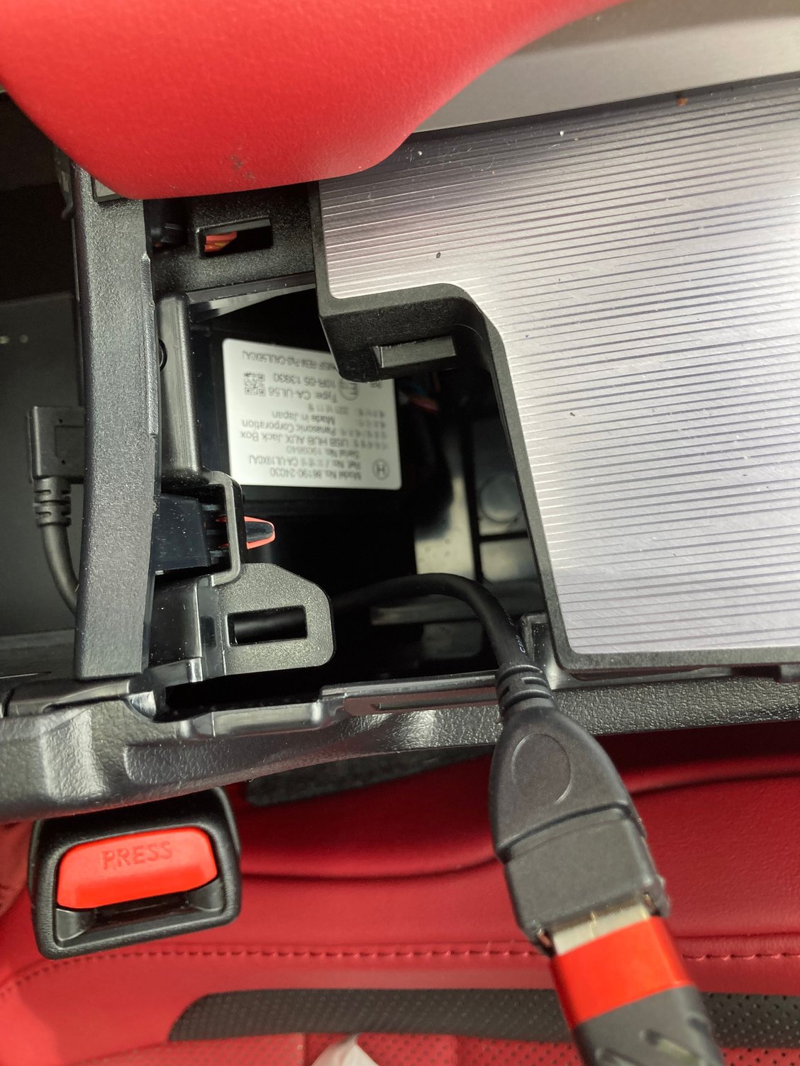

Hi. New owner. Just brought home a ‘22 f sport Thursday. Very ocd. When I realized I needed to have a cable running from my console to my phone for CarPlay I decided no way. I like things clean and I figured I’d run the cable through the console and up into the bottom of the phone pocket. First let me apologize for not being savvy enough to comment, add the related pic one at a time. Narrative then pics to follow.
First I purchased a right angle usb cable from Amazon. I will add a link.

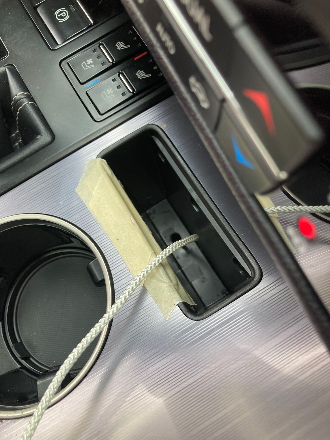

Removed passenger side knee bolster and popped out the little panel the usb plugs are in.

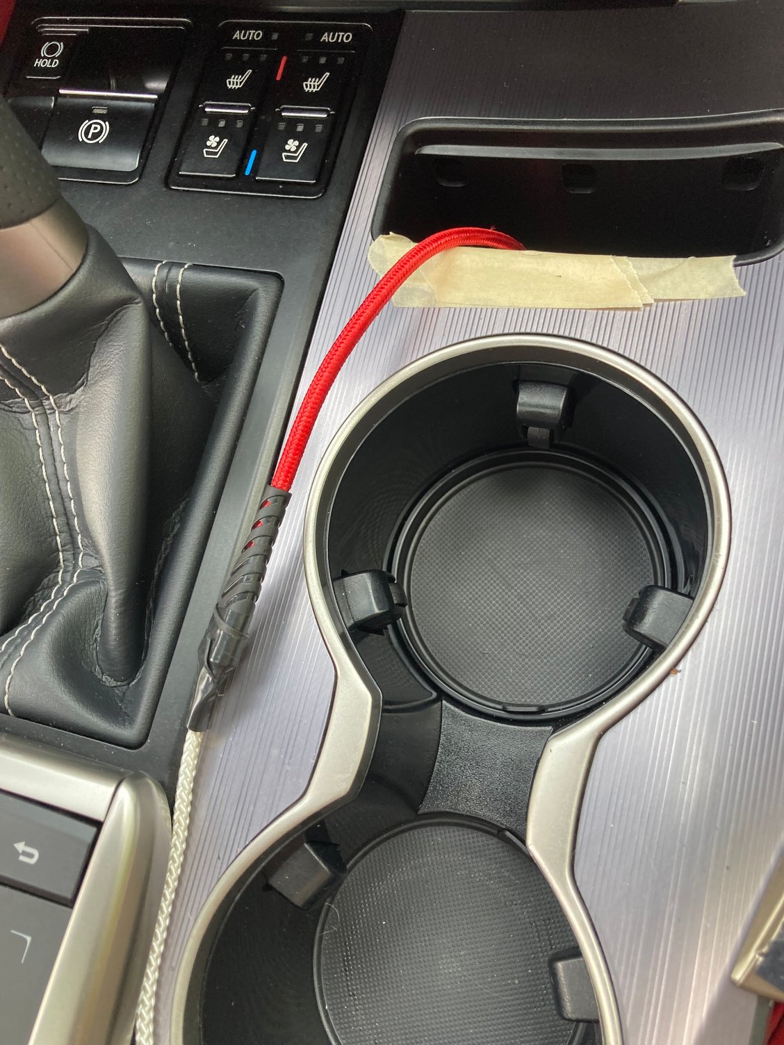

I made a small notch with a round file for the cable to pass through. Added a small grommet for a more finished look and reinstalled it. Next pulled up the female end of the usb adapter and connected a 3’ iPhone cable. Ran that though the console. Very easy with the knee bolster off.

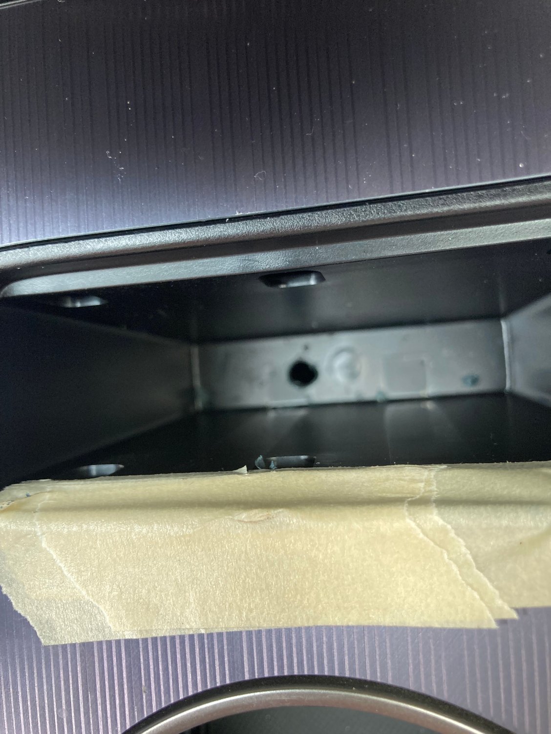

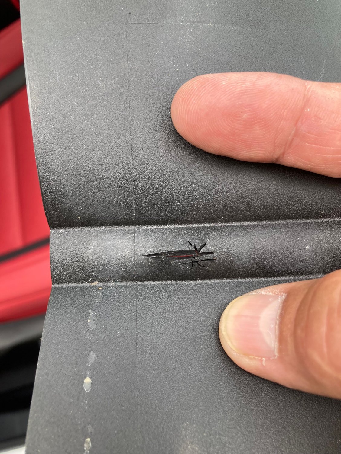

I removed the liner and drilled a 5/16 hole in the bottom of the pocket. I cut a matching hole in the liner with a razor.

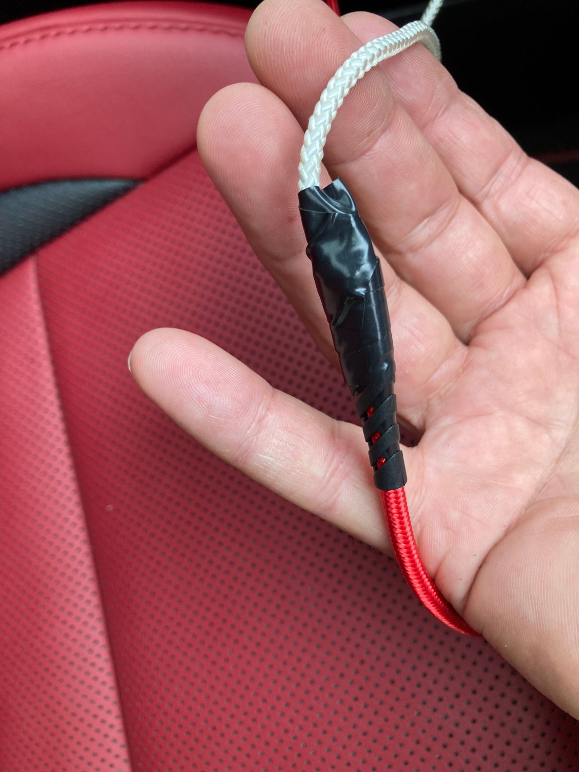

Next I passed a small piece of cord through the hole. I then used a coat hanger with a hook bent into it to reach in and grab the cord. Pull out the cord and tape it to the cable. Once joined with a piece of electrical tape I puled the cord back out and worked it through the hole.
Once it was through I untaped it and passed it through the hole I made in the liner. Replaced pocket liner, reinstall knee bolster and enjoy your cable clutter free console.
This was actually pretty easy to do. In fact I finished the job and realized the red cable I’d used did not pass smoothly back into the console. It had a cloth woven jacket and was kinda stiff. I pulled it all apart and swapped in a thinner, more flexible plastic coated cable. Hope someone finds this useful.
