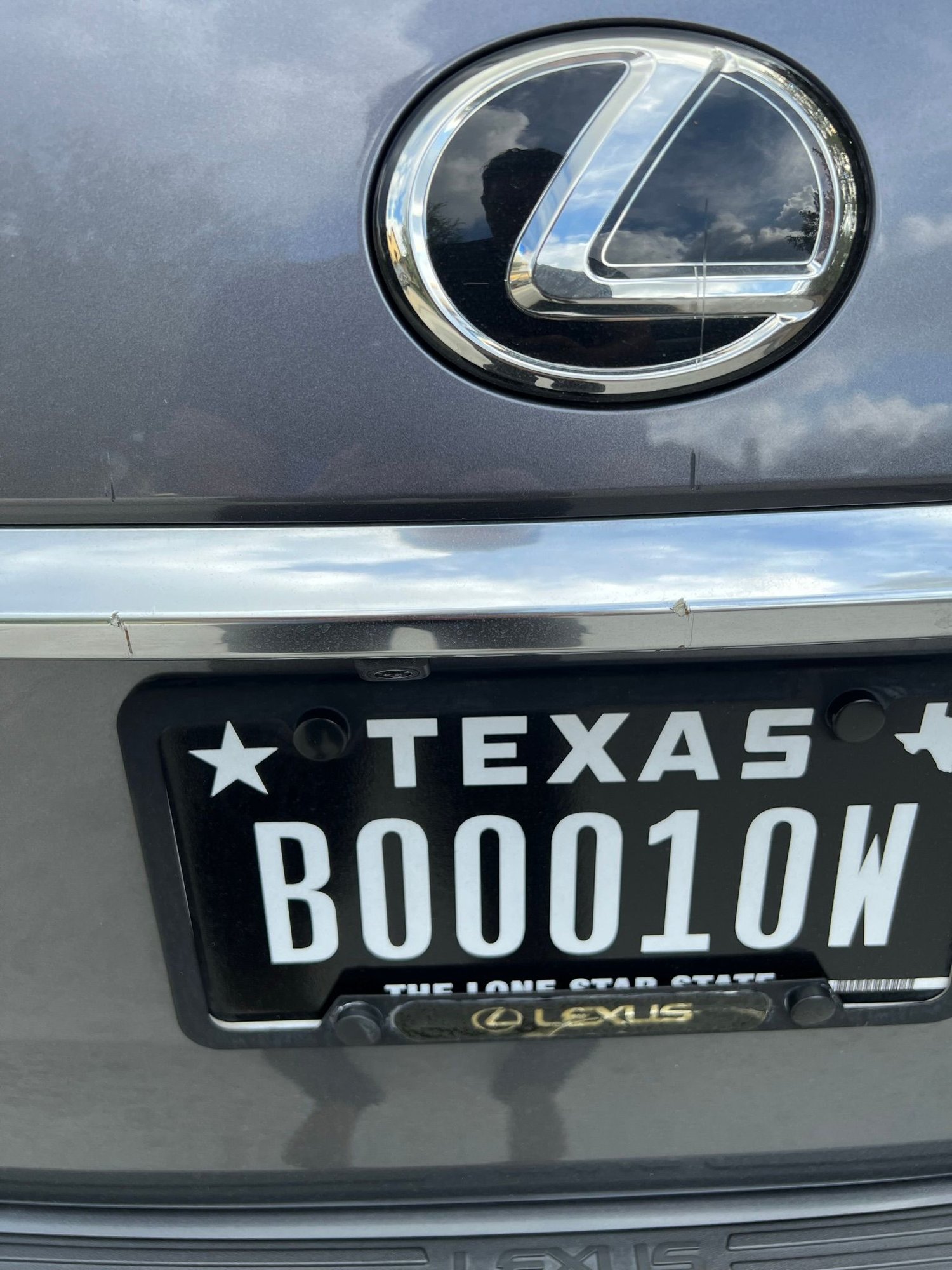

Default Replacing 2017 RX350 Emblem and Liftgate Trim
Hi everyone I 'accidentally' closed the garage door on my car and scratched the emblem and the liftgate trim. I am assuming replacing the emblem should not be difficult but for the life of me can not find the part number for the liftgate trim. I am attaching pictures any help would be appreciated as far as part numbers and removal/replacement procedures.
Thanks in advance.

Try poking around here. I do not know the details of your 2017 but this should get you into the neighborhood of the part(s) that you need.
https://www.lexuspartsnow.com/parts-...tml?pnc=75441E
You may have to hunt under rear door parts....here is another link with the emblem, and then you can extend to hunt for other trim pieces.
https://parts.lexus.com/p/Lexus_2017...540348050.html
