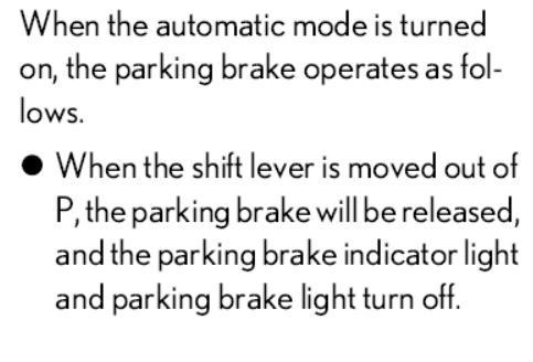

In my current NX and my soon to be RX the parking brake can be set to automatic. The following is from the 2020 manual. Depending on your year it might be slightly different.
that is not the same as brake hold.
brake hold works at stop lights, things like that. it takes over holding the pedal once you come to a stop.
so if enabled, and you come to a red light, once the car stops, you can take your foot of the brake pedal.

The brake hold is nothing more than an electronic version of the mechanical parking brake. If you follow the instructions in the manual the brake will be applied every time the car is started (yes you must put your foot on the brake pedal to start the car) and if set properly it will come on every time you put it in Park and every incline that is steep enough for the engine RPM's to keep the car from rolling back.
