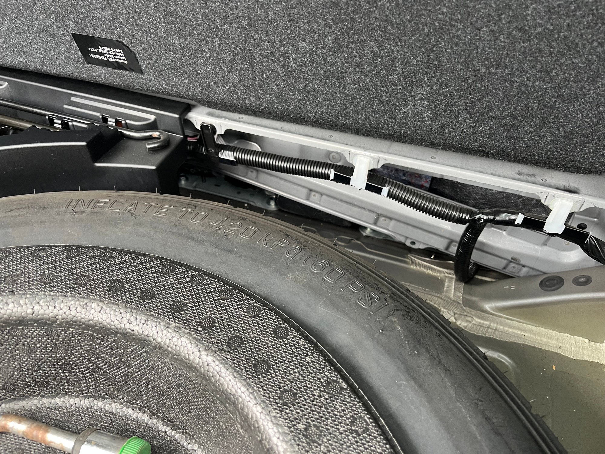

Since the repair included a 1 year warranty. I've been requested to send back the headunit, the control dial and the amp. I can remove the head unit and control dial easily, I am not sure where the amp is or how to remove it. It doesn't appear to be under the rear storage panel.

It's under this. Still need to remove all the trims same as when you remove the head unit.
Is it behind the lower metal plating below the then? I removed the plastic cover and see this

Yes, the whole console box assembly.

Isn't the amp for Mark Levinson systems, found in the cargo area. Under the cargo mat, behind the spare tire?
If that is the case I am not seeing it. Unless it's underneath behind the tools and jack panel?
