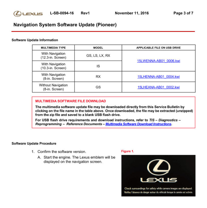

@Kulharin See if this helps
File Type: pdf

@tammap Thank you, but unfortunately it appears already have A1#5570 yet am still experiencing the issue. . I guess I could try contacting Lexus. It's currently working and wonked out since the last time, but it would be good to try an diagnose why it's occasionally goes into a reset loops while driving and it takes shutting off the vehicle for 5 or so minutes to restore it.

But your version is less than A1##8020 thou! See my post # 74

@tammap right, thank you. Can I just do this myself,? I have a USB stick but on the Lexus page is tells me an update is not available for my 2017 Lexus RX 450H, but there is one available for 2016 Lexus RX 450h... where it says "A software update is now available for Navigation Infotainment systems that match model ID 15LWENNA-AB01. " so based on what I have wouldn't this update still be valid for my 2017? No clue why it says "no update available" for 2017 when I search here https://www.lexus.com/firmware-updates# ... same if I use my VIN number or face plate code #

Yes, if you have 12.3- in screen

The file it let me download for the 2016 15LWENNA-AB01 was 15LWENNA-AB01_0003.kwi which I guess is for an 8"
Put it on a USB 2.0 2-8gb ... vehicle recognizes there is USB plugged in, but the update option is greyed out. I can't find a 15LWENNA-AB01_0006.kwi which is apparently what I need.... This is frustrating as all hell that it says there is no update available for my year, make and model... also says there is no update for my VIN number of faceplate number ... yet clearly there is if need to update to A1##8020 to fix this issue.
Anyone know how/where to find
15LWENNA-AB01_0006.kwi .. the PDF links do not work.
