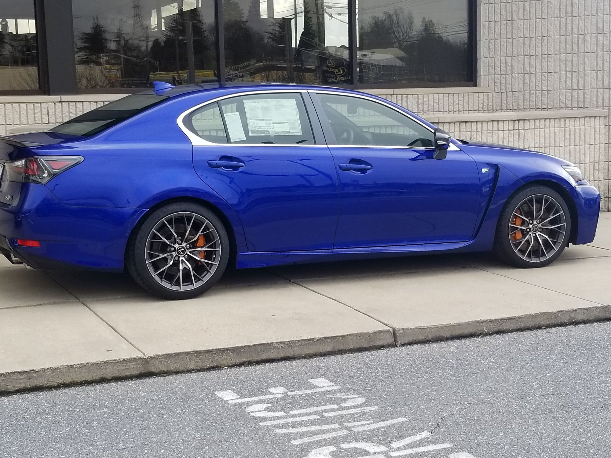

I saw these at my dealership. Wondering if we could get either for the RX. I really like the orange ones.

You probably recognize this, but just making sure that folks know those are real OEM 'big brakes' on the cars pictured, and not cosmetic caliper covers.
If you just want the color, you can get high temp caliper paint to get your existing calipers painted or go the faux big brake look with covers. If you put big brakes on the RX, be aware there are likely going to be additional implications with wheel clearance (may need new wheels or spacers), increased consumable cost for pads, rotors, etc. often have increased braking noise and more dust on your wheels.

What dealership carry aftermarket items?
