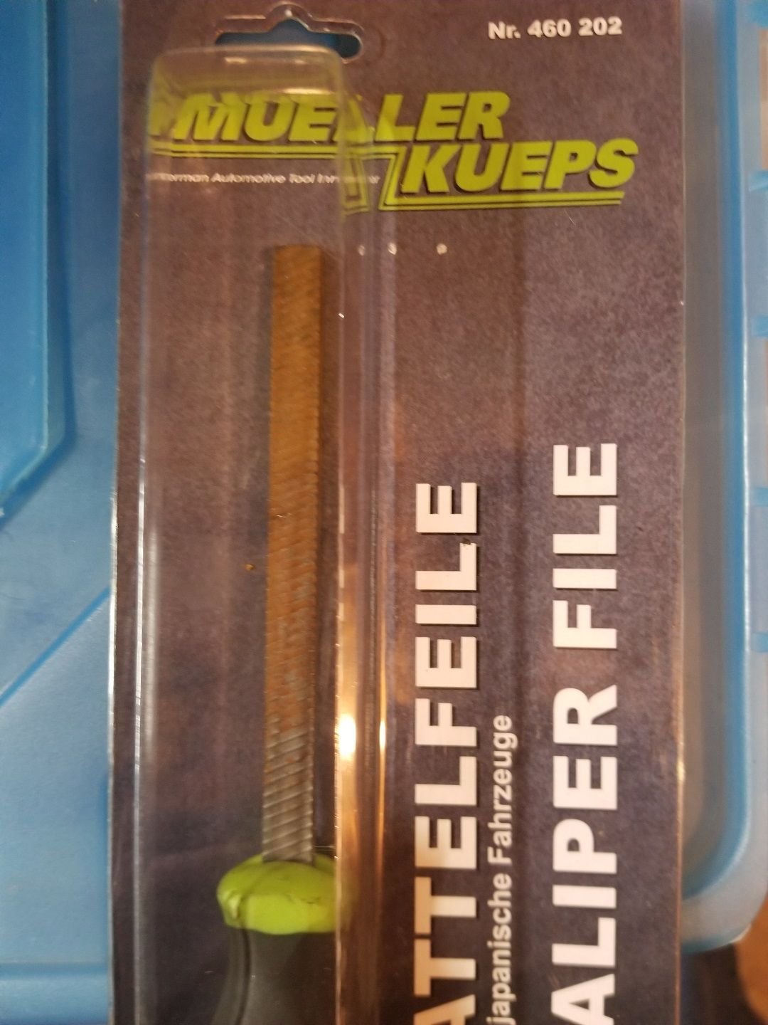

Because of the road salt and rust, I used this file tool and a wire brush to clean-up the brackets before replacing the H/W guides. Photo below :
