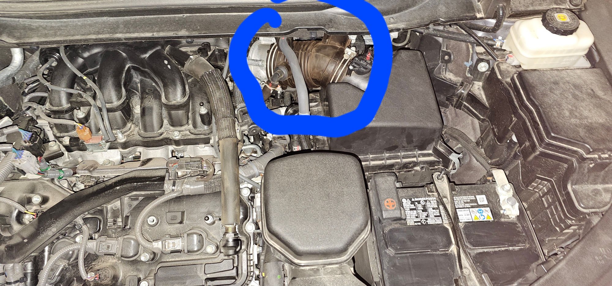

Dealers engine oil turned red for some reason after couple thousand miles. I been using Penzoil ultra platinum, engine is a lot qualiter, sometimes forget that engine is still running..
Turned red? That's weird. Hope it wasn't transmission fluid!
Reminds me of an old experience: had a 1999 Subaru, brought to the dealer for a transmission service. Got it back and as usual I checked the fluid level. Was fine but curiously it was clear, not red. I figured maybe they have a new type of fluid, after all, it was a Subaru dealer, right? Trans lasted about 4k miles when it died. Turns out they put some kind of gear oil in it!
I was worried about it as well. it started as regular engine oil color. I Always check after services. It slowly turned and started looking to have a red hue at round 3000 km of use, still clear tho, just has a red tint to it. I seen some people with similar issues on other toyota forums using dealers oil, and one sent the oil for analysis and came back normal. I changed the oil out at round 8000km and by then it was looking like some used engine oil which has turned brown, still a slight red tint, but just barely.
Sometimes I wonder if it's Shell premium gas, I have always thought that some just very minor amount of gas can get into the engine oil, maybe has to do with shells additives.
The oil can turn red because of certain oil additives and nothing to be concerned about. However, it could also be caused by a cracked intake manifold or a leaking head gasket. But since you said it occurred at a different mileage with 2 different brands of oil then it is most likely the additives.
it was actually just that one time, drianed that oil in May, and I asked dealer to use the self supplied penzoil ultra platinum, haven't notice any color change after 2000km.
But cars air intake hose does have accumulated orange/red powdery dust on top, smells like rotten egg, doesn't feel to be greasy at all. Dealer says it's normal as part of the pvc or evap system? Intake manifold looks clean.
