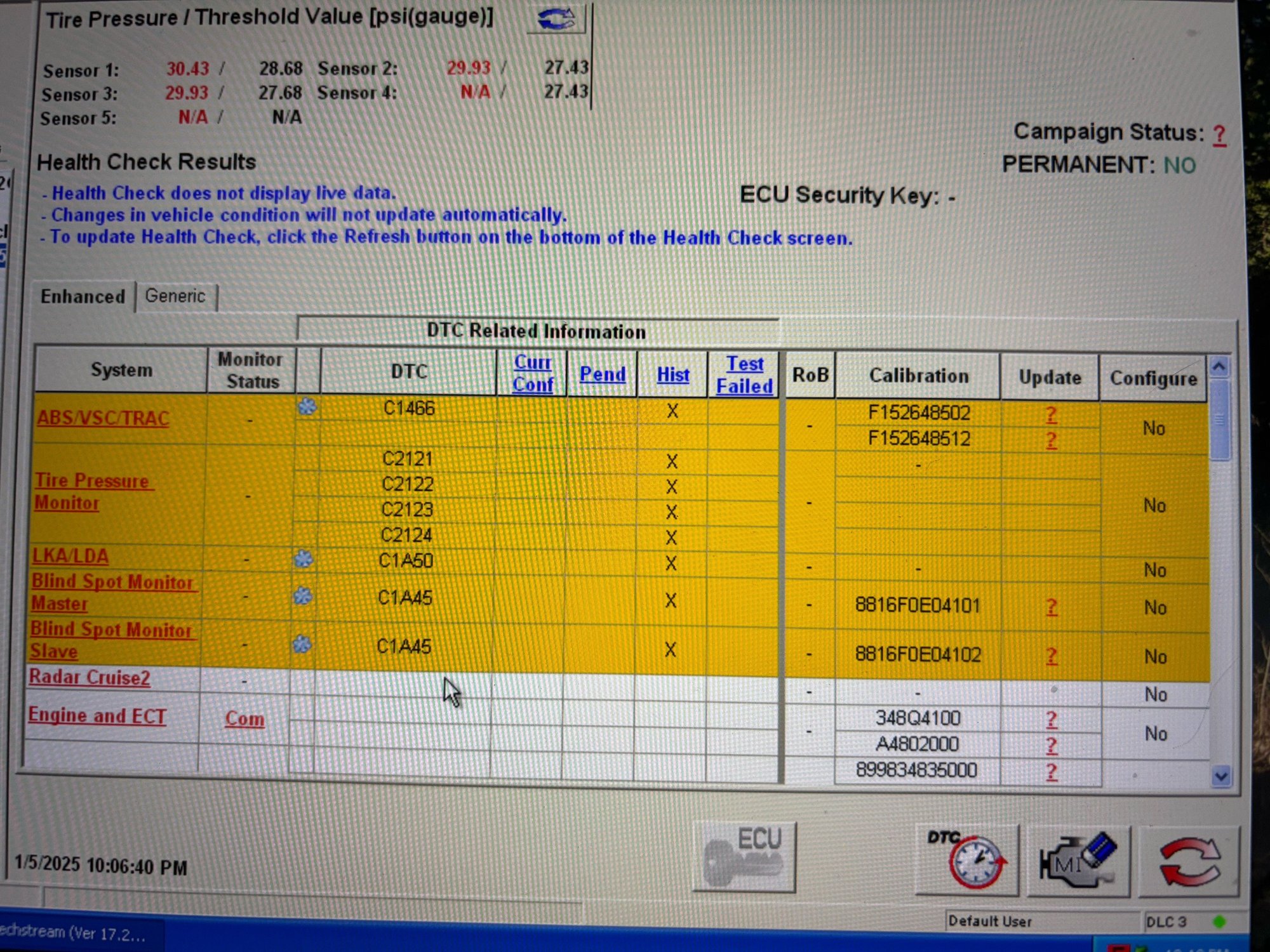

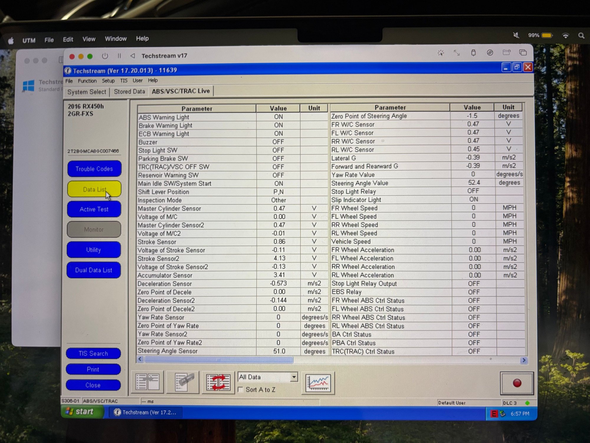

Jun 3, 2025 | 03:04 AM
I see you have access to tech stream. Go into vsc/trac live data and drive around. Watch the wheel speed. You can also pull up the exact code.
I had a similar issue to you in January. My car intermittently lit up like a Christmas tree. I wasted my money replacing the battery first and ignored the error code. It was a wheel speed sensor. It looked fine and worked fine on the highway. It triggered at low speeds though as it would drop out signal. I bought an off brand sensor from Amazon to try. I figured it was only $30 and it worked.
you can see it was my right rear wheel speed sensor in the freeze frame data below.
I could see nothing wrong with the wire. I’m in the rust belt so I did clean up the mounting location and scraped rust off the hub. It’s held in with one bolt.

Jun 3, 2025 | 03:06 AM
The speed sensor set off the other codes (ignore the tpms codes- I was running winter wheels).
