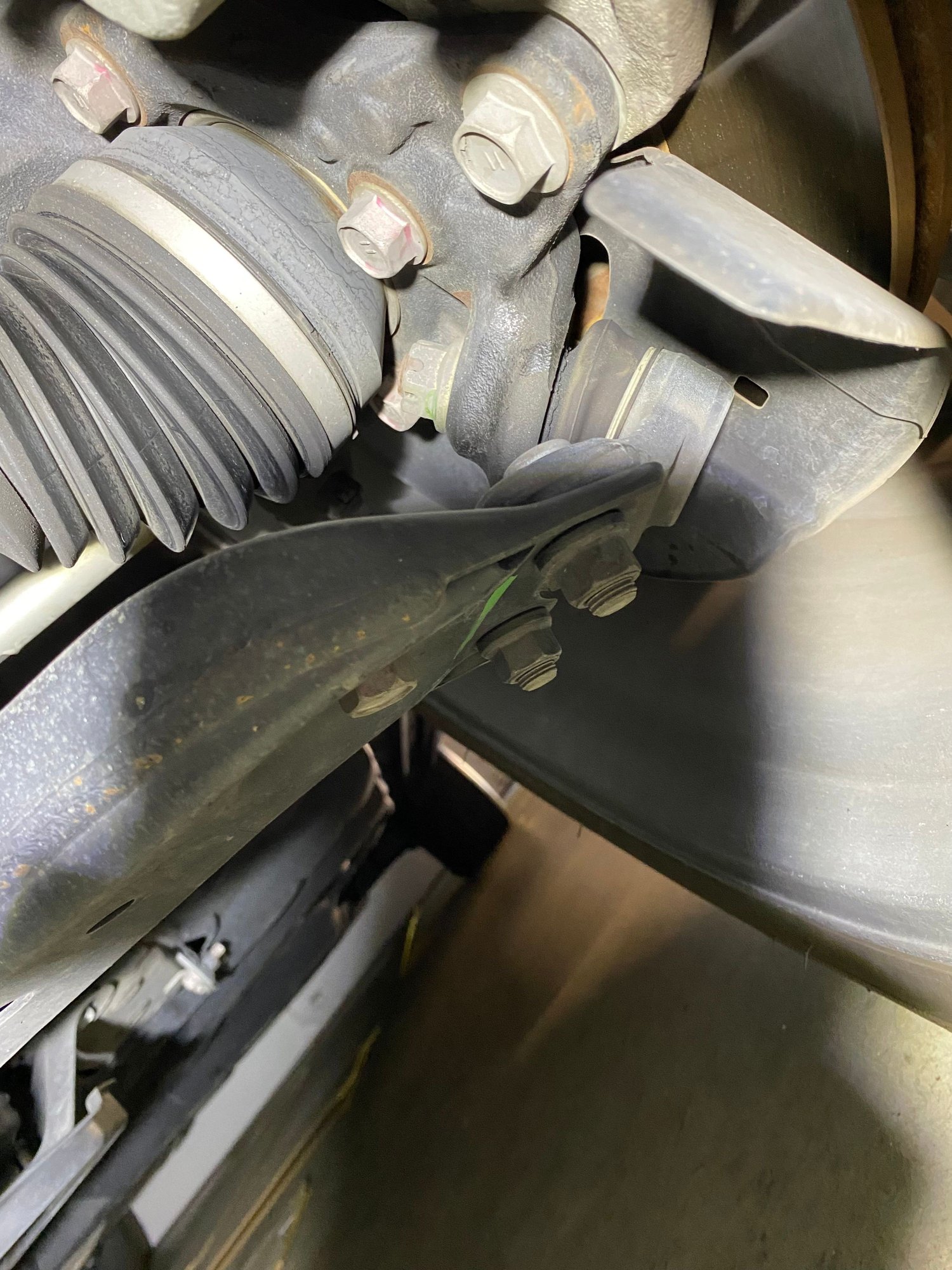

Hello. I noticed that my 2020 rx 450h with 36K miles has front lower arm bushing that looks greasy as if the lubricant has leaked out - see pictures. The right side has more than the left.
Front, right
Front, left
Are these normal or known issue for that model? Thanks in advance.

That looks like a ball joint to me.
Dont worry about it until you start hearing clunking noise over bumps.

Agree that is a ball joint and not to worry about it until it starts making noise. It may just be the picture but it looks like there is a tear in the rubber boot which would explain the grease leaking. Also looks like someone may have been into it in the past as one side of the cotter pin is typically bent over the top of the stud at the factory. The other side (picture 2) looks fine.

@Volley the right side does appear to have more grease in the surrounding ball joint & I’m not sure if that is a rubber housing tear or a build up from the grease being exposed to dirt from daily driving. The reason why this came to light is because my stock Michelin Premiere LTX front tires are cupping or peeling in different spots across the tire treads. The rear didn’t have the same issue until I rotated the tires and now they are also peeling. I thought it might’ve been my front suspension issues rather than alignment issue…

Dealer inspected my suspension and said the ball joints were normal and found no tear. They advised that the scalloped tires are from misalignment and/or poor road condition. My tires had 3/12 thread left and are not uncommon for these Michelin Premier LTX (stock tires) to wear out quicker than others according to them. Yokohama’s are recommended & I must agree from past experience.
