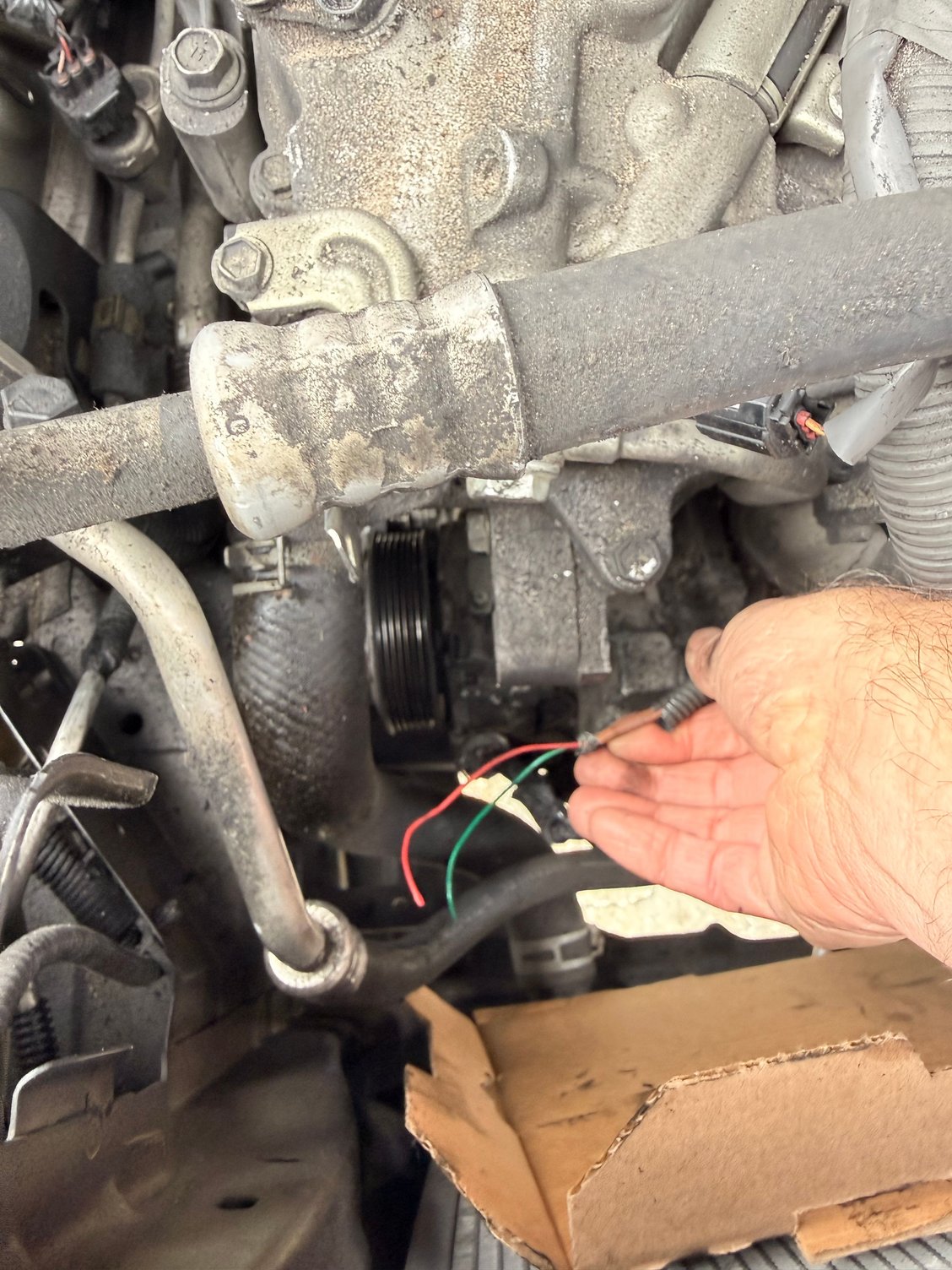

Default Same thing!!!!
Originally Posted by Jaredrome
While replacing alternator on 2011 rx350 pulled red and green wires connected to the L bracket out of the sensor or whatever it may be. Was looking for any insight on what it’s going to. Car will not crank now.
Did you find out where these go? I did the same thing!

The crankshaft position sensor is located at the front of the engine, near the crankshaft pulley, behind the air conditioning compressor. Therefore, these are most likely the wires leading to it. You can perform a test – connect a diagnostic scanner. Access the online parameters. When cranking the engine with the starter, check the RPM parameter. If it shows zero, then these are indeed the crankshaft position sensor wires.
It's also possible that these wires are connected to the compressor, and when they broke off, a short circuit occurred and the fuse blew. Check fuse IG2, EFI MAIN (EFI NO.1 / EFI NO.2), AM2
Based on the wire colors, these are likely the wires for the air conditioner compressor.
