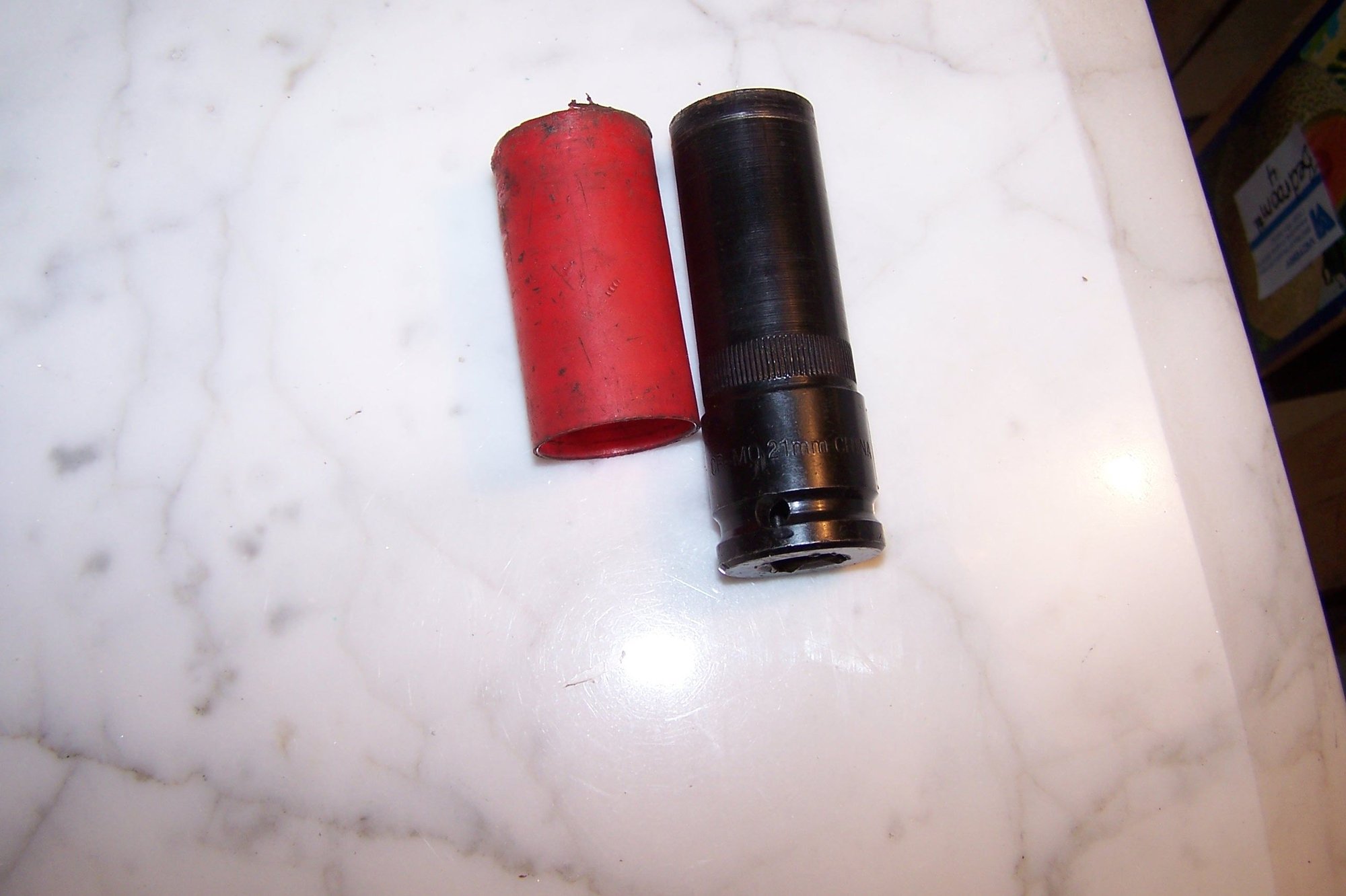

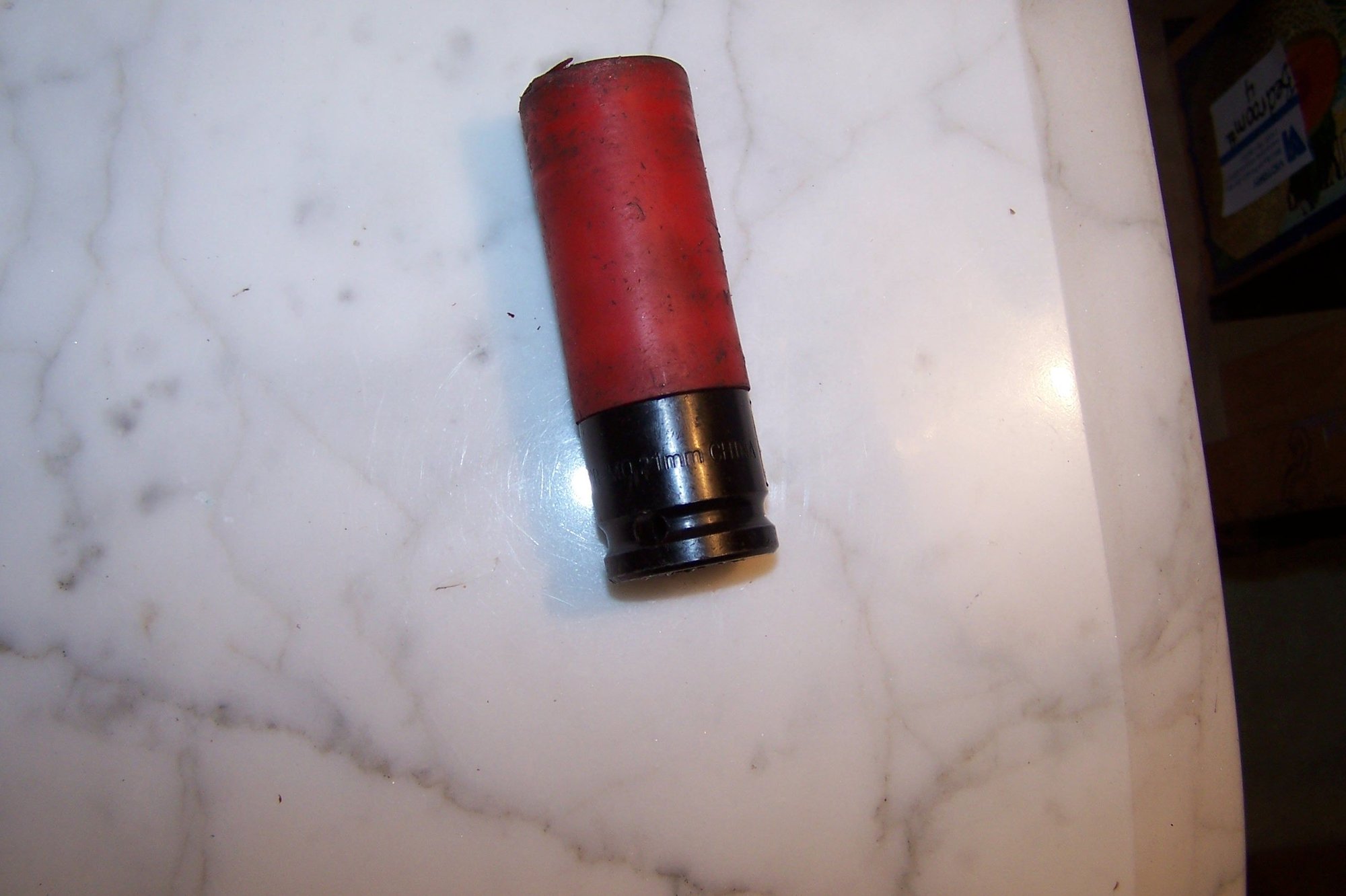

M12 x 1.5 refers to the diameter of the threaded portion of the bolt. It does sound like you have some aftermarket wheel bolts. Do post a photo. Although a 12 point socket may not fit a standard wheel bolt. All of mine are 6 point or sided. That is what you need.
The wheels take a 21MM 6 point lug nut socket. I have a set of nonmarking ones from Harbor Freight. Both my Lexus vehicles and my Toyota all take the same 21MM socket. The locking nut needs the key which also takes the 21MM socket. Here are photos of my well worn socket and a link to HF which sells a set for about $54. Or you can buy a single 21MM nonmarking socket at Amazon for about $6 or $8. Below are the item titles on Amazon so you can search.
Sunex 284921 1/2-Inch Drive 21-Mm Extra Thin Wall Wheel Protector Impact Socket
Performance Tool W32925 Performance Tool 1/2-Inch Impact Drive 21mm Thin Wall Socket , Red
https://www.harborfreight.com/12-in-...-pc-69781.html
