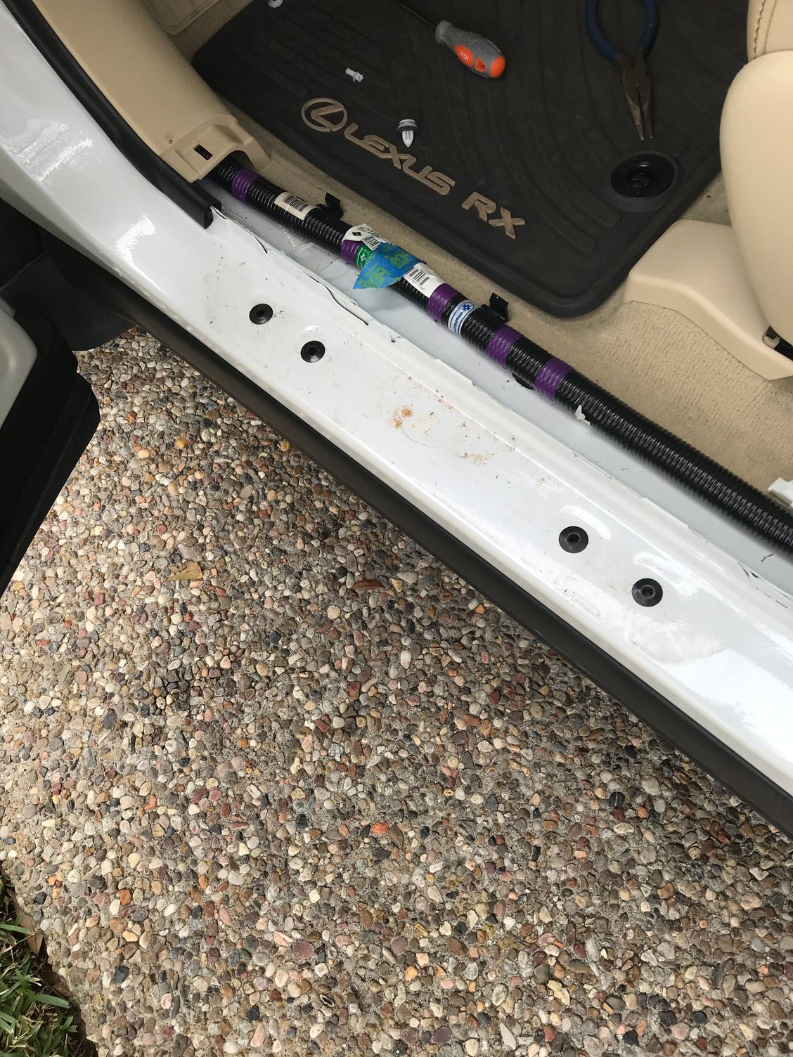

Images: https://imgur.com/a/msiE7iU
I can't seem to find the clips that go in the door seal panels? Can anyone inform me where I can purchase some of these clips?

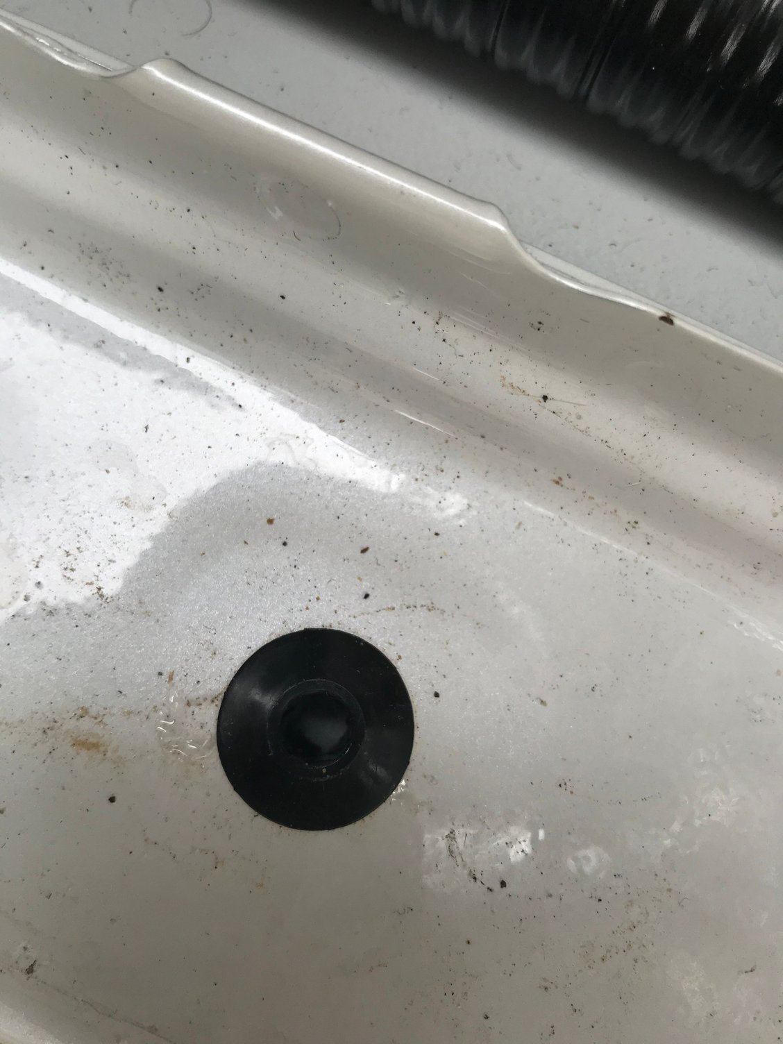

If you look in the body where the clips press in, you will (if your car is like mine) see black plastic receivers for the white plastic pin. I had to remove the black plastic receivers because I didn't have the strength or leverage to pull the new pins apart. It was a pain to remove them.
I then slid the entire new clip - both the black and white pieces conected together - into the sill plate and pressed the sill down. They snapped into place nicely. I believe these are the correct ones, because the next time I pulled the sill out a couple of those snapped and they looked just like the others. Also, the description implies they are for the sill plate.
Ah I guess what confused me is the clips have a thin perfect circular body. I didn't realize the black housing shell or w.e could possibly be in the vehicle still.

The "receiver" part that is still in the body is not easy to remove. I tried the special tool for removing the clip(working end shaped like a "C") and that failed miserably. I then resorted to needle nose pliers. Be careful about prying the black piece out - you can easily grab and bend the metal which the black piece goes into (ask me how I know )

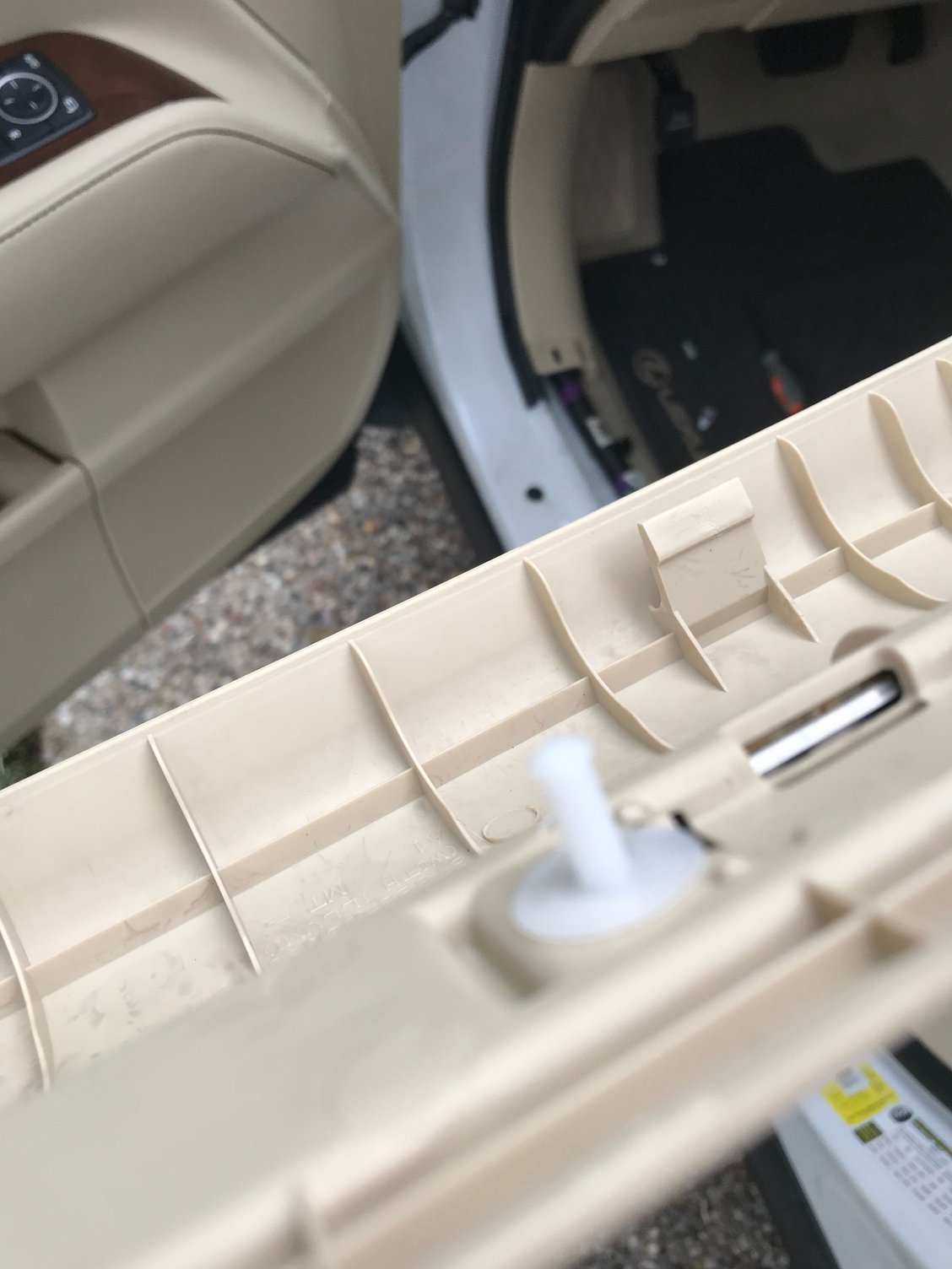

Hey guys, I just wanted to be perfectly clear on this so I took some more photos and removed the broken clip in question [which was quite hard to get out..].
If I am not mistaken, based on what @mtellup has told me. The clips he ordered are the correct clips, the issue with them is they come in the black housing. I can either remove the black housing that is already in the door frame, or I can break the shell off of the new clips to insert them into the existing housing?

The white, green and blue clips in my pics are for the rear door sill plates.
I had not removed a front sill plate until a few minutes ago, the fronts are different, just like in your pics.
One of the white stud clips broke while removing the front sill plate.
I pulled the black ring out of the body hole and replaced the 2 pieces with a green clip which is working fine.
