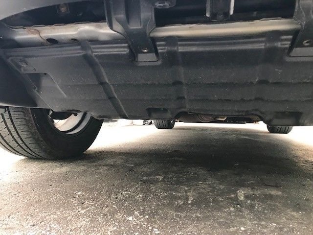

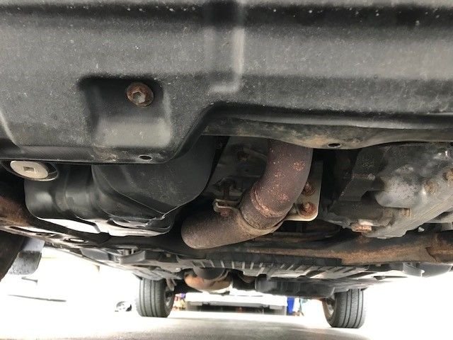

Looking for some help on this. I just sold my '04 RX330 and got a used '13 RX350 F-Sport. After a week, I just noticed that there may be some missing undercarriage cover. Could someone help me to identify what I am missing so that I can go back to the dealer with some information? Really appreciate it if someone can let me know what the part numbers are and if possible, some pictures of the parts on the vehicle as well.
From the front, I do see there is a large cover that is attached to the bumper, is there another piece that covers the oil pan, transmission area etc...?
From the rear driver-side, I am definitely seeing that there is a small piece missing near the wheel as there is on the passenger side.
Is there a large middle cover for the rear?
Hope the pictures help.
Existing front cover right after the bumper.
Front undercarriage. Is there a cover for the oil pan area?
Missing rear driver side cover
Passenger side with cover present
Missing rear middle cover?

Thanks Salim. I did tried searching on lexuspartsdirect.ca as this is where I normally buy my parts but could not find it. I took your advice and went to a dealer near me and they too had a difficult time finding it, but nevertheless they did. The part number was 58724-0E011. It’s quite expensive. Dealer quoted $542.45 CAD after tax. If I order from lexuspartsdirect.ca it’s $411.83 after tax and shipping.

Are you referring to the “white” plastic piece? At first I thought there is a separate piece much like the one on the passenger side, but it turns out the driver side is part of the middle cover.
Some pics.

I believe the rear driver's side piece is 58723-0E010, and you already have the part number for the rear center piece. I realized mine was missing the rear passenger side cover about a year after I bought it, and I picked one up new on eBay for far less than the dealer would charge, about about third of the MSRP. They're easy to install, but like SalimShah said, you'll need some clips too (52161-02020 I *think* were the clips), and you might need some screws as well. I picked up the screws from the local dealership so I don't have a purchase record on eBay of what I bought, but you could get those (and the clips) from the dealership since they could tell you the rights ones for sure.
