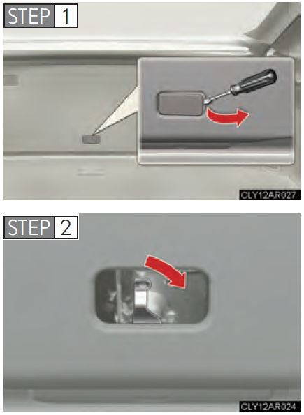

I would suggest to start with checking the rear latch for loose parts and apply some anti-seize. You should be able to get a better handle from inside the trunk area by removing the small cover. . The picture below illustrate how you can access that.
I hope this will end it but if the problem persists, then the latch mechanism assembly might be the next to blame. Keep us posted please.

Hi heshamos,
Thank you for your reply and for the diagram. I popped the cover off and it seems that the mechanism is loose and "jiggly". I added some moly grease and silicone spray. It seems to have improved the issue, as the "back door open" error only came up once on my way to work. I plan to take it into the shop to get the latch adjusted. Hopefully there is a way to tighten the mechanism without having to get a new one.
