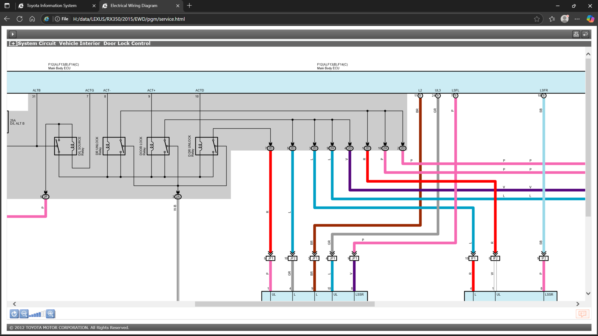

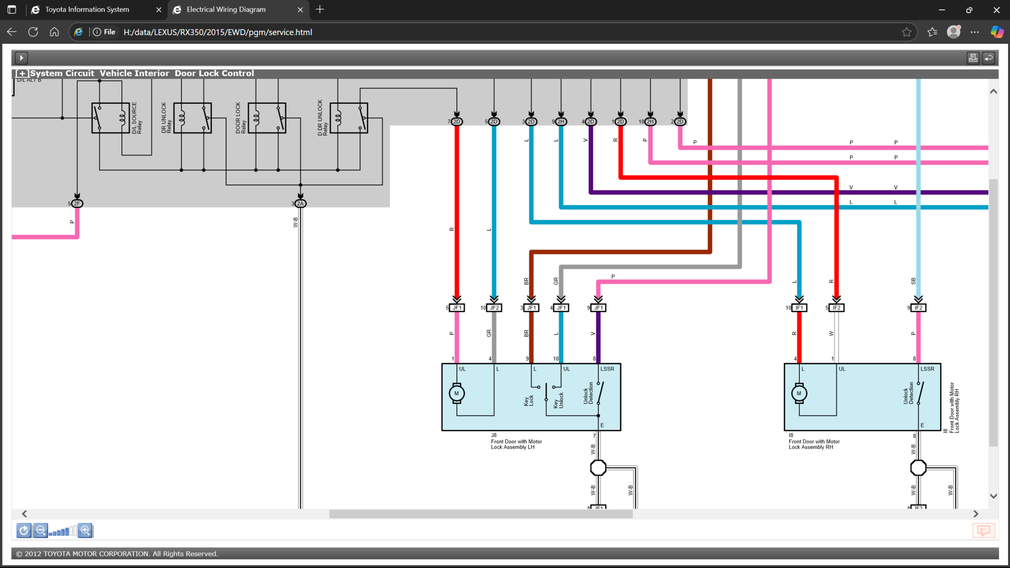

Old Jul 5, 2025 | 10:14 PM
carguy75's Avatar
carguy75
Joined: Nov 2015
Posts: 1,060
Likes: 360
From: Atlanta, Georgia
Hope this helps

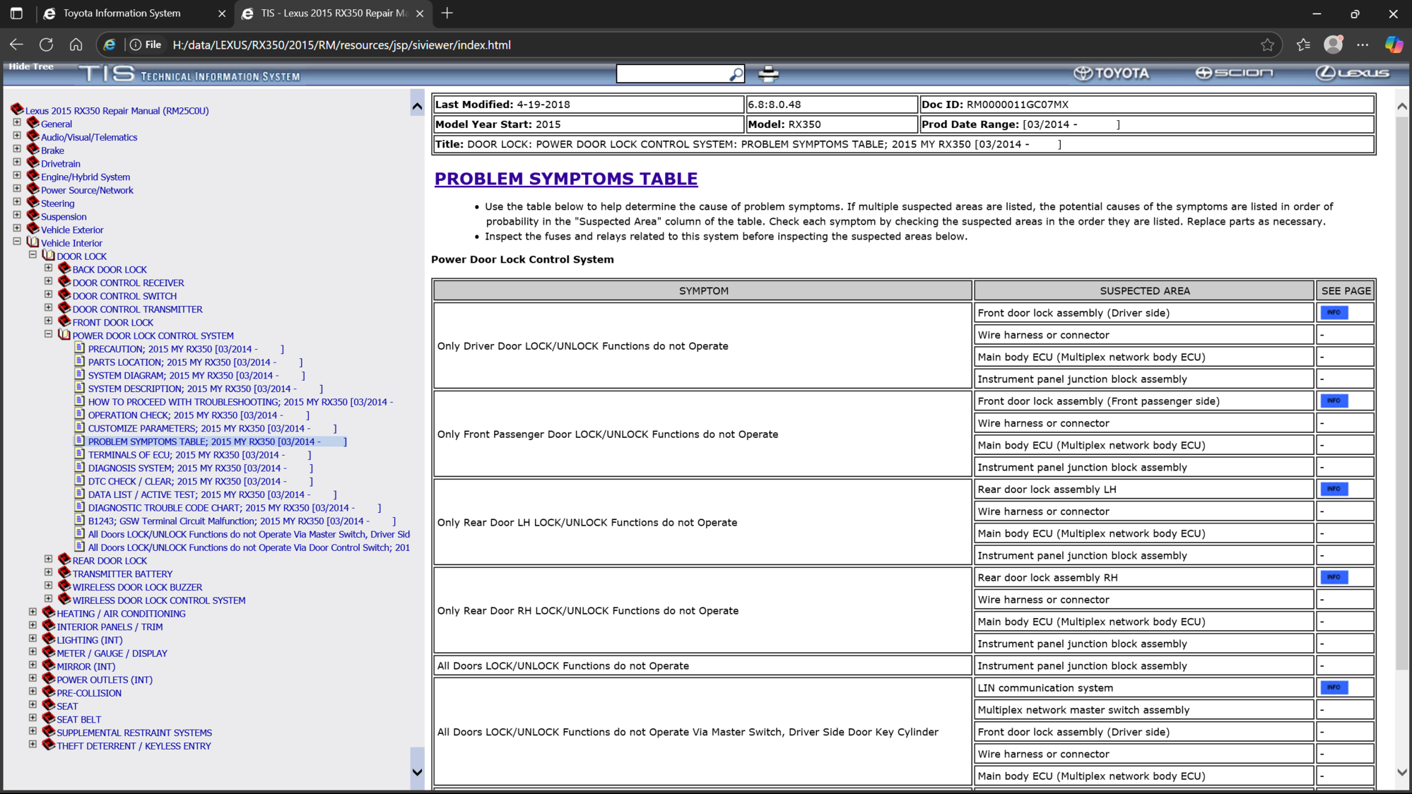

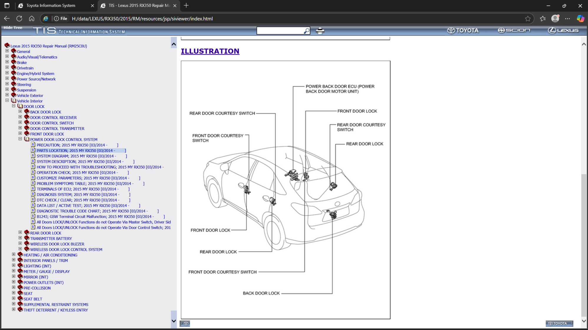

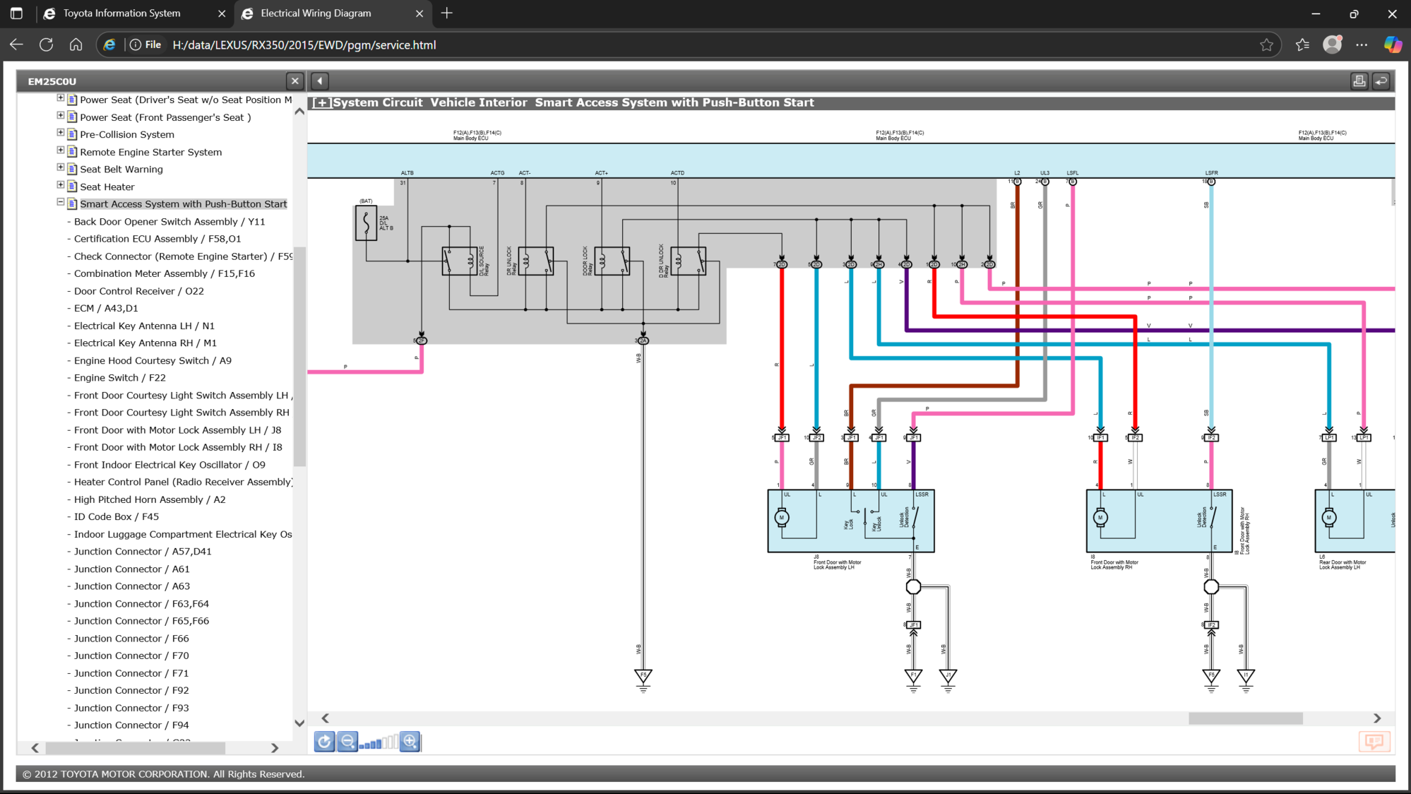

Old Jul 6, 2025 | 07:02 AM
salimshah's Avatar
salimshah
25 Year Member
Joined: Apr 2001
Posts: 16,559
Likes: 1,385
From: Austin, TX

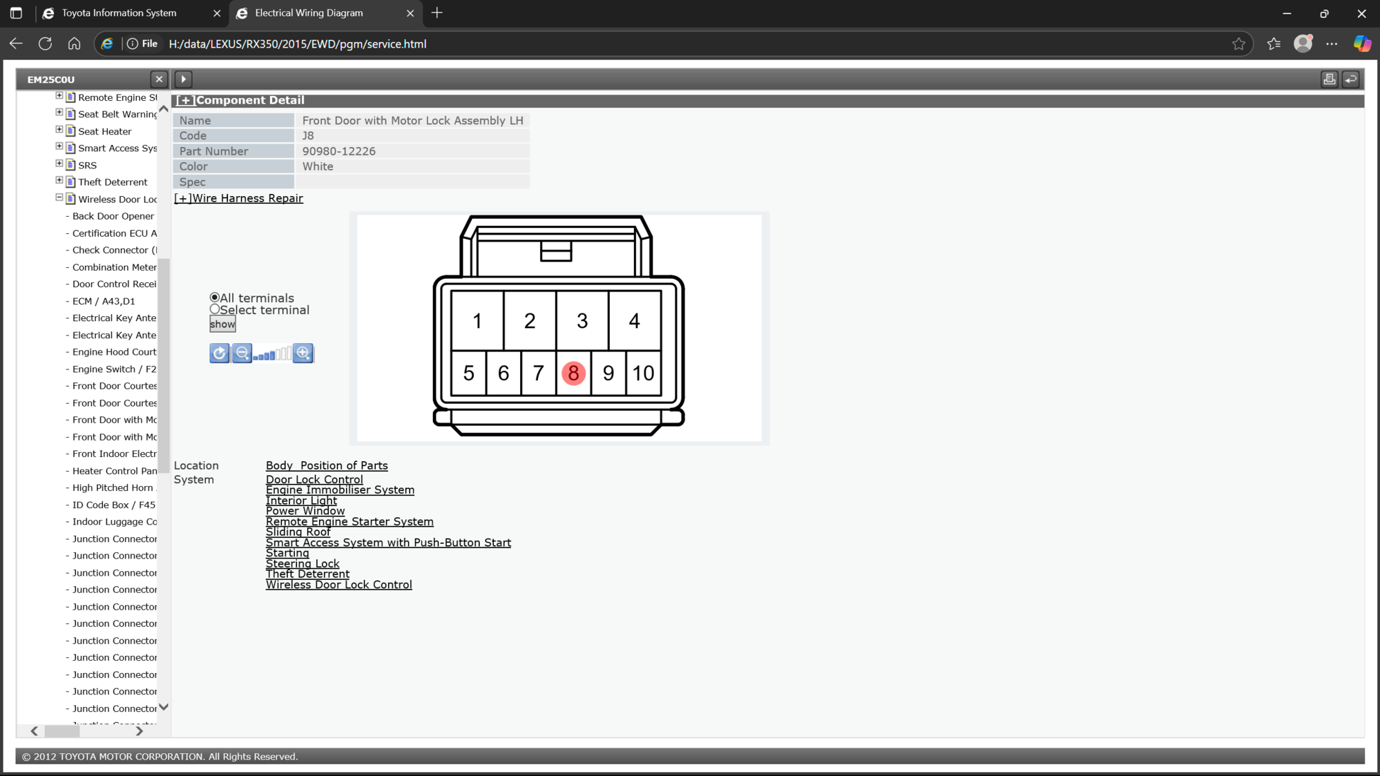

You are always so helpful carguy75. Is there any diagram that goes to the door handle side. The diagrams you posted cover the motor side.
Salim
Old Jul 6, 2025 | 07:56 AM
carguy75's Avatar
carguy75
Joined: Nov 2015
Posts: 1,060
Likes: 360
Thank you. I try to help when I can.
I believe that the diagram I posted covers the door handle unlock button. It is part of the unlock detection for the smart access system which is pin# 8(LSSR) on the wiring harness connector for the motor assembly. So it seems that the LSSR switch just triggers an lock or unlock state based off the security system state(armed or disarmed) when the door handle sensor is activated.
