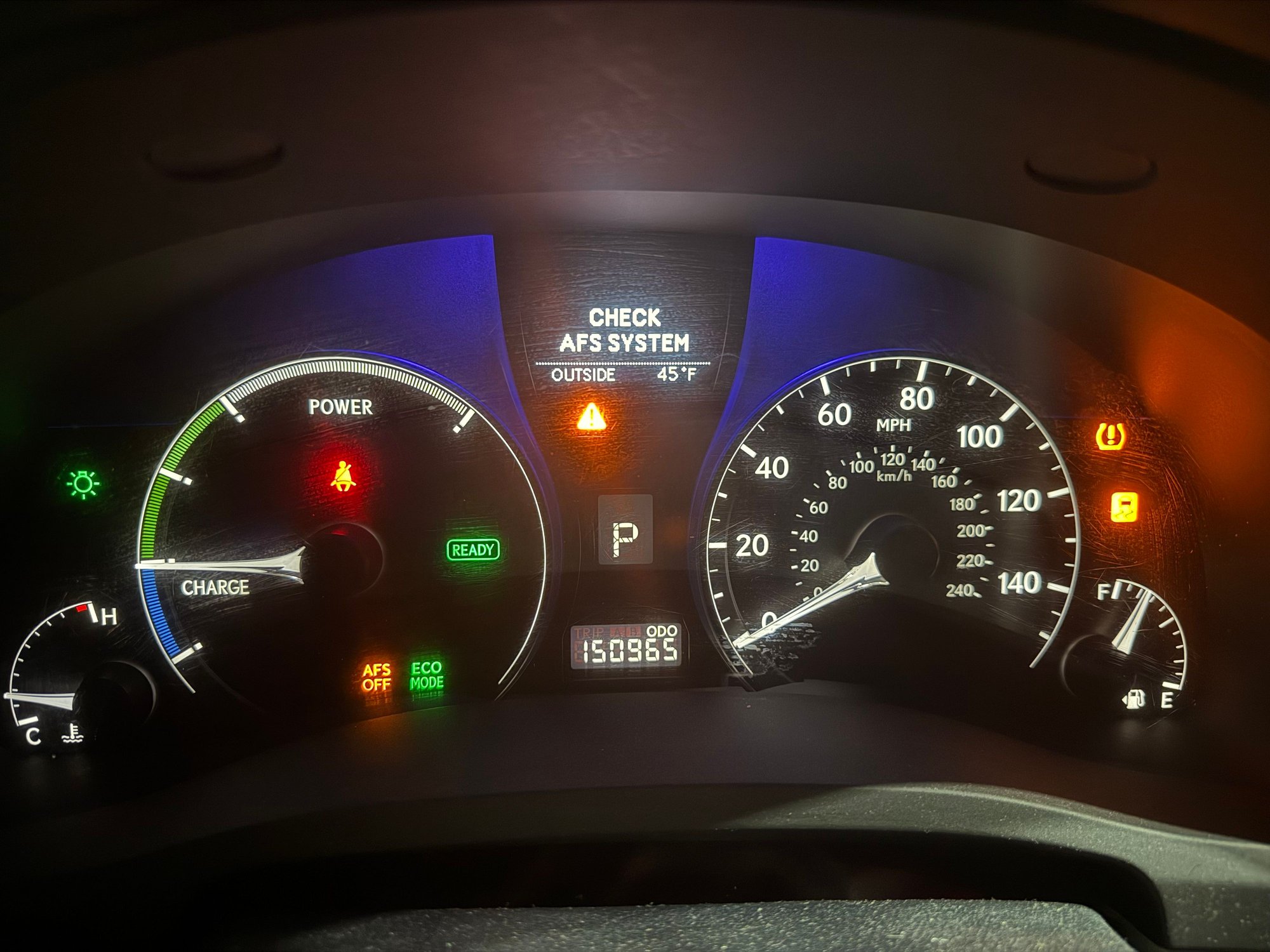

Hey everyone,
I’ve been dealing with a really strange issue on my 2010 RX450h and I’m hoping someone here has seen this before.
Whenever the temperature drops below about 45°F, the car refuses to unlock with the key fob. The smart key doesn’t get detected unless I touch the Start button with the fob. After it starts, I get these warnings on the dash:
  • Check AFS System
  • AFS OFF
  • Traction Control
I also notice the anti-theft/security light doesn’t blink like it normally does.

I know this is an older thread but I'm having the same exact issues on my 2010 450h and I'm at a loss. Haven't pinpointed it down to temperature, but it's something I will be monitoring to see if that's possible. The car seems to appear "dead" at random, but then also go back to normal at random. For example, I had a work trip and when I went to leave for the airport, the car would not recognize the fob, no interior lights (but horn did work), seat and steering wheel memory was not working, and I had to start the car with the fob touching the start button. Parked the car for 5 days at the airport and when I got back, the car acted completely normal again without me doing anything, even though when I shut the car off at the airport and tried to start it again, it still appeared "dead". Then yesterday, I went to bring my daughter to school and again had the same issue where it appeared "dead" with all of the same symptoms. Drove her to school which is about 4 miles round trip (maybe 15 minutes total), and when I got back I shut the car off and then put it back on and everything went back to normal again (although I tried this a few days ago also and it did not go back to normal until I tried again about 3 hours later). Very odd and frustrating.
Below are the codes that appear when I have the issue (no recognition of the key fob, check AFS system message, have to start the car by holding the fob on the power button):

Below are the codes (listed as historical) that appear once the car goes back to normal again:
