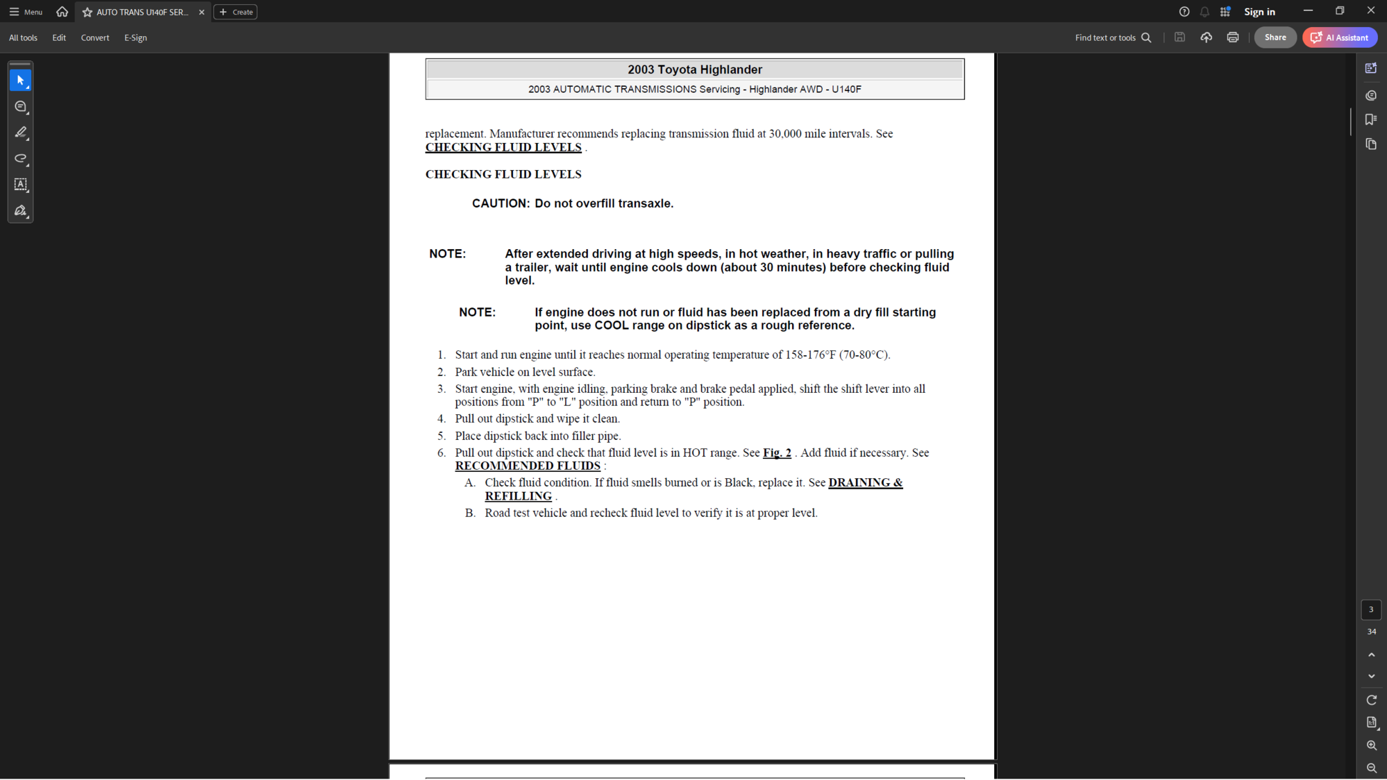

Most here will not. Many members who did not use a proper scan tool to measure transmission fluid probably did not really compare the differences in using an IR thermometer vs. the scan tool readings.
The good news is that the transmission fluid has an temperature range(about 150-170F) that is acceptable for a fill. I would wait until the IR reading is about 140F off the pan which is hopefully an internal 150-170F fluid temperature.

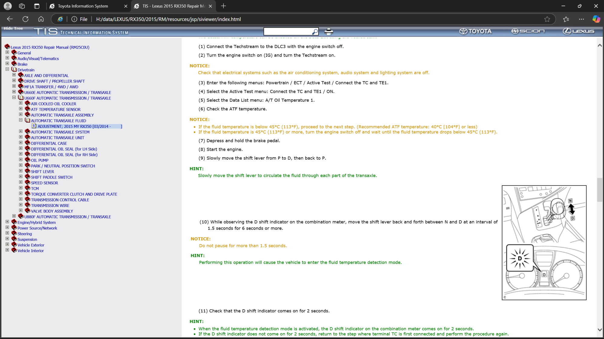

I stand corrected. I was thinking about the Toyota 5 speed automatic in my 2007 Highlander 3.3 V6 4wd filling temperature range.
The RX350 fluid filling temperature range is 104F-112F, but 104F is ideal per the service manual. So I guess a IR pan reading of about 100F would be good.

Here is the older 5 speed transmission fluid fill data which I mistakenly posted for the RX350 6 speed transmission. Major mistake there.
Reply 0
