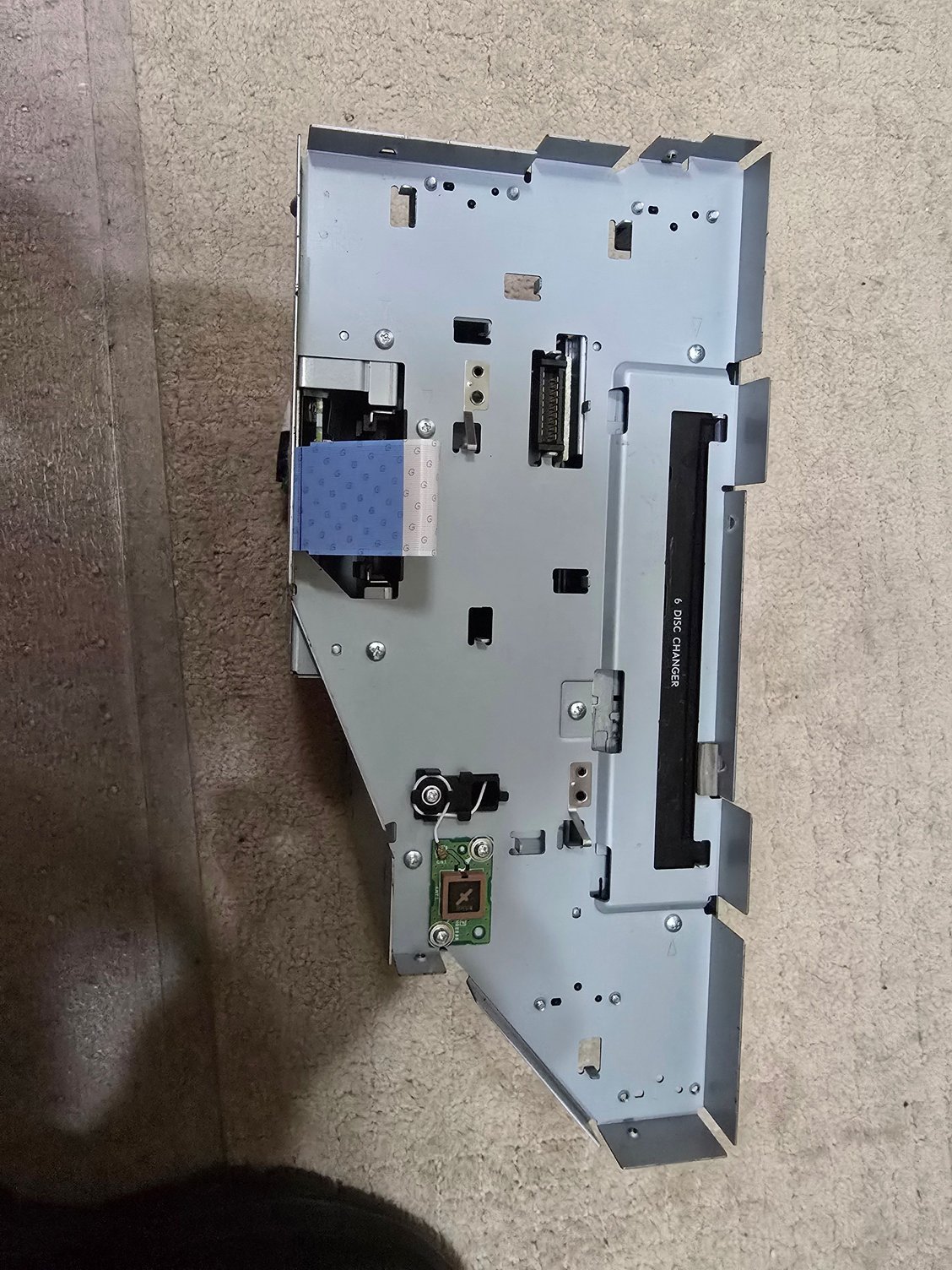

To remove the front cover, you remove four screws holding the plastic bezel to the radio unit itself. Then there are four snap connectors, see pics. The bottom corner is rather obvious, but it will keep snapping back as you try to get the top two. They are located to both sides of the emergency flasher switch. Less than an inch to each side. You need a real flat long tool. I have a metal splunger I use on computers. You need real thin to slide under the plastic, then it needs to be metal as you have to put pressure to lift. At the same time, pull on the cover to remove. Takes time but I think I can do it pretty fast if needed now. There is one ribbon cable with a flip type connector from the radio to the front panel and an insert only connector. So don't drop or pull too fast, as you want to disconnect the ribbon cable neatly.

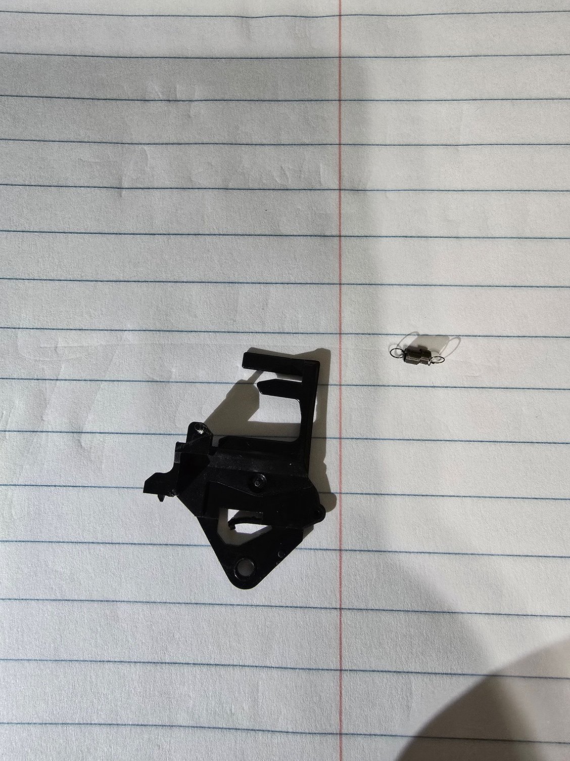

Unfortunately, when I opened the CD changer I found a spring loose and plastic piece that I could not figure how it was supposed to sit in the unit. Had to remove the top of the unit and I was able to rescue the CD's. Now I have ordered a replacement unit and it will be here next week. Not cheap, and I think I won't be using the CD Changer, just one CD at a time. Problem with a replacement unit is that my Satellite unit identity will need to be updated. Btw, the new head unit has never displayed any OEM Satellite radio information, so had to do presets with another radio synced to channels so I could match up. Annoying, but minor overall.
Bezel with board removed from radio.

Here is what was floating in the CD changer
