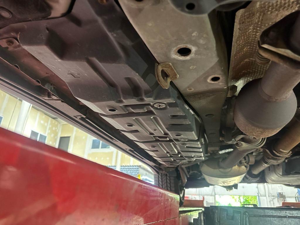

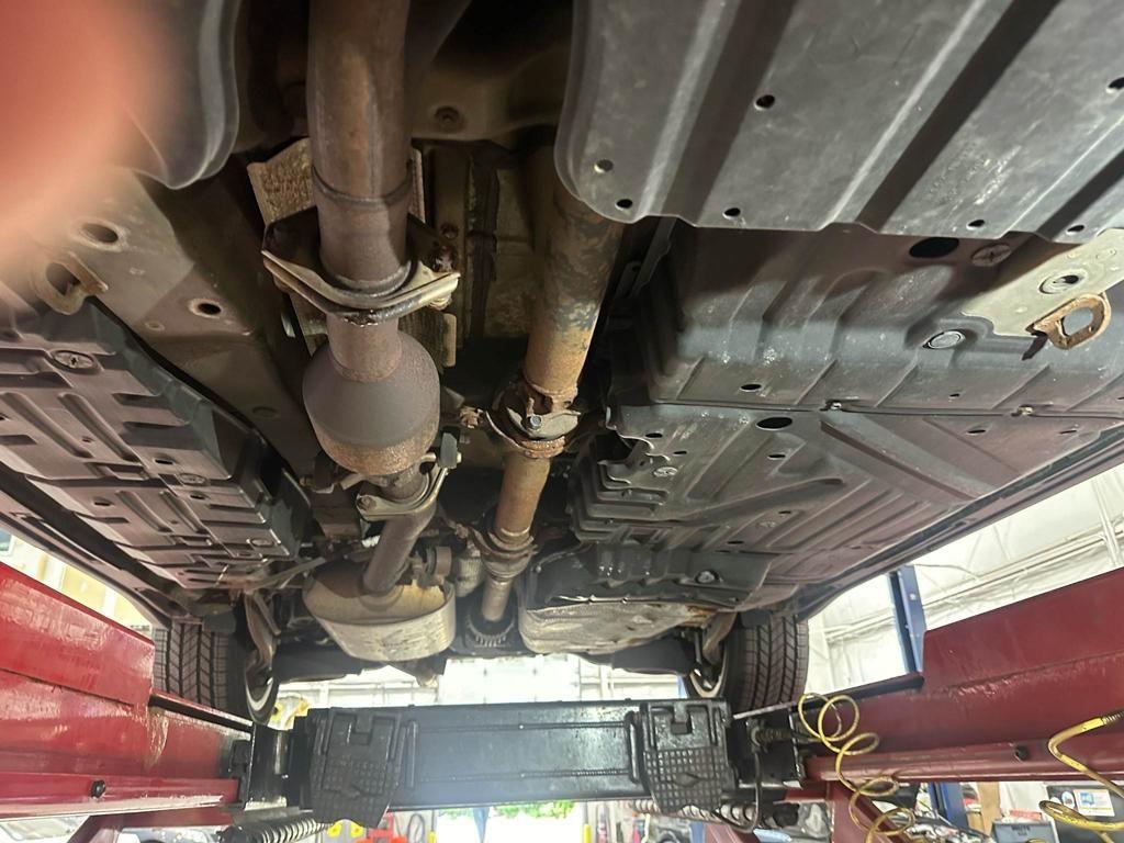

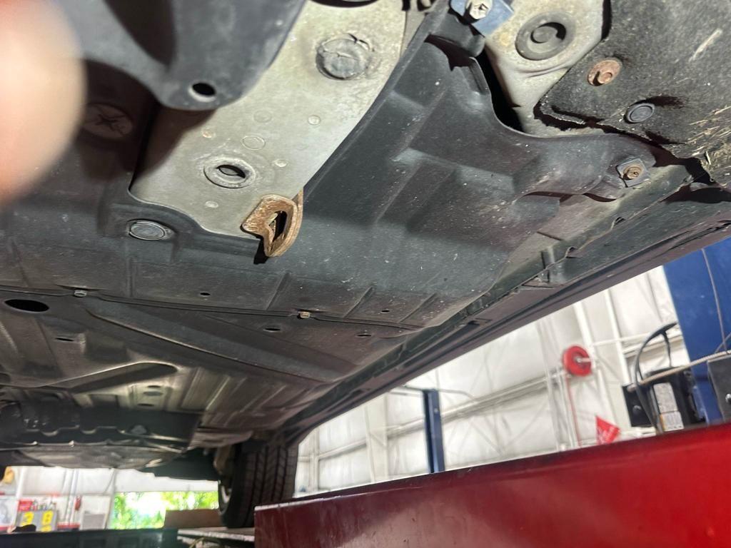

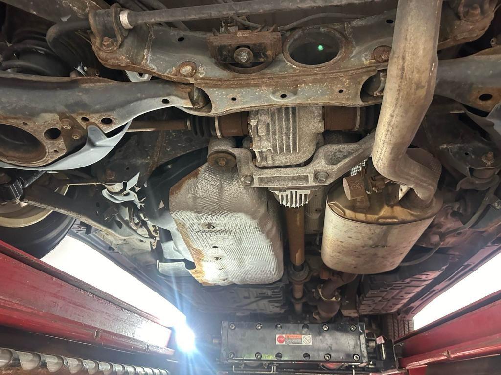

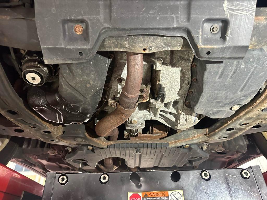

Was hoping to get some opinions about this 2010 RX 350. Too much rust? Or looks ok? First time buying a car and want this to last a long time!

looks ok for 2010.

I've seen much worse that is quite mild. For now. Apply Fluid Film every year and you'll never have rust issues, having said that my standard for buying any vehicle is no rust at all but I'm willing to travel several hours or more.

Depending on the price and your location. If you live in an area that has bad winters with salt on the roads yearly then I would probably pass on it as may just become a money pit a few years down the road to address the rusted out suspension.
If you live in an area that rarely have salt on the roads then you may get some use out of the RX before the rust get too bad.
I live in a southern state so I would avoid cars with that amount of rust to be honest. However, it do not look as bad as some other RX I have seen on used car lots from northern states. I would still walk away from it in my area. Toyota/Lexus do not do well with rust.

That rust is not very bad, mine is almost like that, just spray it with Fluid Film every year as advised above. You can buy it online or at Home Depot etc.
Just as important for a used vehicle that old are the miles on it and the maintenance history. What does the CarFax state? Where is the vehicle from? What state is it in now?
Go to this link, join the Lexus Drivers Site, enter the VIN, then go to the vehicle health area to see the dealer maintenance and repair history. The site can be cranky, but keep trying. https://www.lexus.com/My-Lexus/account/create-account

Rust is not big at all suspension elements are not a body. nothing to worry about. compare with Canada here it is worse and there are no problems. Price... it all depends on each car individually. for example 67 not 130 twice as much. a bunch of little things it is not known by whom and how it was repaired. if with a good service history then it is possible and high mileage. but if not then in 3 years you will pay different the same money for repairs. I would check the truthfulness of the mileage and bargain for 67. rather than looking for something cheaper and with surprises

That isn't that bad as far as the rust, as its pretty much surface rust.......As I'd clean it up the best you can & add a couple coats of Gloss black Rustoleum on all the steel suspension parts, I'd even do the alloy rear diff case as well.......!st is to replace the rubber oil cooler hoses w/ steel lines. I wouldn't care if they were replaced w/ new rubber ones either......Also good to do the bank one vct hose, as for some reason Toyota used a steel line spiced w/ a rubber hose unlike bank 2 uses a steel line.
