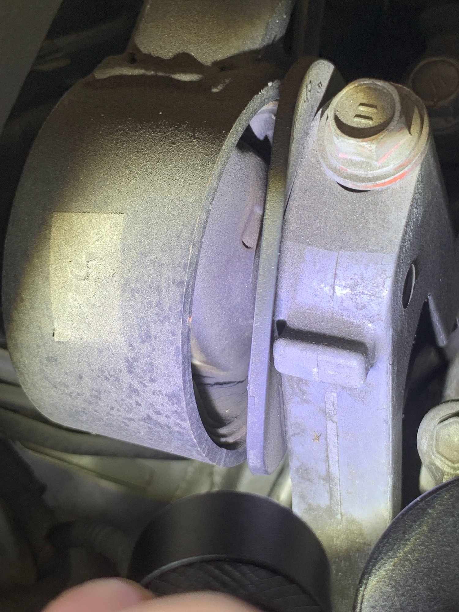

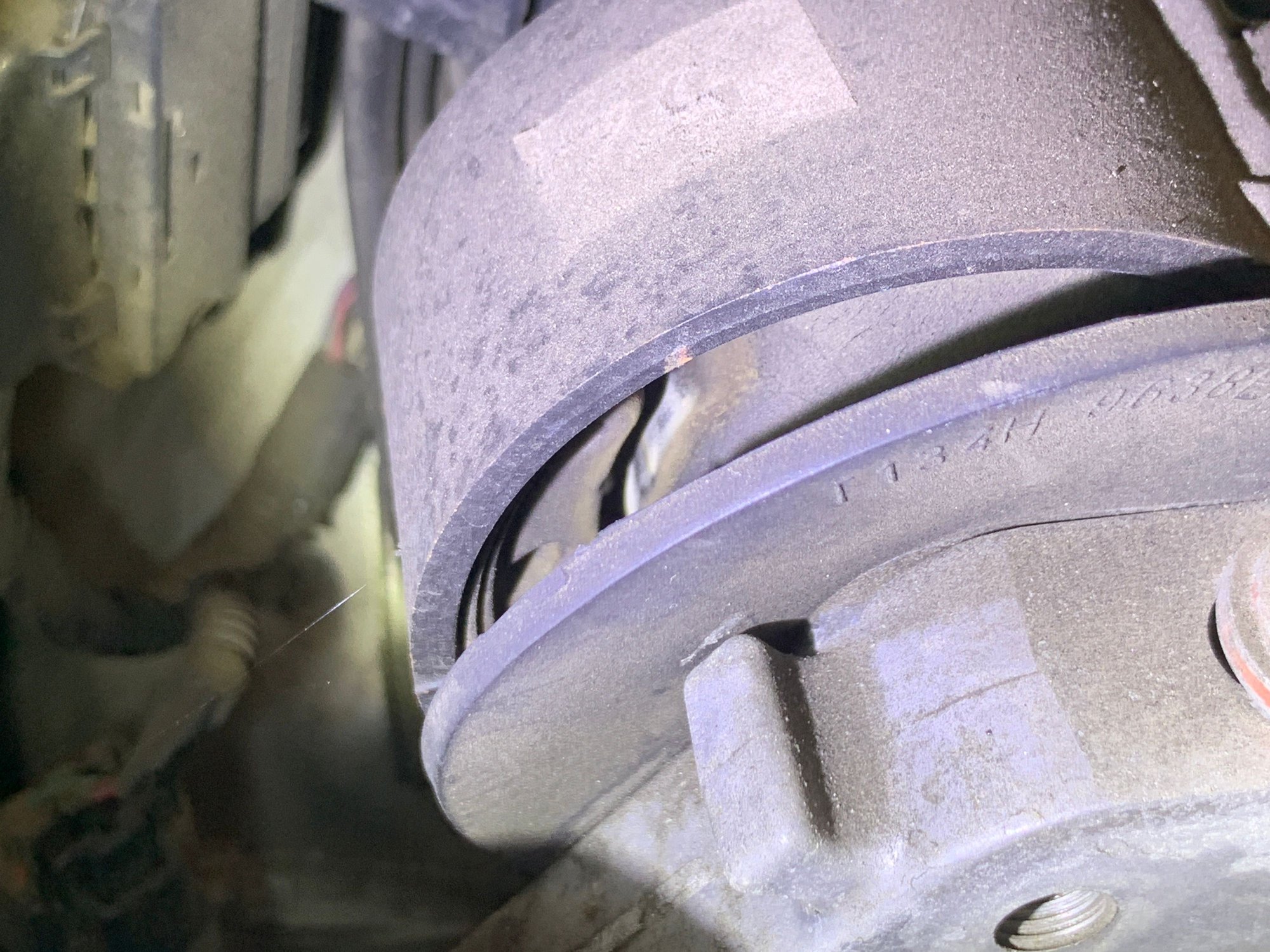

Old Aug 12, 2023 | 11:56 AM
ErickP's Avatar
ErickP
5th Gear
Joined: Aug 2023
Posts: 5
Hello again!
I just took these photos of the mount. From what I can see, there is some cracking in the rubber, but I cannot tell if it is fully separated.
Probably irrelevant, but I had a question about what the box at the top of the mount was? I found the part number 123630P120 (likely going to order through rockauto)
Also regarding the RPM, I don't think I let them settle fully before reporting the numbers. I checked again after the engine had reached operating temp and they were around 750 on all gear selections with the same perturbations when shifting.
Thanks again!

Old Aug 13, 2023 | 08:46 AM
salimshah's Avatar
salimshah
25 Year Member
Joined: Apr 2001
Posts: 16,570
Likes: 1,393
From: Austin, TX
750 rpm is a good number. If it is higher then the engine is producing more torque+hp and the shifts become harsher.
Box on top of what? For the lower mount, the electrical pulses are used to counter the engine force to reduce vibration ... almost like sound cancelling noise.
Salim
