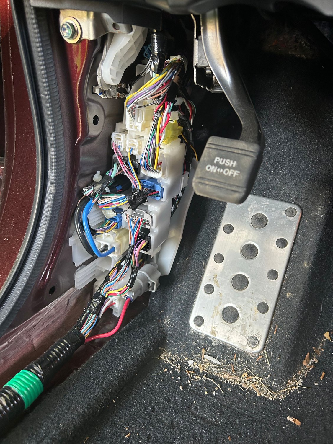

Thanks for the suggestions. The drivers side front drain was blocked. Ran a snake down the tube and all clear now! Lots of electrical connectors in the drivers kickpanel that would not be happy if they got wet!!
