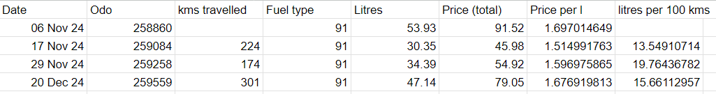

Being the dull man that I am, I have recorded all my fuel expenses since purchasing the RX (second hand). First fill on 06 Nov, with the majority of driving in urban stop-start traffic
Located Australia, NSW
