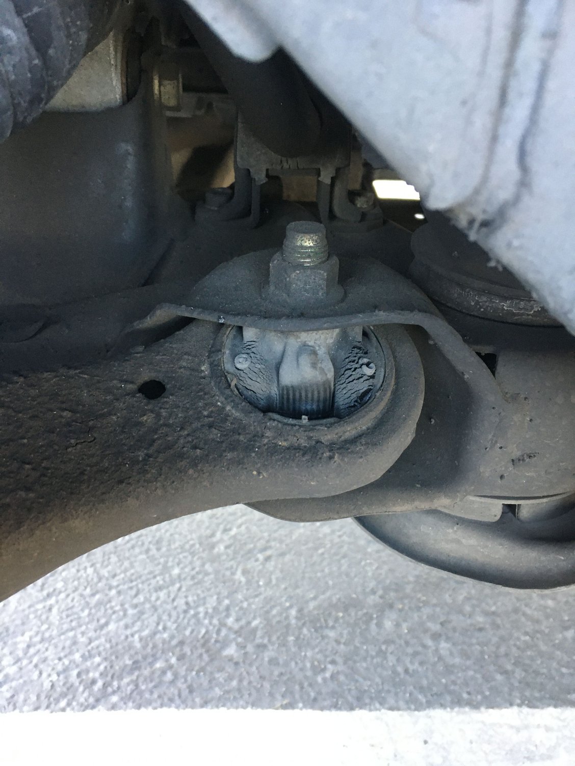

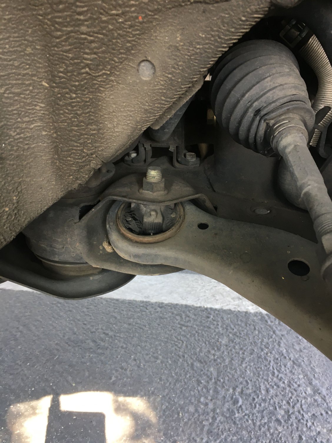

Thanks, I’ll look past the steering. Did you notice a big difference with new LCA? Mine are looking rough

That very well could be contributing to your vibes........Really best to replace the complete A-arm, vs that bushing. That'd also get you new ball joints as well & its quicker then trying to burn out the old bushings w/new.......Do both & be done.....

While the bushings will affect your ride, they won't cause the vibration that you are experiencing. Try taking the brake calipers off the corner THEN trying to move the bearing. I had one that I knew was going bad (by the sound) but neither I nor several professional mechanics could find it until I removed the caliper, then it was obvious.
