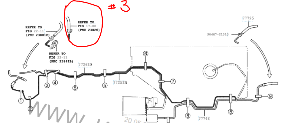

Originally Posted by iMSQ
I did it at a shop. #3 is the most loaded in EVAP
Not sure what you mean by “loaded in evap”. Did you get to it from above or did you have to go underneath and remove some things? please advise
Old May 20, 2021 | 11:00 AM
iMSQ's Avatar
iMSQ
Joined: Aug 2018
Posts: 999
Likes: 228
From: NM
hose # 3 is a "connector" between hose #2 and EVAP pipe under car. #2 is fixed to engine, pipe is fixed to car bottom. engine connected to car body by frames and bushings, so engine could "shimmy". That's why I wrote "#3 is most loaded"

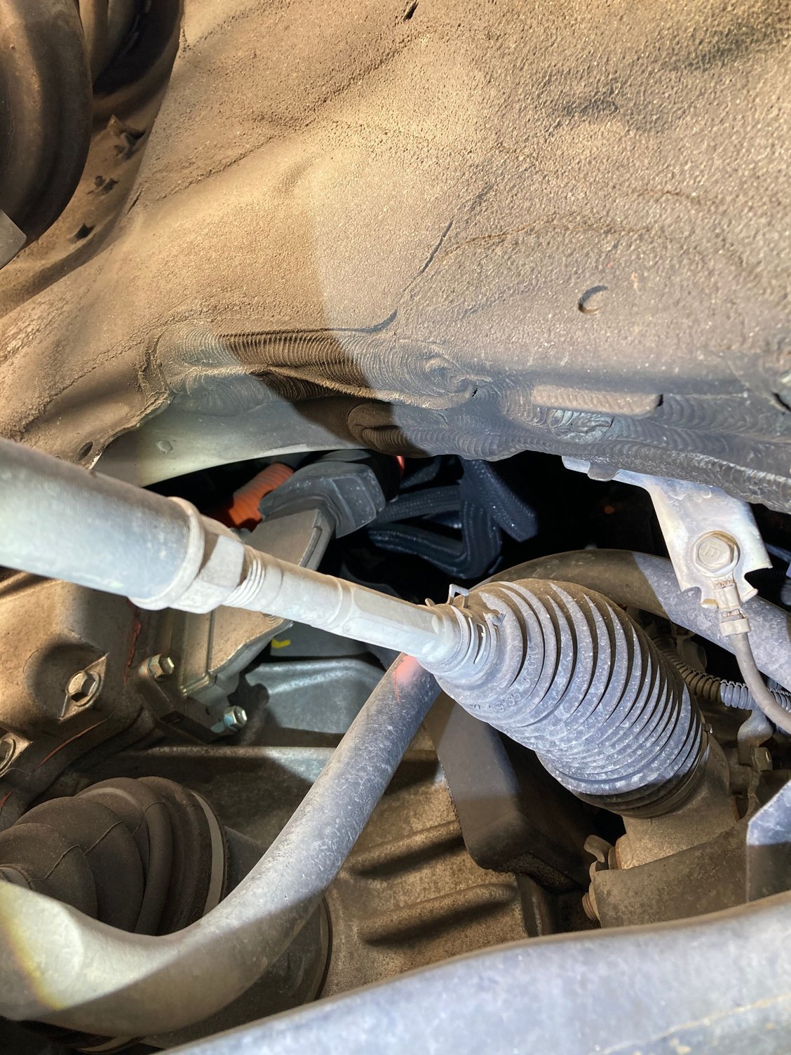

Thanks for explaining that but that wasn’t my real question. My real question was how did you get to the hose number three from above or below and did you have to move or remove engine bits to get to it?
Old May 20, 2021 | 02:00 PM
iMSQ's Avatar
iMSQ
Joined: Aug 2018
Posts: 999
Likes: 228
From: NM
It looks that lower end of #3 is accessible under car (try to lift drivers side and take off the tire). No engine movement required
Old May 20, 2021 | 03:53 PM
bcolins's Avatar
bcolins
Joined: Mar 2021
Posts: 127
Likes: 42
I jacked the car up and pulled the wheel and got underneath with a good flashlight and it does not look very promising in terms of getting to the bottom connection to that hose without probably removing some things that appear to be hybrid related. Also decided to go ahead and check the vacuum at the service port,..I vacuumed down to -25 and came back five minutes later and it had moved to -23 so I lost 2 pounds of vacuum in five minutes. That said I simply stuffed some vacuum tube into the evap service port and then stuck the other end on my brake system vacuum pump I doubt that the service port / rubber tube is 100% sealed.

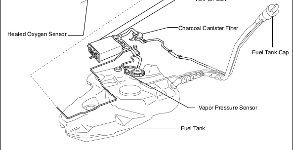

I have an annoying "small leak" evap code popping up randomly for a while now too and I haven't had the time or patience to deal with locating it and I have no smoke machine either so interested what other people find.
Just looking under the car the evap canister is not in a fun place- over the exhaust and behind a heat shield so rather not go there if I don;t have to and hoping the leak is somewhere else more accessible.
FYI, Phil, The evap canister is really easy to get to, jack up the right rear of the vehicle & drop the rear of the exhaust, starting at the tail pipe & then the muffler & next the evap sheild & there is the evap canister.....
Old Jun 3, 2022 | 01:23 PM
Margate330's Avatar
Margate330
Posts: 11,196
Likes: 1,582
Thank you for the encouragement felix.
I got a little more lucky than you and was able to fix the code at the rubber lines under the hood, this time.
I know the day is coming the same code will get thrown again and I will have to do as you say and drop the exhaust and dig in there and replace the rubber lines at the gas tank evap components.
When I went under the car I wasn't sure if there was enough room to work without unhooking the exhaust or if I can just drop it down out of the way but from what you say it is doable if needed.
Space looks tight and info isn't very clear on the layout and exact location but I know it's under that heat shield and that's as far as I've gotten.
