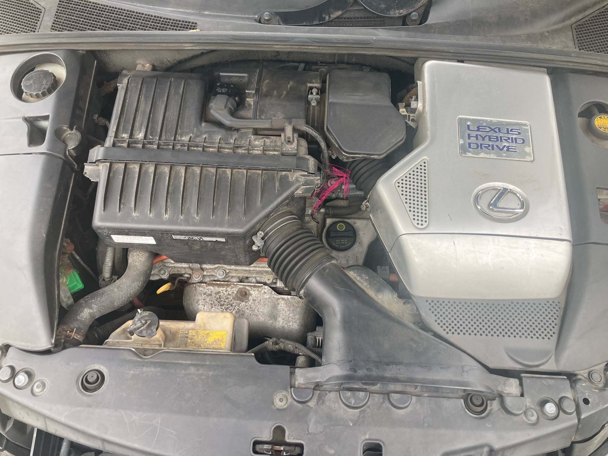

Does anybody have a picture of the exact location of the EVAP hoses in engine bay of a 2008 RX400h? The engine setup in pictures in this thread looks a bit different than in my vehicle and I am interested in inspecting and perhaps replacing those hoses. Are they under air filter box? if so, is it easy to remove box?
This is related to a recurrent (random on and off) engine light/P1001 code (already replaced gas cap and mass sensor with OEMs), so I am guessing there must be leak somewhere.
Yes, you need to remove the airbox. Its very straight forward/easy task. All 10mm nuts/bolts if memory serves. My hose that traveled back behind the engine and down was split. I also replaced the purge valve. All good now.

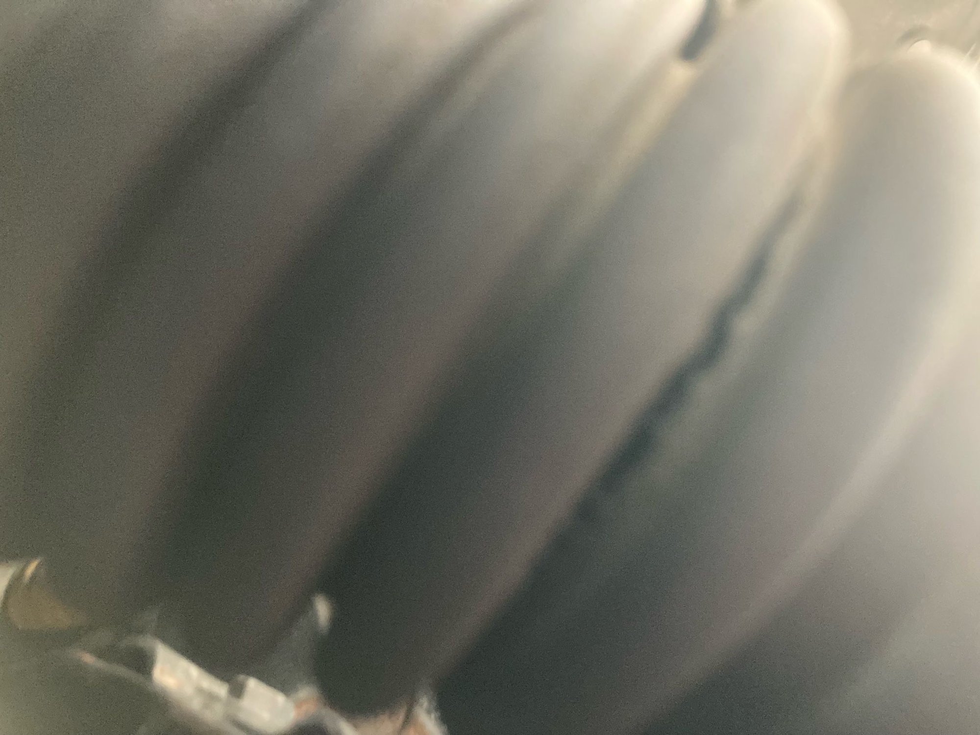

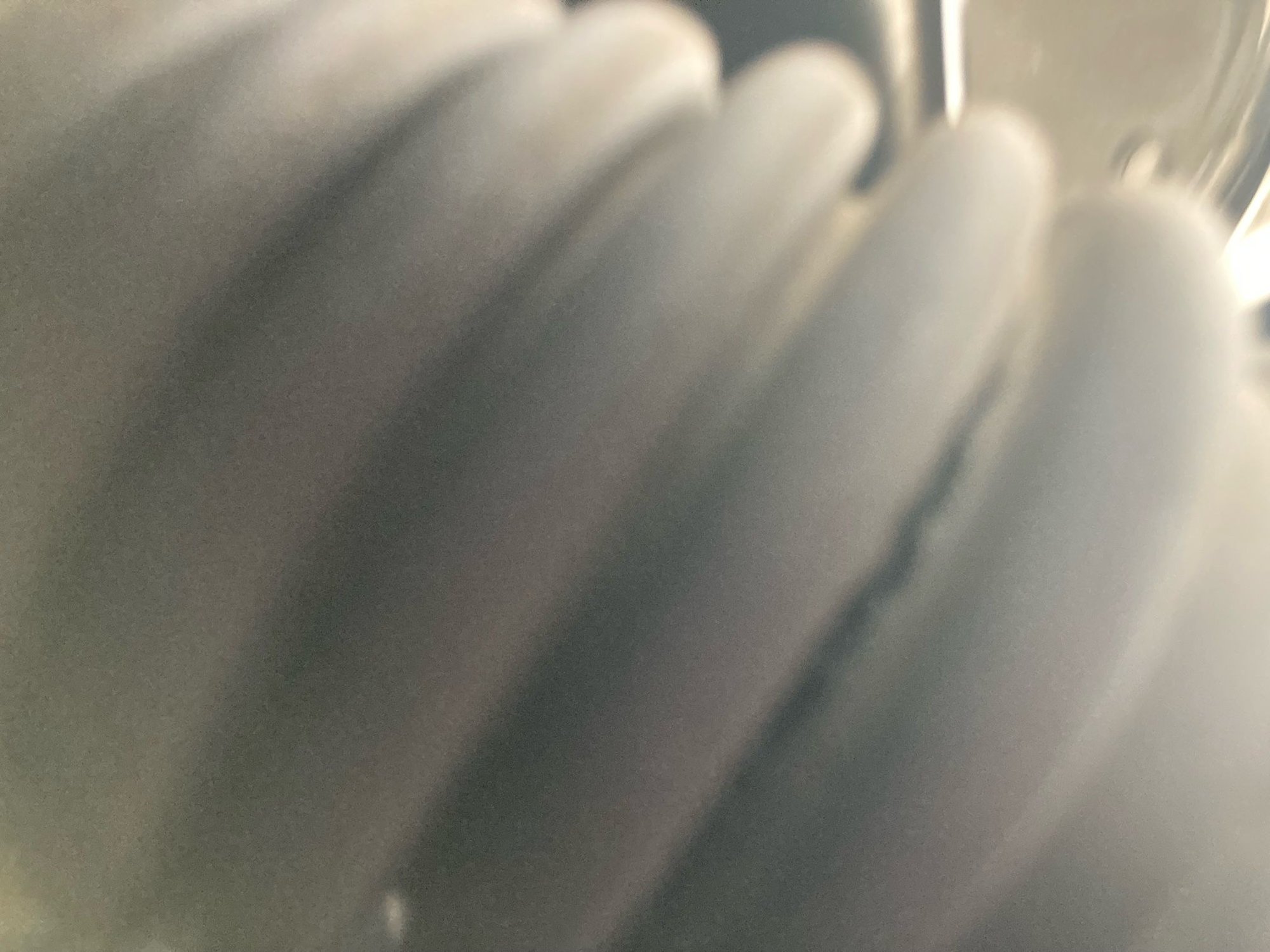

Hi there,
I was in the process of removing the airbox to access vacuum hoses to replace as needed cause of codes P0101/P1420, and I found a tear of a big hose on right side near canister (see image). Sneaky tear since it underneath the hose in one of the depressions. I would like to replace this ASAP, does anybody know the part # (2008 RX400h)? can I replace just that segment of hose leaving rest of element intact or is a whole piece all together? also, can I replace this part without removing other things around (besides hose brackets obviously) thank you so much in advance!

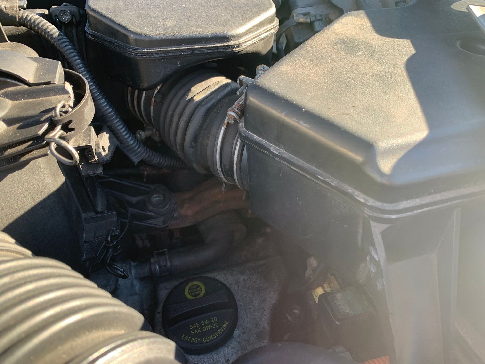

Default #2 under that flat black thing is the hose that’s leaking on mine. How do I change it
Originally Posted by iMSQ
I marked hose #1 from first post image
PS: I had a problem with #3 first (goes down between engine and cabin), and #2 cracked in my hand when I pulled it
so how do I remove the hose under that black flat thing on #2 ?
