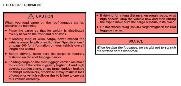

The owners manual for my 2007 says "Do not exceed 165 lb. (75 kg) cargo weight on the roof luggage carrier."

Echoed to DennisMik mentioned above, my 2005 RX330 owner's manuel said the same 165 lb max..
