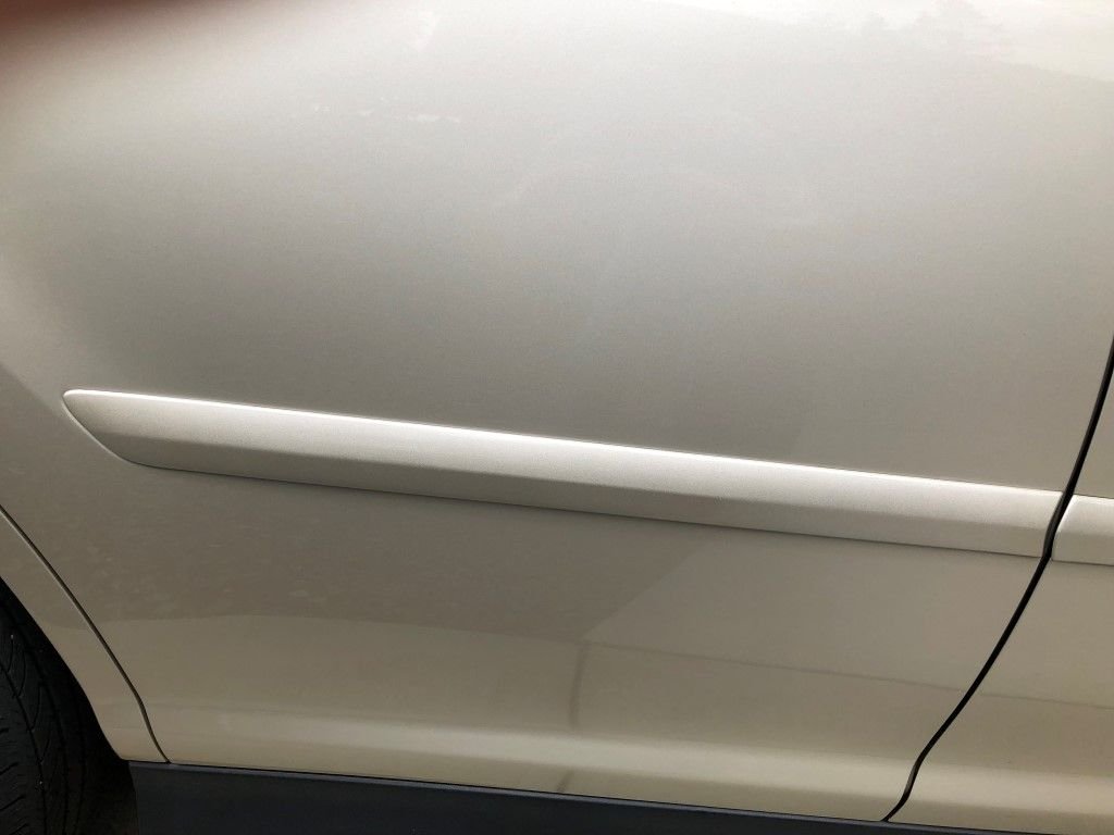

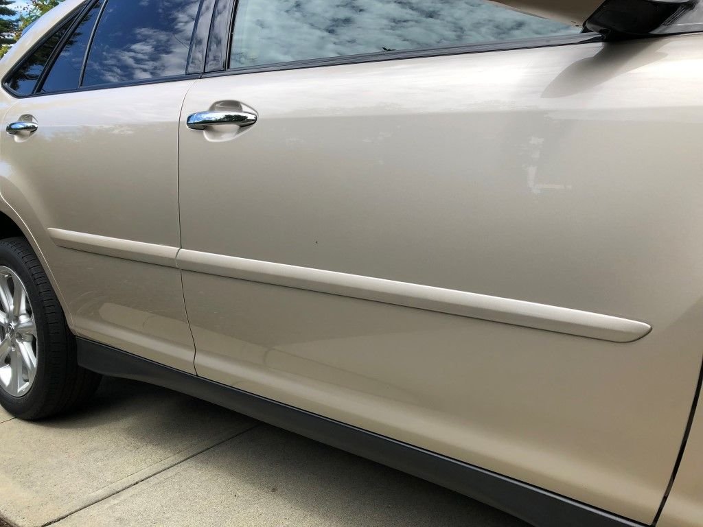

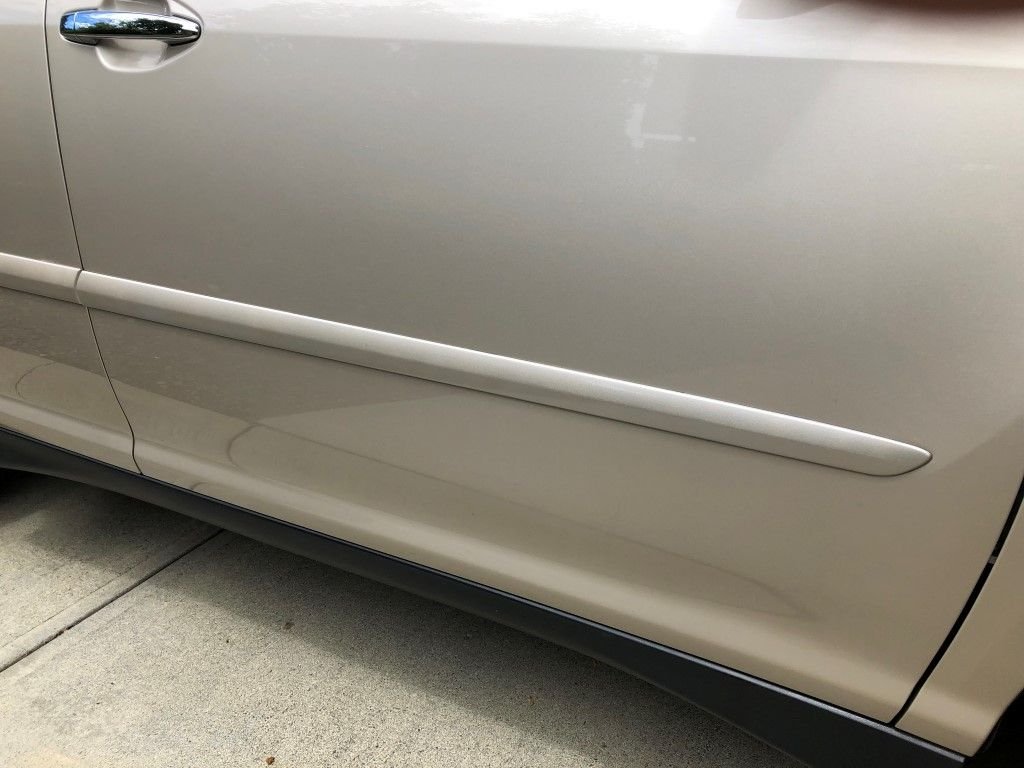

I repainted my side moldings about 6 months ago. I left them on the vehicle and just masked them. Prior to that I sanded them with 120 grit and 220 grit and cleaned off the sanding residue. Then I masked and sprayed on a flexible primer where necessary. FinallyI sprayed on 3 coats of color followed by 2 coats of clear coat. The end result was that the moldings looked like new again. Unfortunately I've got a couple of new dings already. Bob

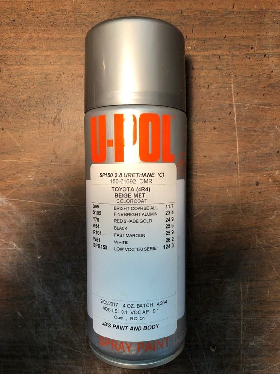

Also what brand of paint did you use to paint them with?

I didn't take any before photos or even of the actual painting process. Just forgot. But attached are a few photos of the end results on the passenger side.
As far as the paint is concerned, I went to a local paint shop that specializes in making automotive paint in spray cans. They took my paint code, asked me how much I wanted, and 15 minutes later I walked out with the paint. I just used an off the shelf clear coat that had a high rating in the reviews I looked at.
Hope that helps.
Bob
