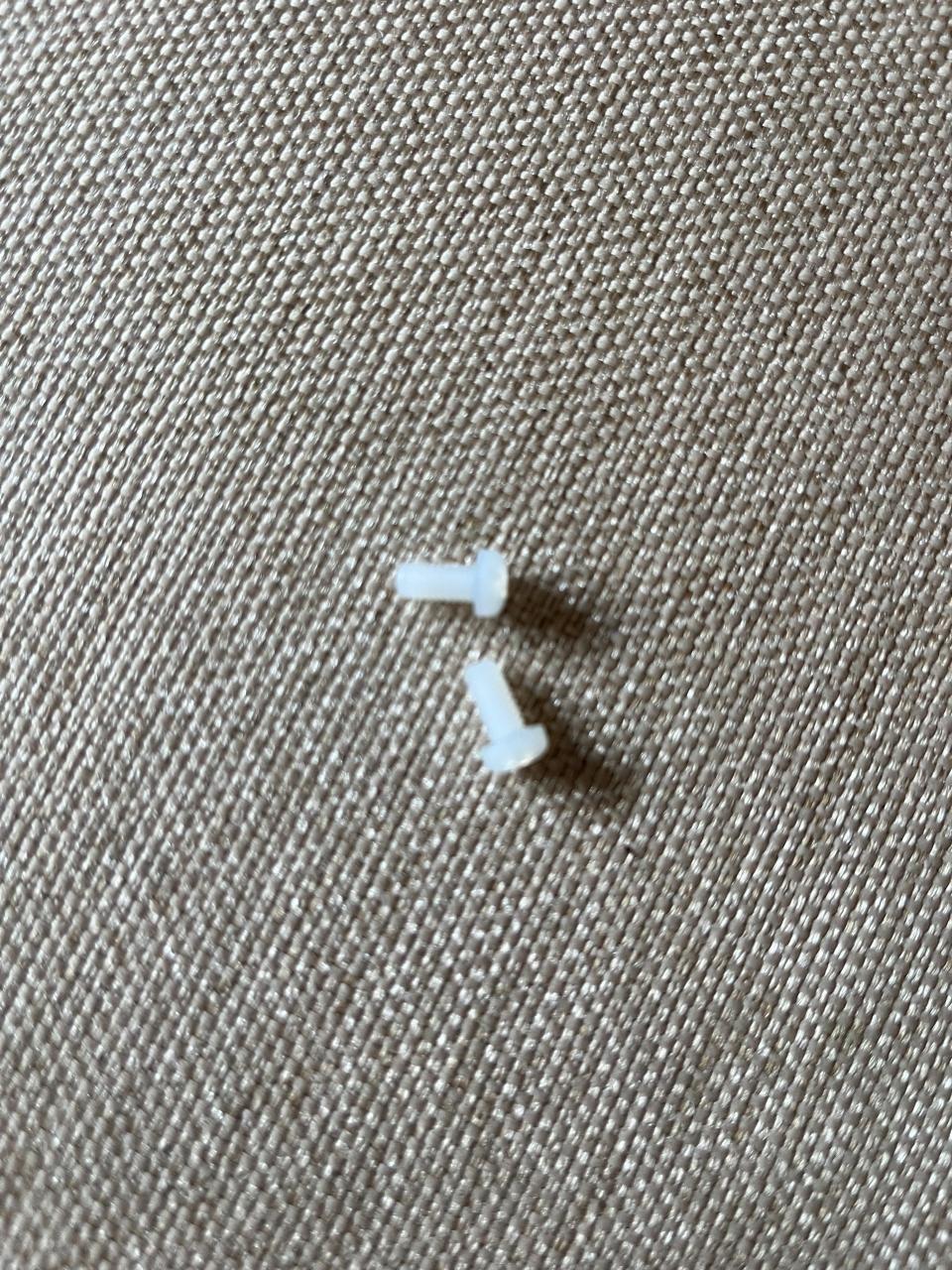

M4 8mm nylon bolt works perfect
Old Jun 2, 2025 | 11:02 AM
  #37
Byron43's Avatar
Byron43
1st Gear
Joined: Jun 2025
Posts: 5
M4 8mm nylon bolt is a perfect fit and cheap.

M4 8mm nylon bolts to fix Temperature Switch
Old Jun 3, 2025 | 07:42 PM
  #39
Margate330's Avatar
Margate330
Posts: 11,198
Likes: 1,582
Good job, thank you for posting your fix!
