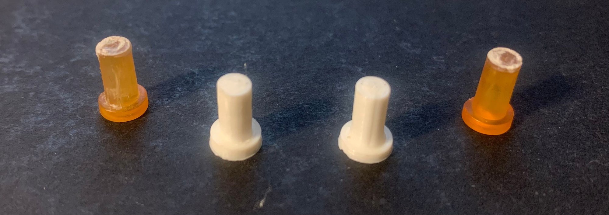

New to the forum, I had this problem with my 2004 RX330 and read everything I could find on the problem. I started with Bajan's dimensions and measured an unbroken part from my car, drew the part in Tinkercad and printed it on a 3D printer. The result is not perfect but it fits and seems to work fine. Here is the link to the file on Thingiverse: https://www.thingiverse.com/thing:6340598
Enjoy
Enjoy
Awesome job friend.
Those look good.
It's hard to tell from a pic but if you feel like it and post a pic with it next to a dime or something that would be cool, just to show some size reference.
For anyone who hasn't seen these, they are teensy tiny.
Even at $20 a set it would be a steal just not to have to make them but at $70 a set, come on now. Haha

Here is an updated picture with a "dime" for reference.
