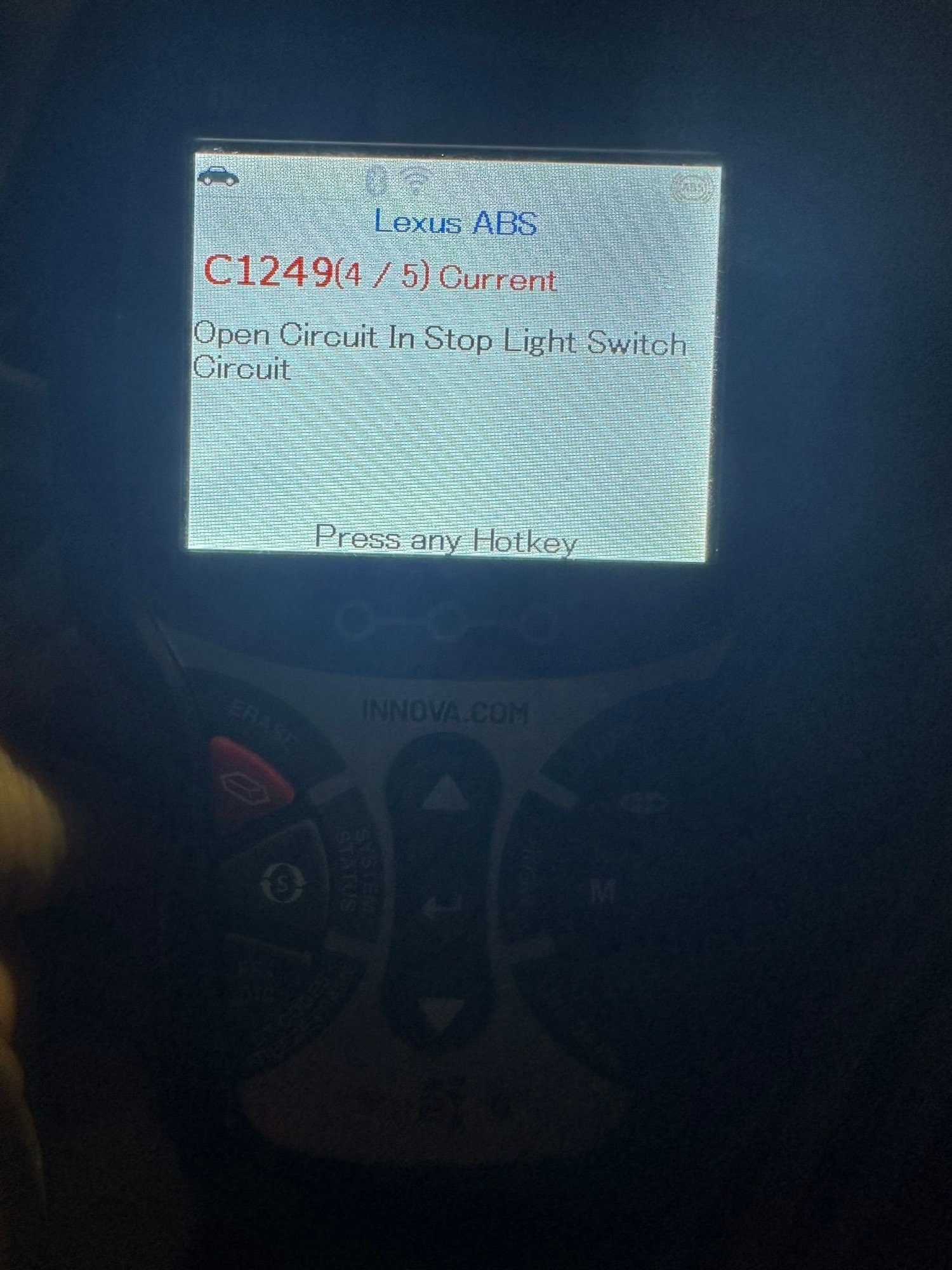

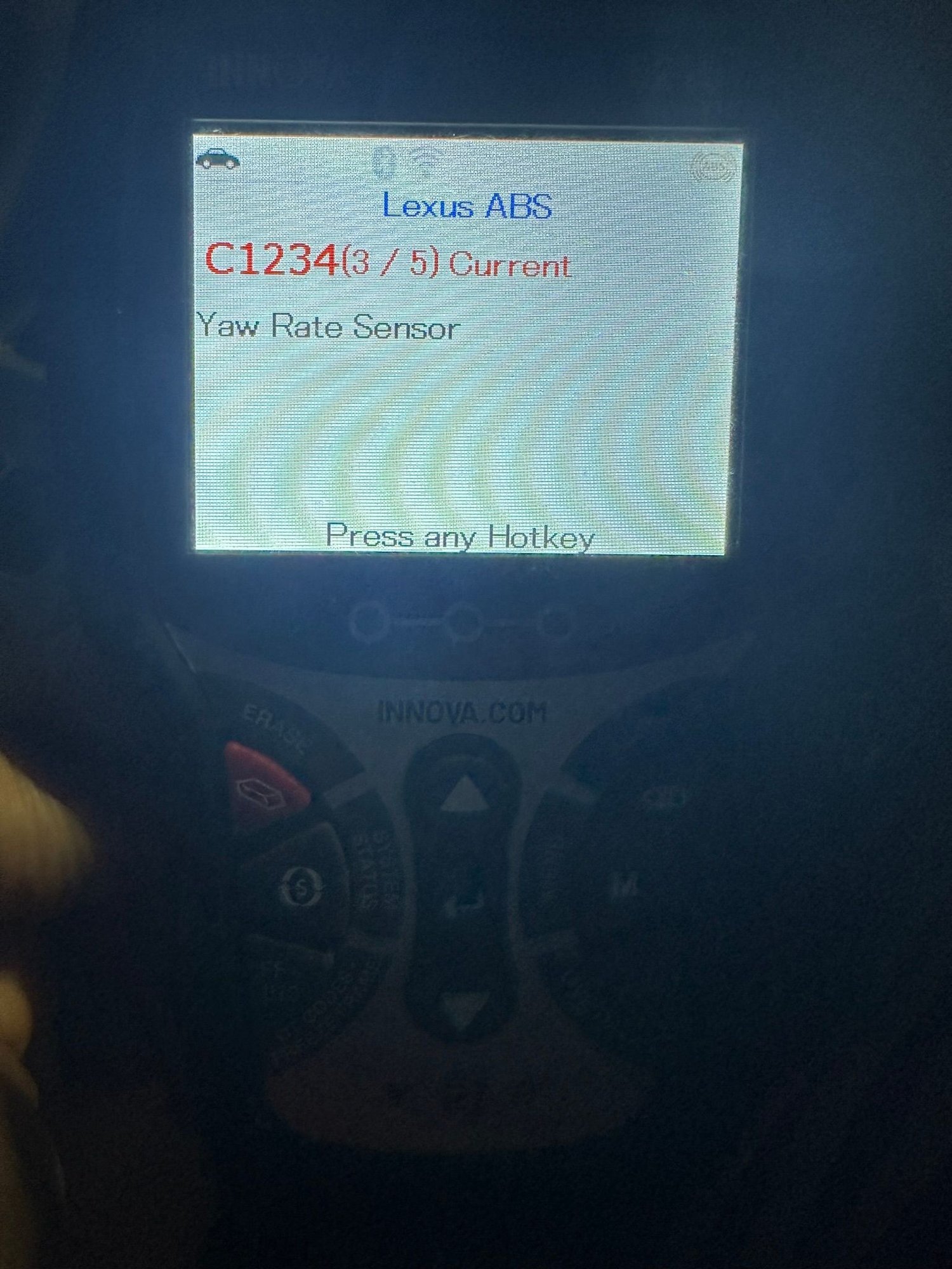

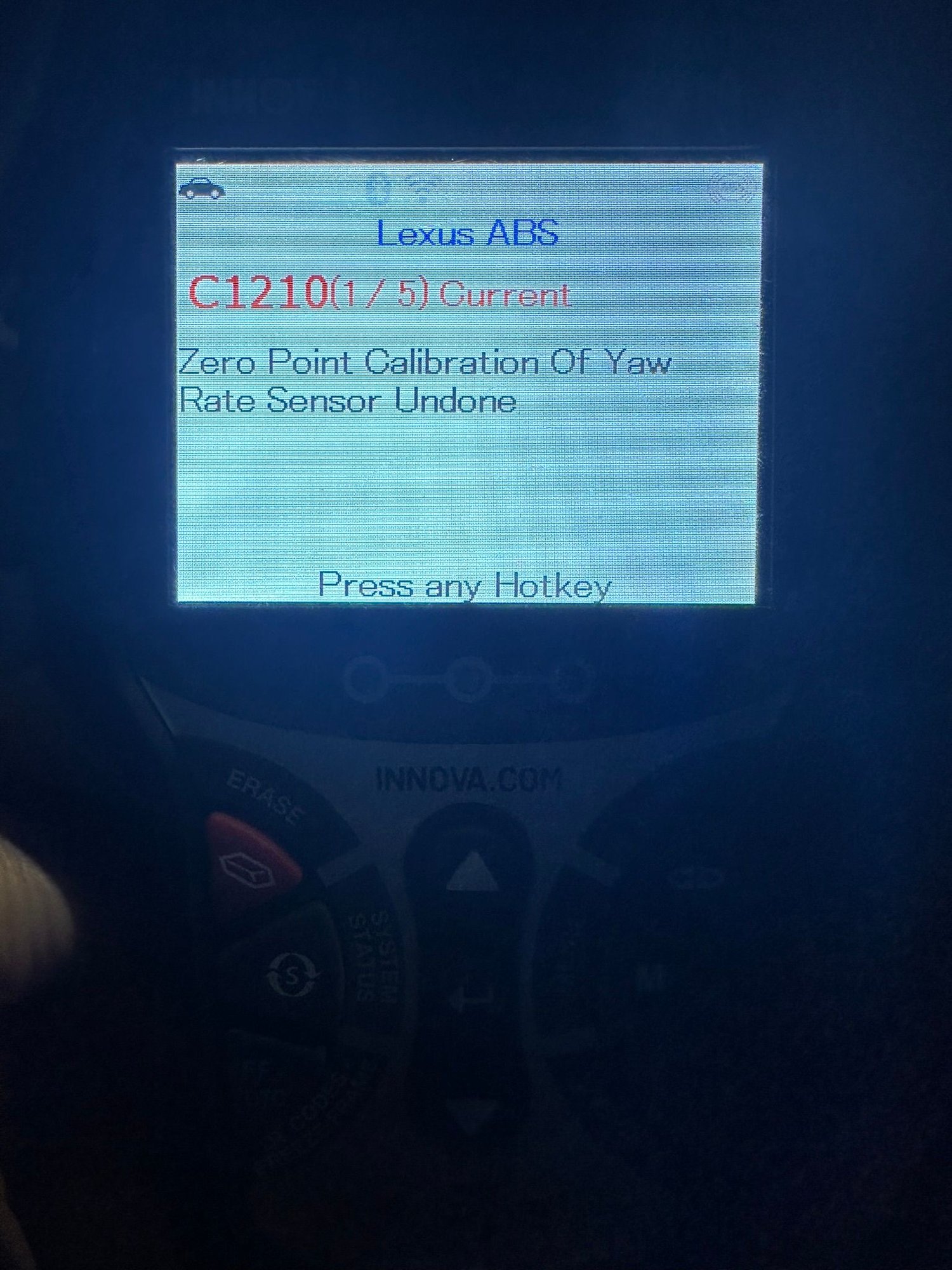

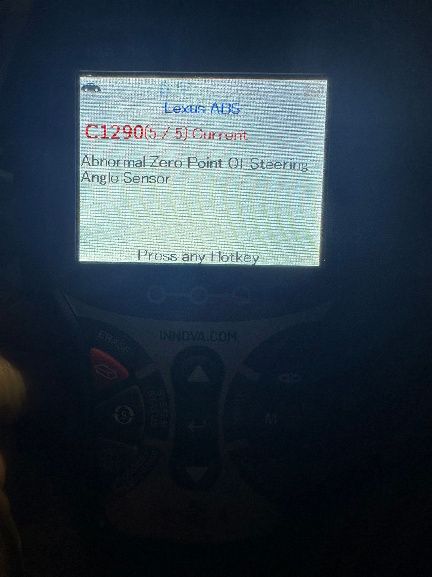

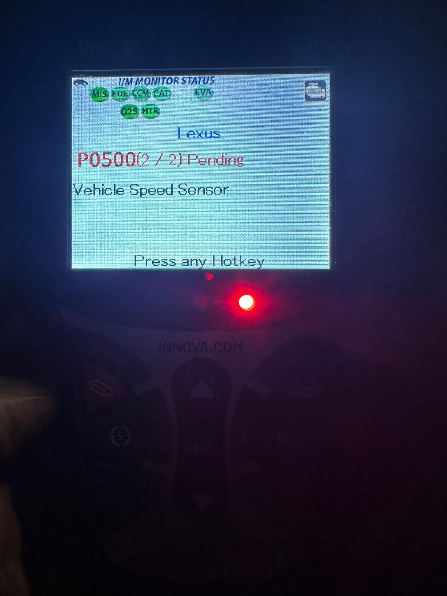

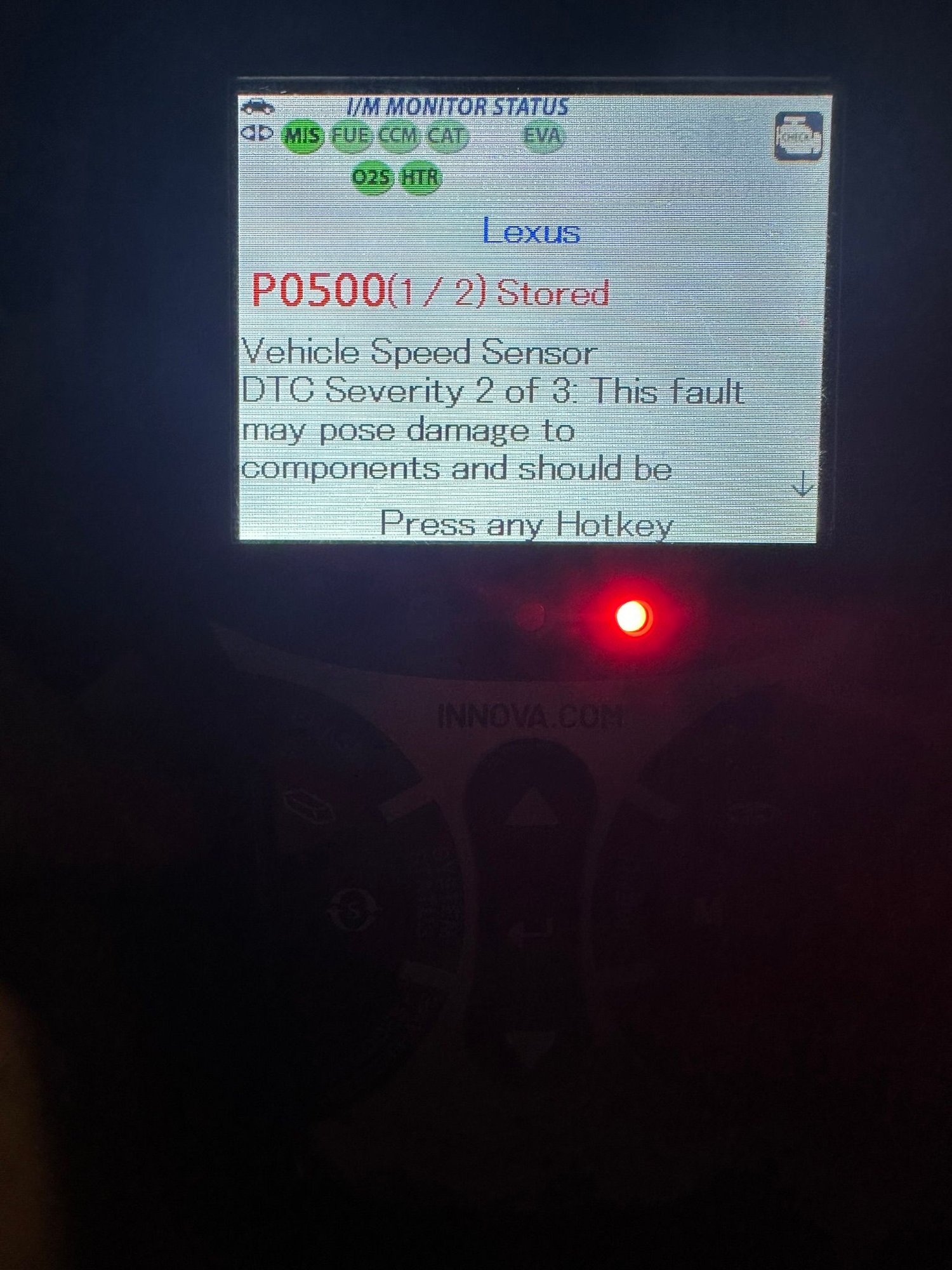

Today while driving the car a few miles from my house running errands I was pulling out of a small parking lot area with a bit of an incline and as I went to accelerate out the car made a loud noise (hard to describe but sounded like I hit a curb on a car barely bumped into me) obviously neither of those things happened but the car would not accelerate. I noticed my check engine light came on and I put on my emergency flashers and put the car in Park. Turned the car off and back on and tried to put it into drive again but same results, the RPM's would go up but the car wouldn't go forward, it felt as if it was in neutral and started to slowly roll backwards. I got the car to a safe parking spot and checked the codes, I'll upload all those below. Based on my reading so far it seems like the P0500 is kind of a bogus /red herring code. I do have some ABS codes that popped up as well. The main things that I've noticed so far is that the car would roll forward while in Park so had to set the emergency brake to prevent that. Also I am able to shift between the gears of P-R-N-D etc and the lights on the cluster are illuminated and change.
My first thought is that something internal in the transmission failed. I really hope this isn't the case, just wondering if it could be a shift cable or something else. I'm not a mechanic by trade but I have done some decently sized DIY jobs in the past. I would greatly appreciate if anyone was able to give any helpful troubleshooting tips or dealt with this situation or something similar in the past.
