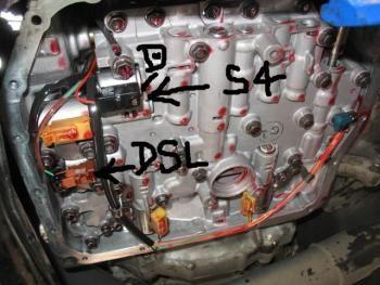

Below is the Diagram showing the location of all the Solenoids.
P0765 - Shift Solenoid D Malfunction, Solenoid S4 on the Diagram.
P0770 - Shift Solenoid E Malfunction, Solenoid DSL, or Lockup Solenoid.
Solenoid S4 is responsible for Overdrive operation, Solenoid DSL is responsible for Torque Converter Lockup. If I am being brutally honest, it doesn't seem like the car was well taken care of, so there is a chance that this is a result of poor maintenance, and a set of new solenoids likely won't bring it back, but it's really hard to tell anything without actually seeing the car in person, so don't take my word as a verdict.

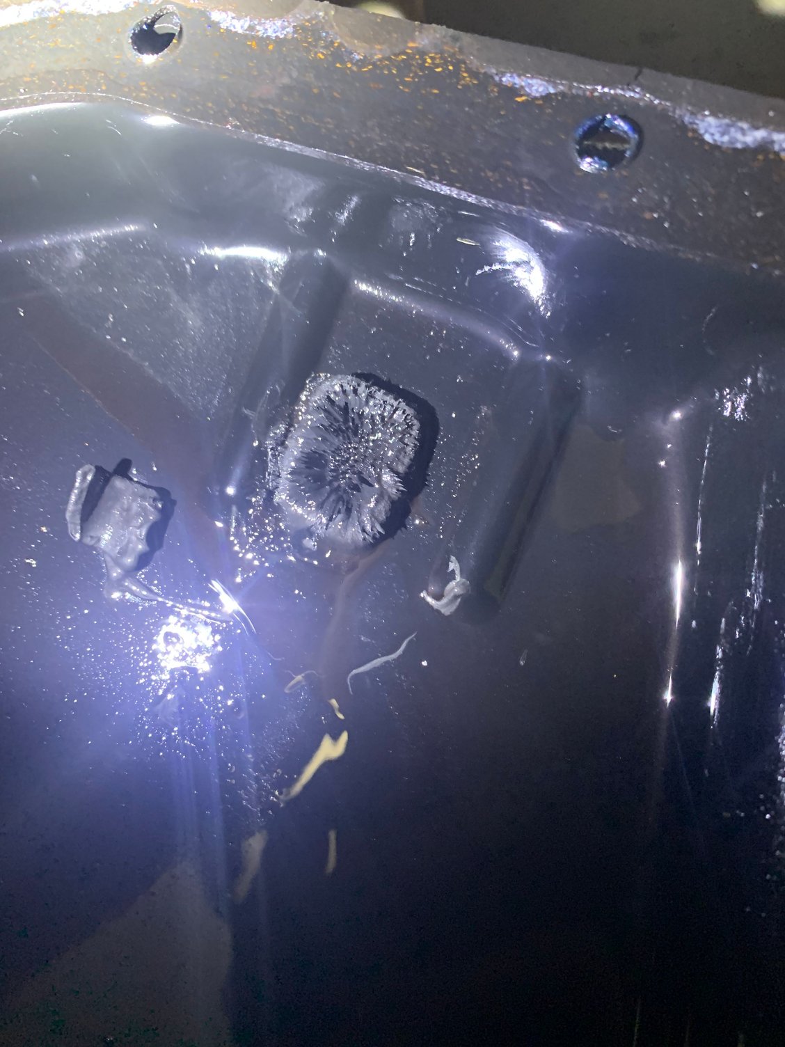

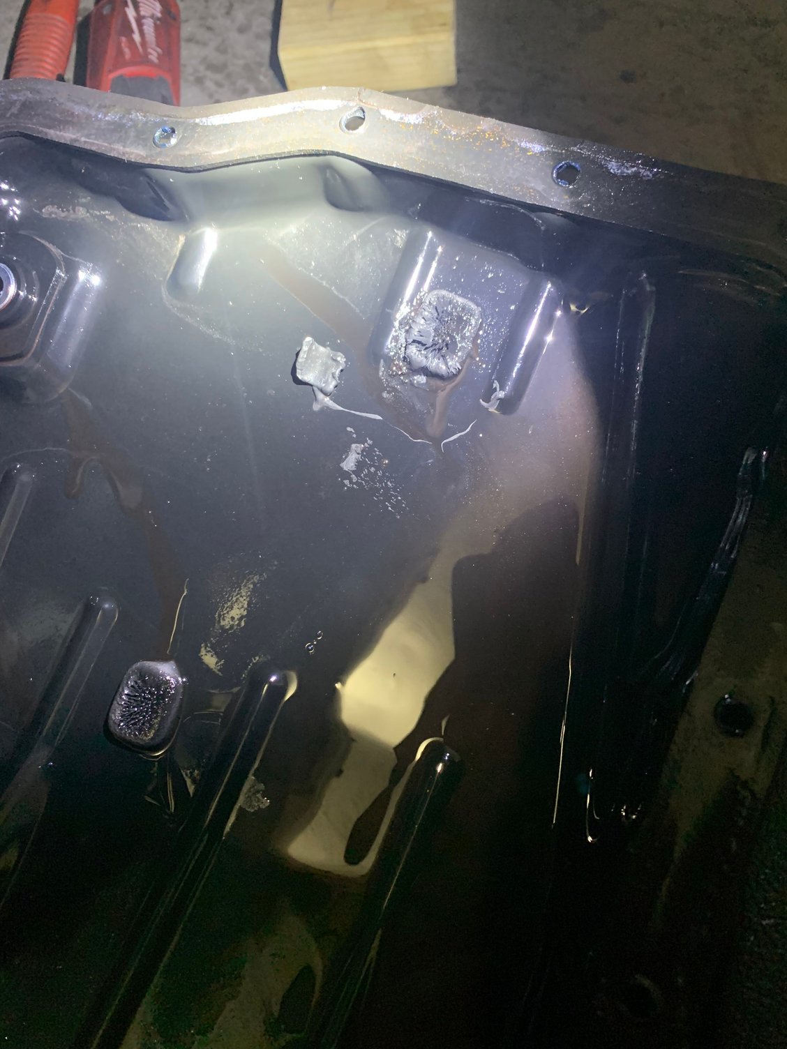

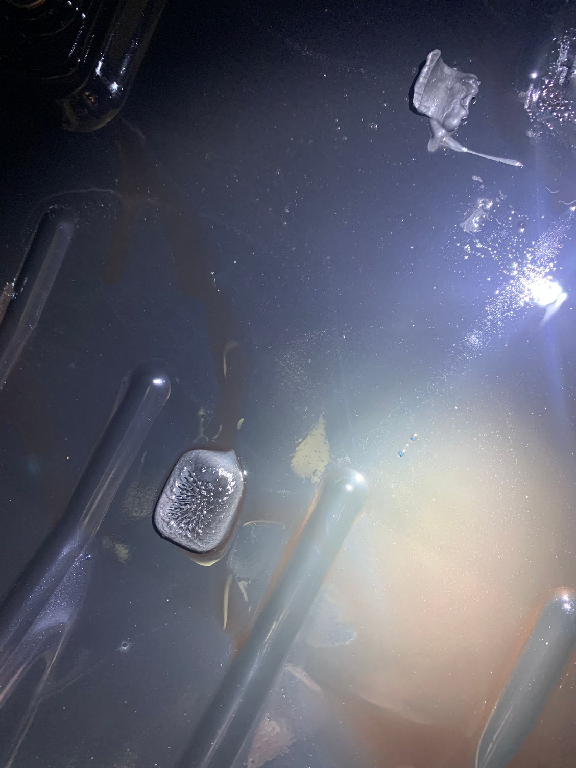

Yeah it’s not very well taken care of. The engine oil level was way over the min at cold temp. See picture below, blue mark is indication of oil level at cold. I am wondering if it being over filled might have damaged the engine?
See pictures for how the pan looks like with magnet. Looks like there is a lot of metal residue and I think a piece of the solenoid E bracket broke off.
Blue mark is oil level at cold temp
Left of magnet is broken bracket
That doesn't look .. promising frankly. It is not a very good sign when you see actual chunks of the transmission falling out of it as it really doesn't happen without a very good cause for it. Now it's the question of whether it's even worth moving forward if the transmission is in fact toast, considering the overall condition of the car.
Hope this helps and best of luck!
