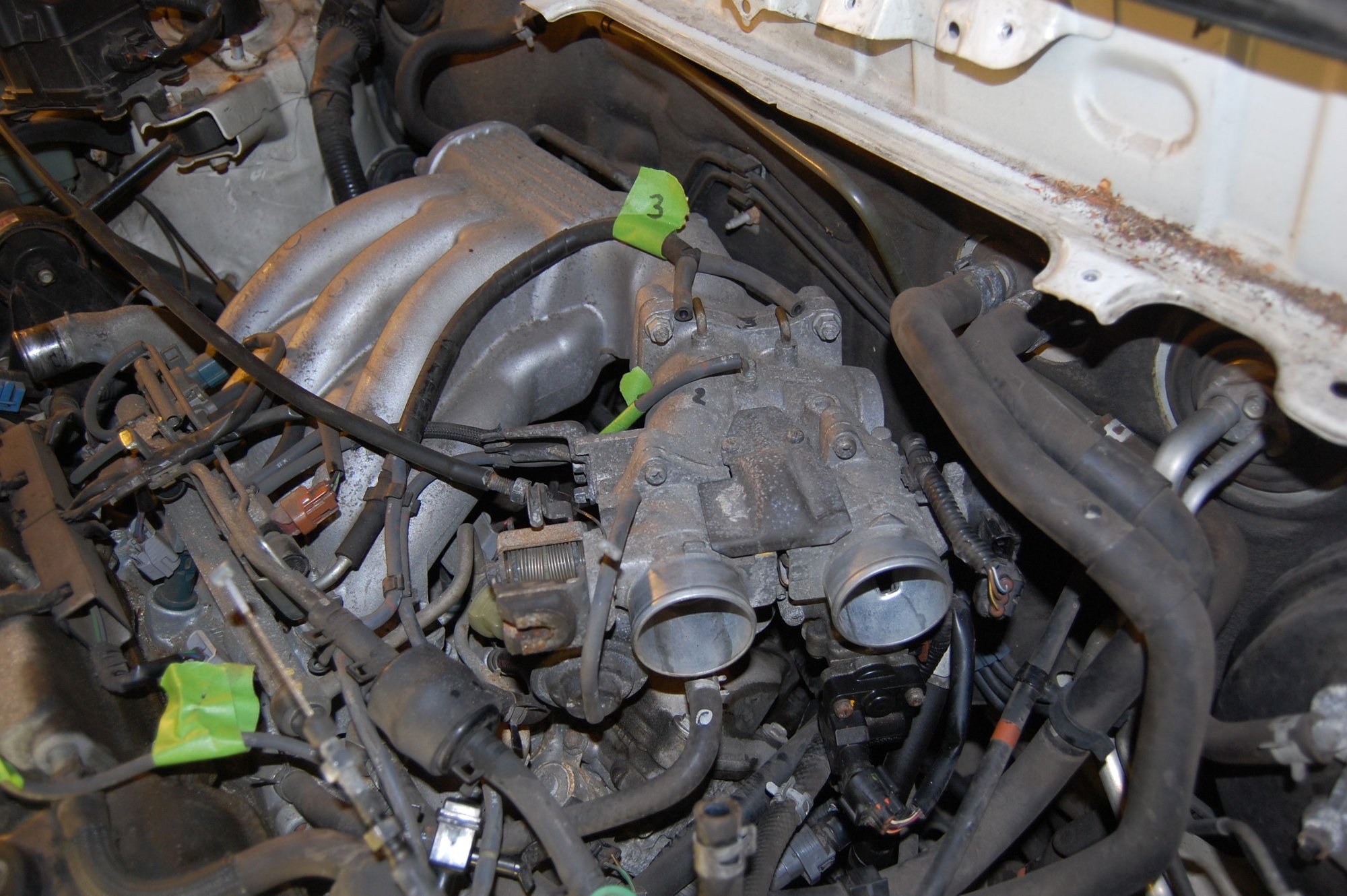

Here's a photo of lines going to the throttle body
