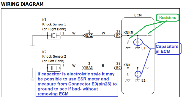

Here is some cool stuff for anyone who wants to take it further.
Not a schematic but a simple drawing showing a capacitor inside the ECM- might be able to use an ESR Meter to test this cap without removing ECM(battery and sensors disconnected and observe proper handling and ESD precautions) for someone skilful with electronics if the capacitor is electrolytic style.

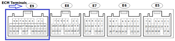

* Capacitor ESR Test Note- ECM Connector E9(pin 27) to ground for Knock Sensor Bank 1 and then ECM Connector E9(pin 28) to ground for Bank 2. You can use Connector E9(pin21 or pin 31) for ground for this test according to the ECM Pinout. This test will only work for electrolytic style capacitors- ceramic capacitors fail differently and this won't usually work- resistance test will be better for ceramic style(in circuit) or pulled from circuit board to test properly but would require opening ECM but ceramic style capacitor rarely fails(a unicorn) in an application like this but who knows but I suspect it is a ceramic but not sure. Can also check circuit resistance comparing bank 1 to bank 2 for a "go/no-go" test to rule out possible ECM input circuit issues located at the 2 input resistors inside of ECM as shown below.
Reply 2
