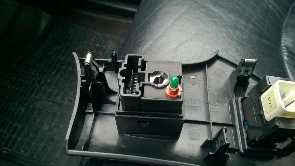

I just checked on my car, and found that the mirror switch should be lit, but it is not.

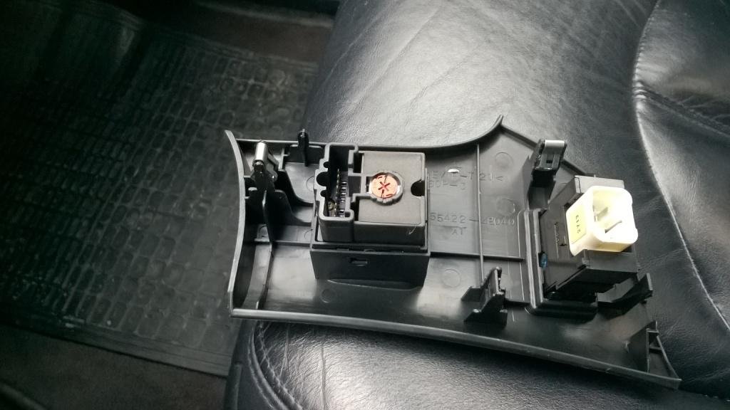

I dissasemble the unit, and there is a bulb.
Here is the culprit.

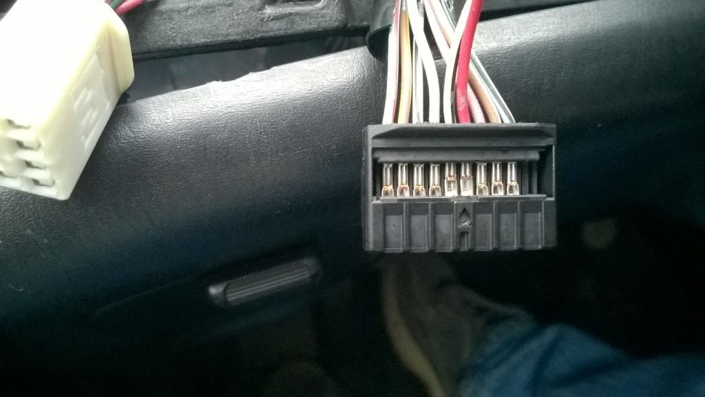

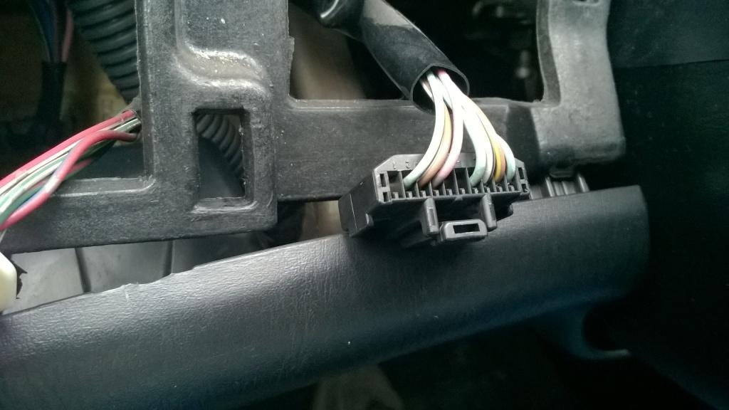

I tested the bulb, and it was working. Then I started to look for another problem, and found it. For my surprise, the connector was missing 2 of the pins (the 2 missing in the middle) for the bulb, and the cabling as well.
I went to the car breaker and got one connector from the central console of Yaris. Took the pins out, and put them in the connector.

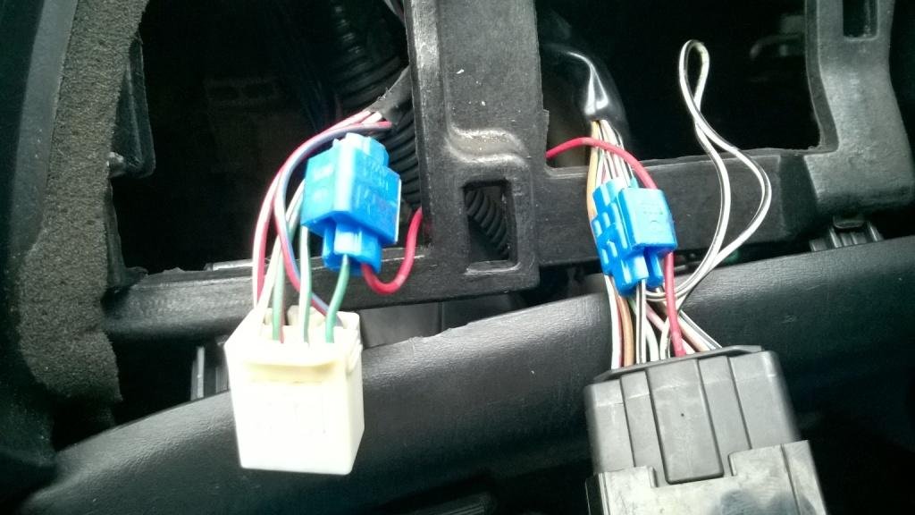

And here is the connection. The ground is connected to the ground of the mirror switch, the "+" is taken from the light bulb from the leveling switch.
And now I have the switch lit up.

On Lexus, the cables an the connectors for the units that are not factory-fitted, are missing.
