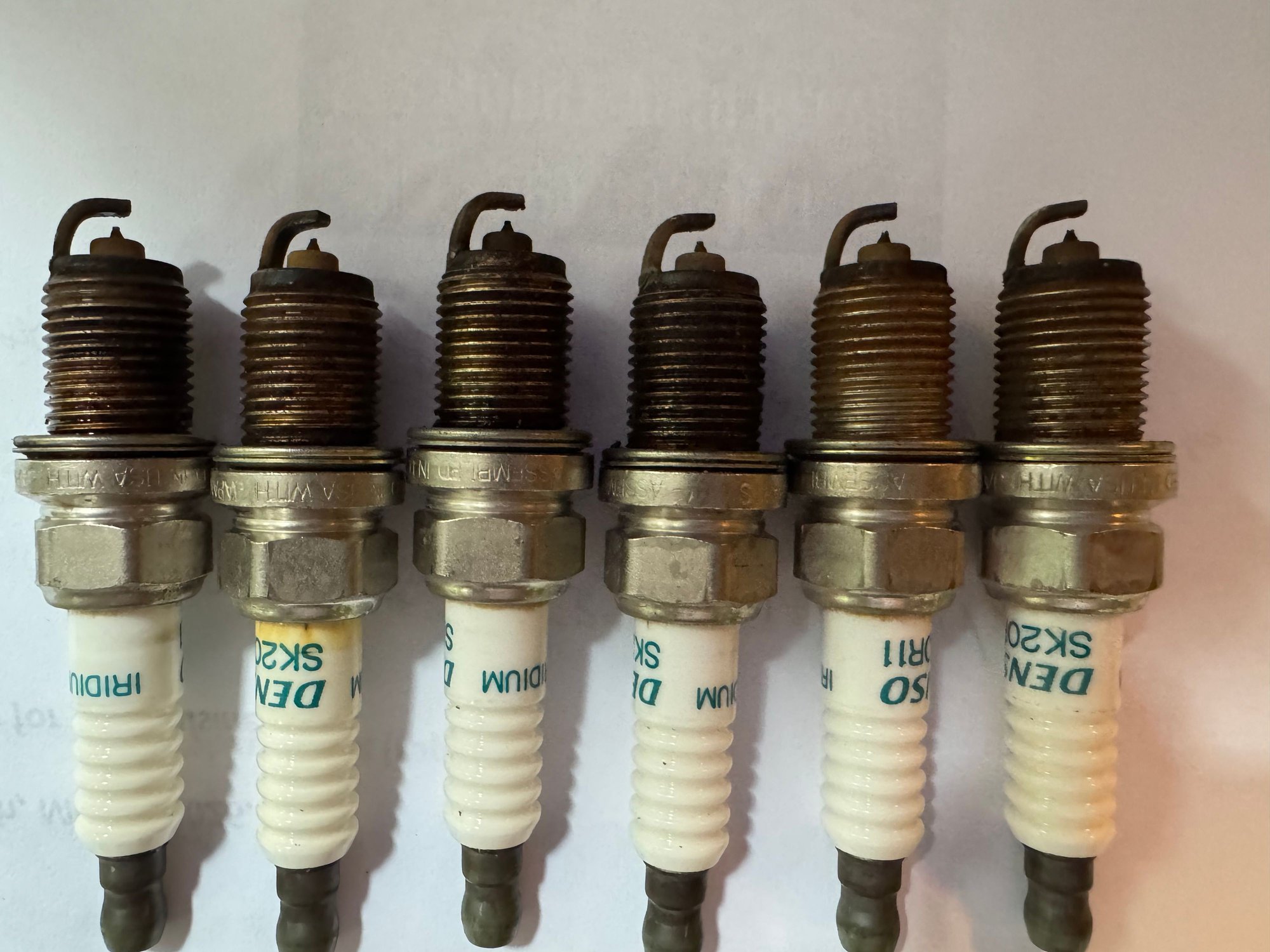

Got the plugs from Rock Auto in the mail and installed them this morning. I don't think I'll be doing that ever again!
The old ones looked fine after 130,000 miles. Sheesh, did I need to change them???

Here are the old plugs. Gap may be a little wider than the new replacements but it's hard to tell for sure. The car was running fine.
