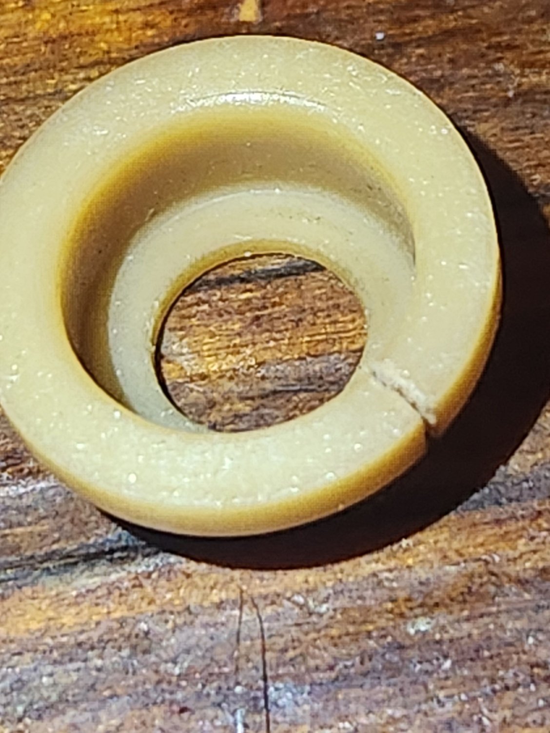

Fuel pump was cooked!

Originally Posted by LeX2K
You've decided the fuel pump is bad without any testing that's potentially setting yourself up for failure. But if you're convinced then fire the parts canon you might get lucky.
Its running amazing. Has more power at just about all speeds. This retainer was split on the old pump also. Its fixed!
Old Dec 17, 2025 | 11:05 AM
Posts: 25,992
Likes: 4,312
Thanks for the update what happened to that pump? Looks like someone tossed it out of a moving car then put it back in service.
I have no clue. It was not an original part. Someone had cut the carpet for access. Made it easier for me. It was also a Denso
This happened to me, car (1989 Camry) would take forever to start when the engine was warm someone had replaced the fuel pump with aftermarket junk. Original fuel pump for your car is $300+.
Its extremely easy to replace so ill put 3 $100.00 denso pumps in before the Delphi $300.00.
I have had good luck with denso parts in the past. I dont drive much either. It will probably be the last pump it needs anyway.
