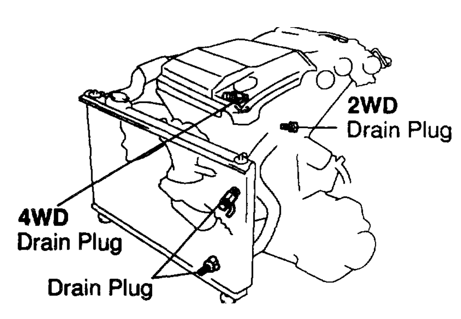

My son and I replaced the Radiator about 2 weeks ago and it took a good bit longer than it should have. (Having my 6 year old grandson "helping" may have a little bit to do with that.) Anyway, we drained the old radiator but not the block. So the next morning, before I put new coolant in, I thought I'd drain everything. The lower block drain was pretty easy to get to but that upper one is a dog. I never could get a wrench to stay on while I turned it and eventually gave up without draining the upper. I know it should have been done when the radiator was out but it wasn't.
I'm not planning on going back and redoing everything but I'm curious as to how you drain the upper block if you don't have to remove the radiator.
Feel free to suggest something else to BMS52.
