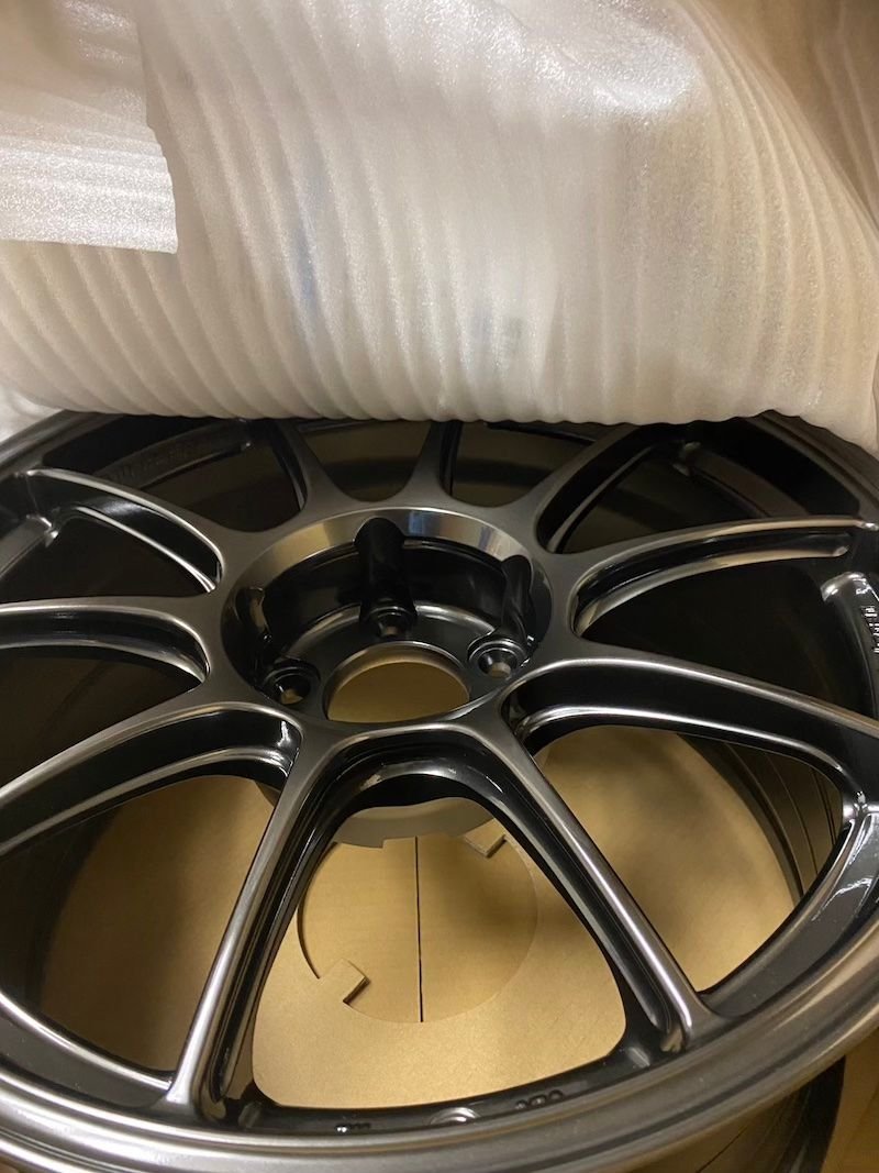

These are Gunmetal grey. I have the hardest time trying to capture wheel color in this shop sometimes. Here's a picture in the box. I would probably run a 275/40 front and maybe 285-295/35 rear tire on these. That depends on the tire and the use for the vehicle though.
