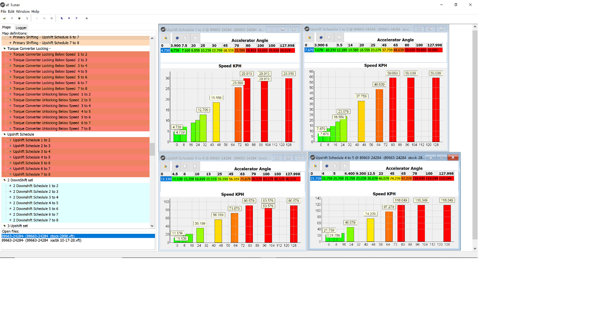

There are plenty of cool things in the software still. You can mess with the transmission and change the shift points, torque converter lock, how fast the shifts are. Here is an example of what it looks like based on accelerator angle.

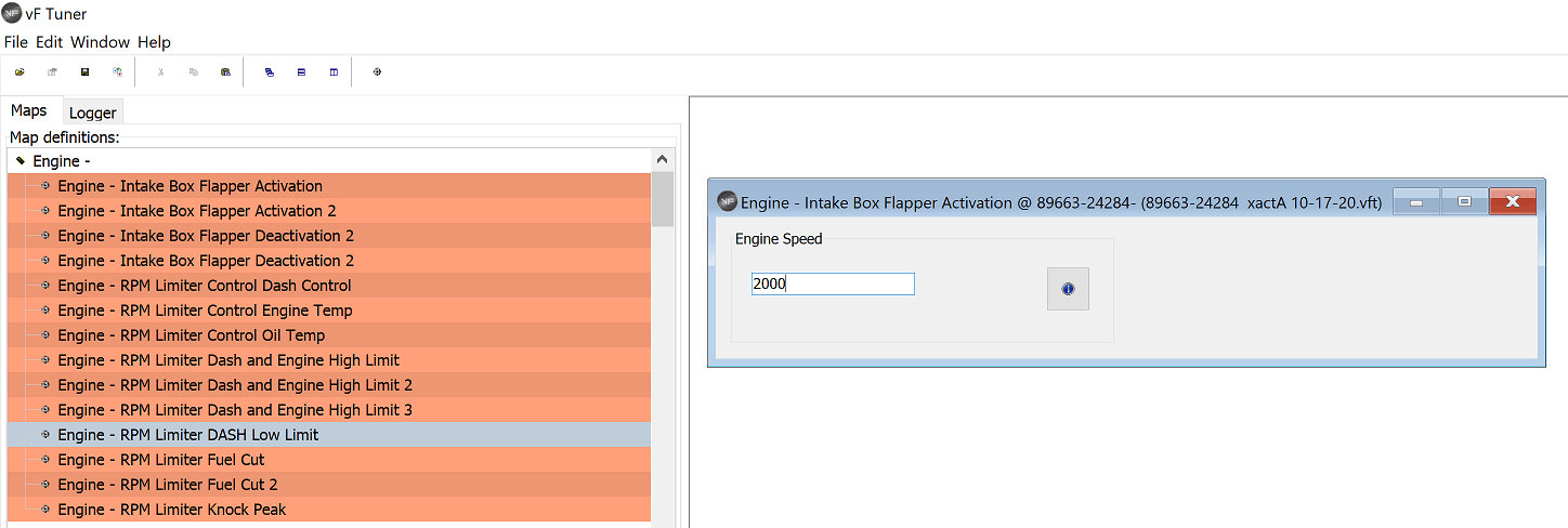

So one thing that I thought about was leaving that secondary intake open. It has been discussed before in this forum plenty of times. So I asked my tuner lets see what happens when we unplug vacuum line. Well, that caused a check engine light. Then we found out that in the software there is actually a parameter you can change to open the intake. We decided to try opening it at 2000 rpm on his tune. Here are the results of requesting the flap to open earlier. These two dyno runs were done back to back within 5 minutes of each other. Flap closed (red) flap opened(yellow). These dynos were done on a KCLV of 17.8 under 4k rpm and 17 above 4k rpm in 5th gear. (was easily able to get kclv back up to 20s after driving around). Unfortunately we ran out of time and he had another customer waiting. That was the last run of the day and we did not get a chance to make improvements to the tune with the intake opening earlier.

So your back to back dyno is telling that if you open the flap at 2000 rpm, it gained you low end torque compared to when it opened at 3600 rpm in OEM setting? That is interesting.

Yup seems to be the case on the custom tune. Also, if I remember correctly, when we logged the absolute throttle, the throttle does not open completely, until that flap is opened up. In his tune he did add more fuel earlier if I remember correctly. maybe the combination of the throttle fully opening sooner and more fueling did the trick

OK thanks. That makes sense that there is a custom tune with it since the torque on OEM tune feels so much better with the flap closed below 3600 rpm. Looking forward to more results.

So did the car pick up Torque but then lost HP?

Yup seems like the case. After we changed when the flap opened we made no changes to the tune, so i hope with some adjustment the HP would be higher. It's A LOT more fun driving around town with the flap opening up earlier but one downside is that cruising on the highway my rpms were around 2k rpm. The the tiniest throttle would make that loud induction noise. May just change it to 2200 or 2300 rpm instead for highway cruising. Whenever I get the tune adjust I think I will continue going forward with the flap opening up earlier and share the end results
