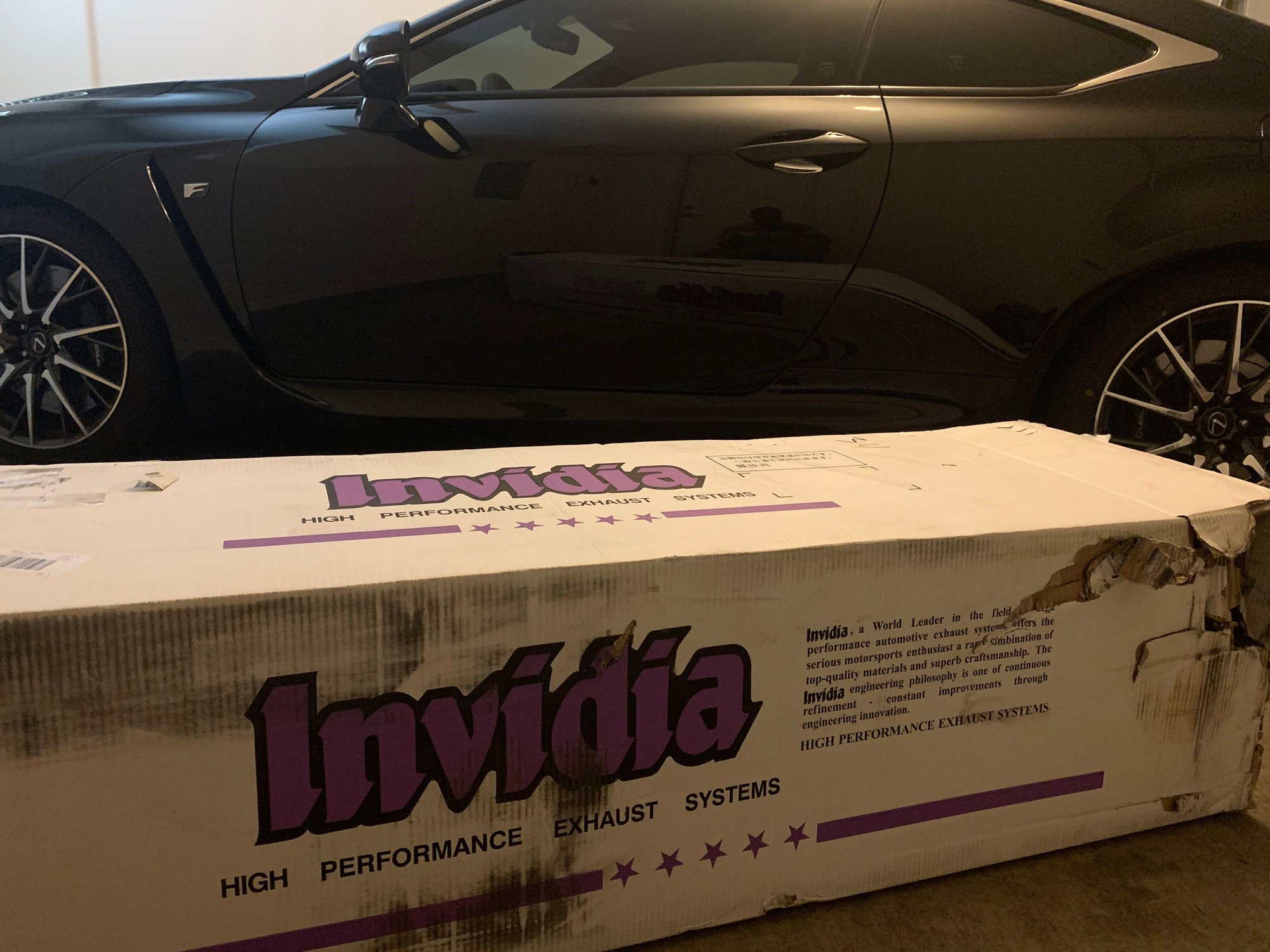

Just got the exhaust delivered. Will put it on this friday. Im Excited to hear how it sounds. Might just drive around all day. Probably will get the dyno done next week saturday.
In regards to my dyno run, do you guys think the spark plugs would have an effect on why my power drops off before 7100? Im at around 53k miles and haven't done the spark plug change yet.

I love the sound of my Invidia exhaust and your Invidia box is in better shape than mine was when it was delivered!
I also really like the look of that mij intake. What filter will you be using? I'll be interested in the gains you see!

I went with the afe magnum flow dry filter. I’ll share the dyno graph as soon as i get it. Now i’m thinking of doing the dyno this week instead of waiting until next week. I don’t think i can wait that long haha
