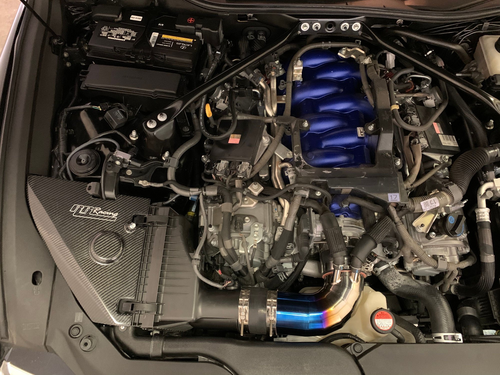

To anyone who said thank you, it was my pleasure. Glad i could be helpful. I paid under a thousand for the exhaust, so i feel like i got my moneys worth.
Also, i decided to try and tackle the filter, intake and heat shield. Going to wash the car then take it for a drive to make sure i didn't mess something up.

Looks beautiful. How do you like the intake? Does it generate additional noise or for aesthetic only?
didnt notice much noise different yet. But that could be because my exhaust seems to be louder in the middle of the car. Shortly after i popped a check engine light P0420. So i hope its just the exhaust and not some install error from the intake tube.
Hell yeah! Tons more smiles and thumbs up from people
As I mentioned before, the exhaust should not pop a CEL, if the installation does not have an exhaust leak and the O2 sensor has been connected correctly. That seems to be a primary cats error message. I have never had CEL in all of 2 years on my Invidia CB exhaust. I would recommend checking your installation again. Make sure there is no leak happening and the O2 sensor is connected correctly. Get help from an exhaust specialist if you need to have it checked.
I am also strongly considering getting the Takeda full intake as it replaces both the OEM tube with a resonator-free metal tube and the screen filter with a big conical filter while still retaining the sealed OEM box (which is important to me).
i’ll take it back to the shop that did the install let them
figure it out. Silly question, just being paranoid but the new intake tube wouldn't be able to cause a cats error, would it? Just trying to make sure its just a coincidence that the same day i installed the tube, i get a cel.
No, an intake would not cause a cat error message. The cat efficiency error you are getting is coming from the primary cats when you replaced the exhaust. Either the gaskets are not sealing the joint tightly/correctly or your O2 sensor might not be connected properly or might have some damage somehow while the installer was trying to pry it out. It is difficult to take out and requires some twisting etc. to take out.
