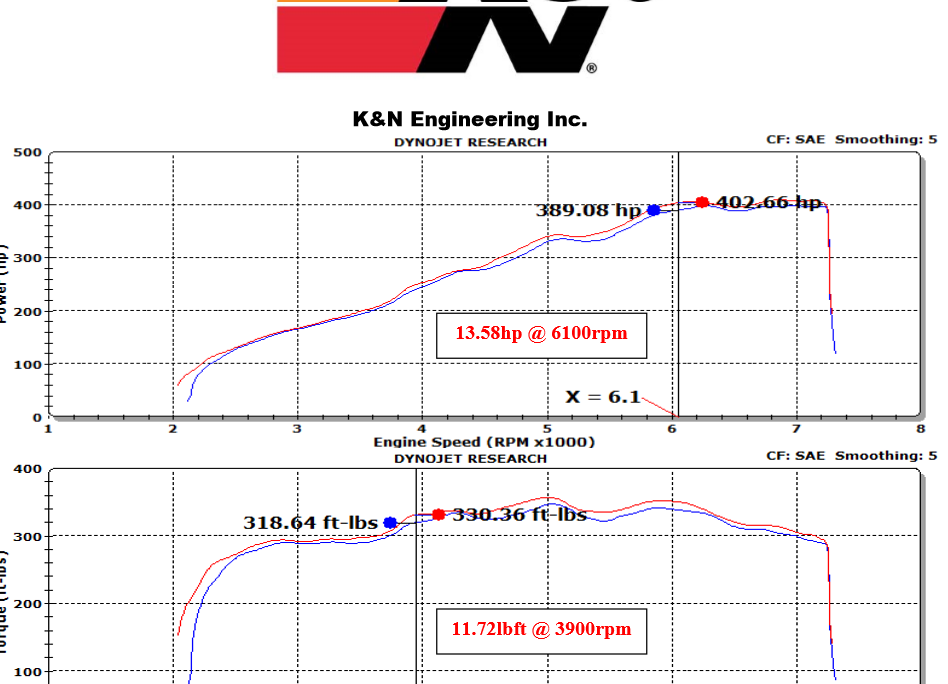

That is not that simple and not really relevant to the case of the OP as he just cares about before/after.
This dyno is an anomaly. Lexus officially put the power at 7100 rpm (compared 416HP@6600 rpm for ISF). So, best acceleration in real life comes staying close to the highest peaks past the cross over point between HP and torque exists (5252 rpm), which is between 6000 rpm and ~7400 rpm or so. I will spare the details when it comes to multiplication of torque through gears as rpms climb since dynos are done with 1:1 gear (5th). The engine makes 95 HP/Liter of displacement and needs revs to accelerate as fast as possible as opposed to muscle car V8s that have huge 6.2 liter displacements to hit their peaks below 6000 rpm (Corvette engine, for example).
Here is SAE corrected dyno by K&N as well as AFE and peak power surges up till 6200 rpm and then slightly increases till around 7100 rpm or 7200 rpm and then it continues to stay flat till around 7400 rpm or so. The torque curve is flat all across the rev range and even near the rev cut off it is making 90% of its peak torque.

Interesting. I guess it was an anomaly. I would still suppose that shifting at the absolute redline would hurt acceleration times, like shifting at 6500-6800 RPM is probably your best option. I guess my assessment was wrong. Thank you for the correction!

There is a very simple explanation of why OP's RCF is hitting the peak much earlier. Just the fact that the rear wheels/tires are removed. That is over 100 lbs of rotational mass being taken off the rear axle. With so much less mass (and corresponding inertia) to spin, the engine has to work less hard (conversely, rely more on torque) allowing it to reach the peak HP earlier.
Sikky used Dynapack as well and the dyno curve looks identical to what OP has. It is hitting peak at 6100 rpm as well.

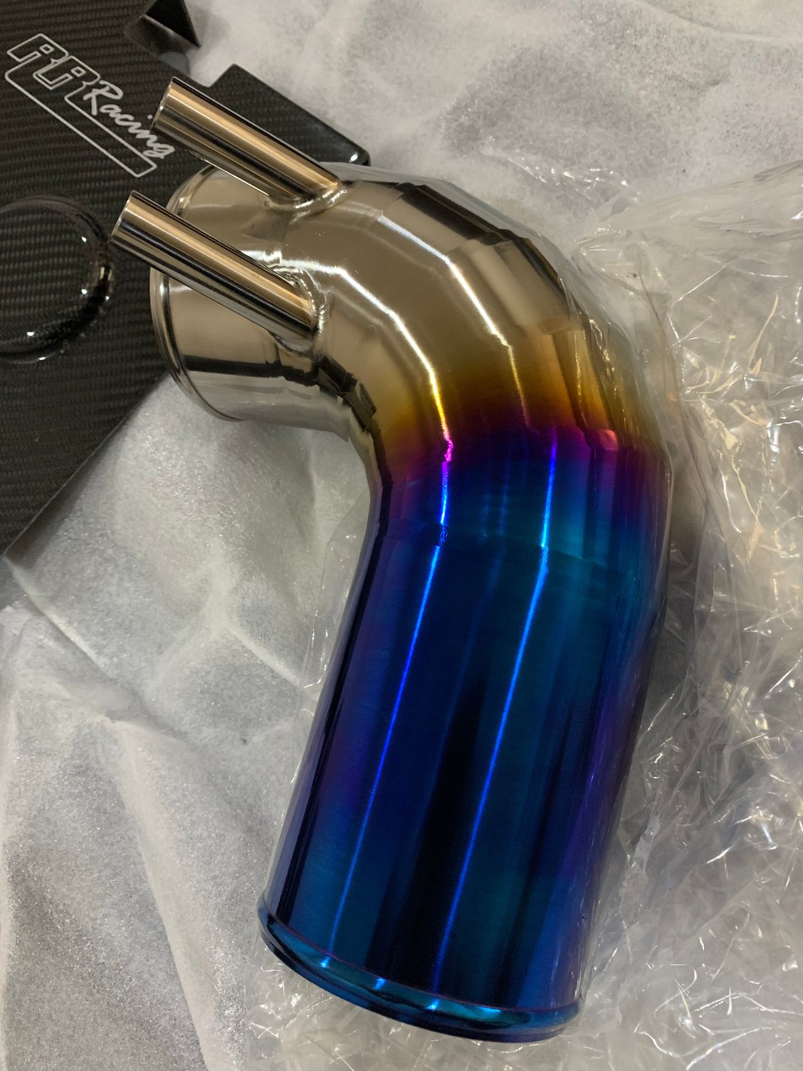

Got the exhaust installed yesterday and drove around for 3 hours straight. Holy crap, the exhaust sounds amazing!!! I had a Good amount of people giving me a thumbs up or driving up to me to hear the exhaust. The perfect sound. Not too loud at all. Sounds nice and aggressive in the low RPM with moderate acceleration, especially at 2-4k. The exhaust does not get loud unless you want it to. The sound when the gears change is also amazing. “Cold start” (80 degree) was not aggressive enough to wake the neighbors. I have 0 regrets with this exhaust!! Oh and the other parts came in too.
