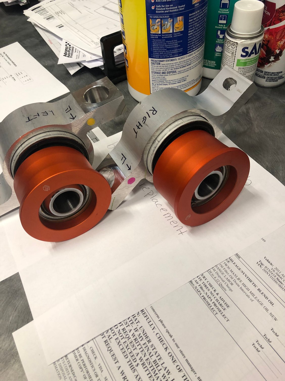

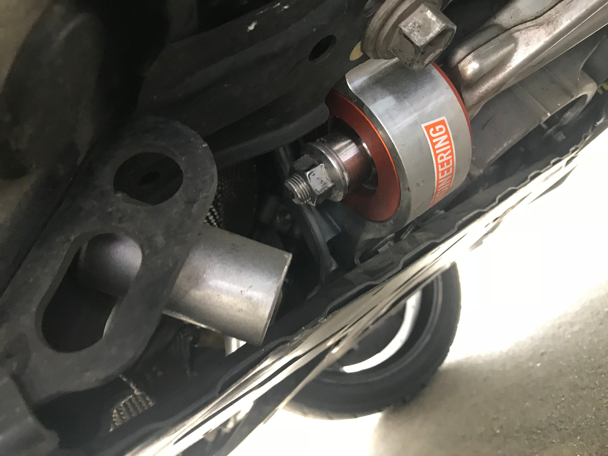

Beyond normal track prep like tires, fresh brake fluid, and possibly higher friction pads, the number one absolute must is swapping the front lower control arm bushings.
RR has good urethane ones that are a good compromise between road and track.
If you find yourself still eating front tires on the inside, I would recommend going to solid bushings. Figs engineering makes them. Or just get those to begin with. I don’t think they degrade the ride quality that much compare to the RR ones. I’ve had both.
Next mods should be handling related as the rcf has plenty of power imho.
1. Lighter rotors would give better front end steering response plus increase torque some.
2. If you find yourself chewing up front tires on the outside, you will need upper camber arms to increase camber.
3. Square set up wheels to help reduce understeer would be a big plus but a big investment since you’ll probably end up buying wheels and tires. This will save your front tires some too.

Originally Posted by Mingofish
.... I would recommend going to solid bushings. Figs engineering makes them. Or just get those to begin with. I don’t think they degrade the ride quality that much compare to the RR ones. I’ve had both.
Hi Mingofish. Clipped your message for where I need better understanding please.
Checked figs online store but no solid bushing for RCF unless I looked wrong. Interesting that the solid is still comfortable as urethane. How wit compare to OE?
And what lighter rotors you mean?
Thanks
The solid bushings are made to order. Call Figs and they’ll get you set up.
Two piece rotors like the Griodisc ones from RR or Racing brake ones that Figs sell. Both solid products.
Thanks
Try Endless for pads. You’ll like em.
Castro SRF fluid better than motul by a good bit.
