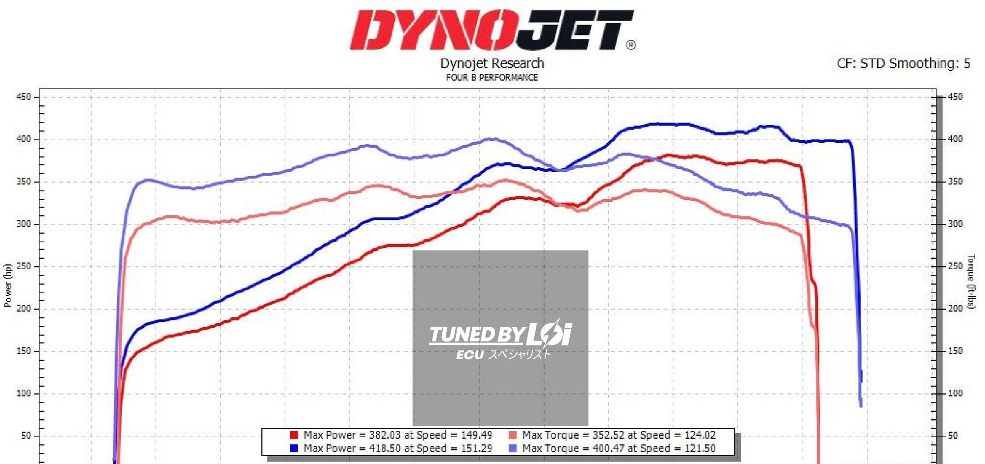

For another option, might take a look at Loi’s Instagram @tunedbyloi for examples of some of his work.
I just recently had my ‘21 dyno-tuned by him (everything stock for powertrain/intake/exhaust) with awesome results. Gains throughout the entire rev-range along with all the other drivability improvements. It feels like what the car should have been OEM.
This particular dyno did not have load control, so add 5-10% if you want a rough-range comparison to other DynoJets; although comparing sheets from different dynos is kind of silly...
Also, a small amount of e85 was added between the stock run and the tuned one listed here. This was because the Costco fuel I had at the time was not the happiest octane-wise (which is apparently fairly common due to add-pack differences) and the intention was to try to bring it up to other 91ACN fuels like Shell, etc.
This is 6th gear btw.
solid numbers for sure with just a tune and everything else stock.
